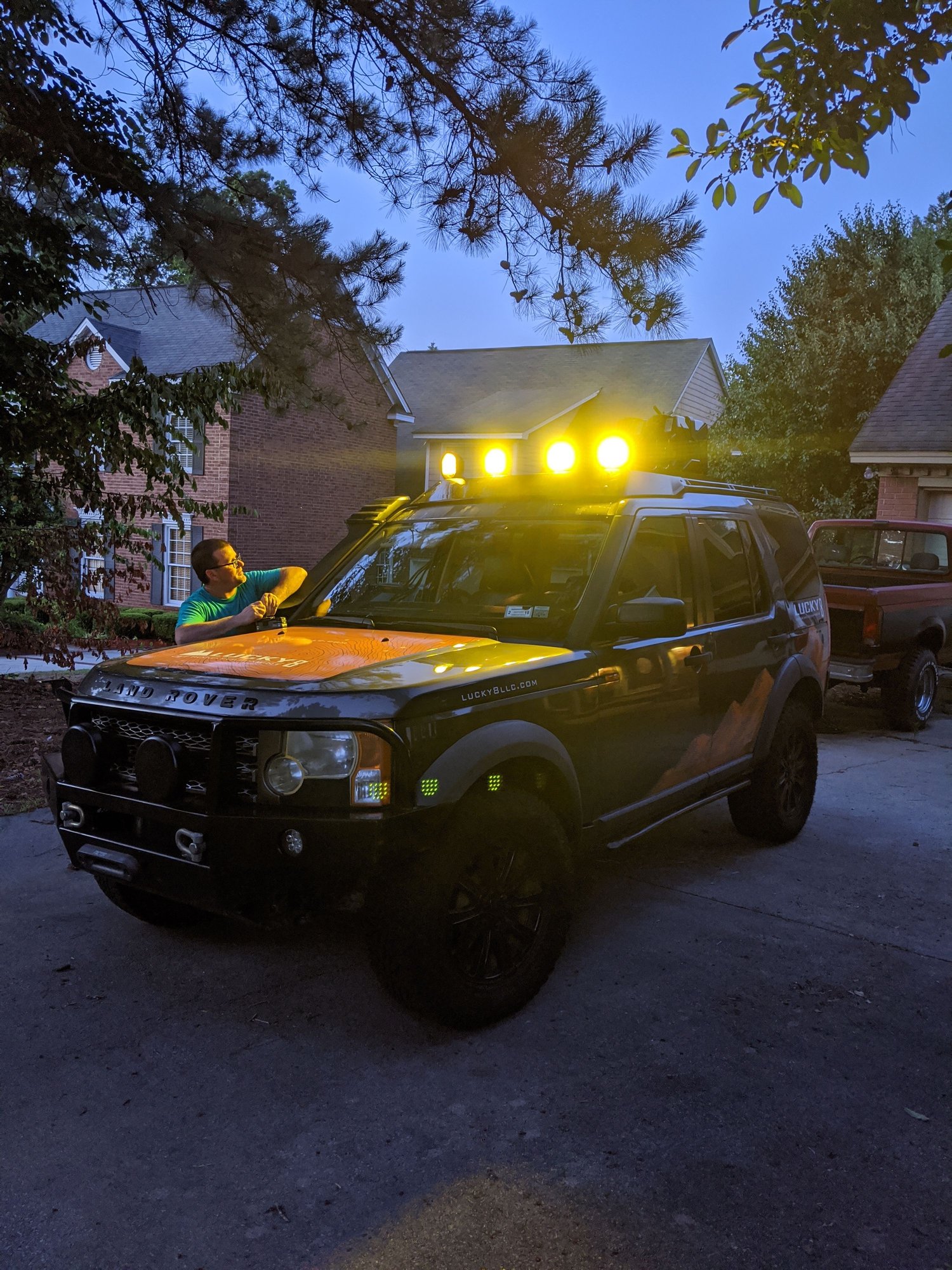

I found some time to do a little work and sorted out mounting for the new Hella FF500 LEDS. Did a test fire using a Milwaukee m12 cordless tool battery. The harnesses will get installed in the new LR3 so it will be a quick swap over with the rack.

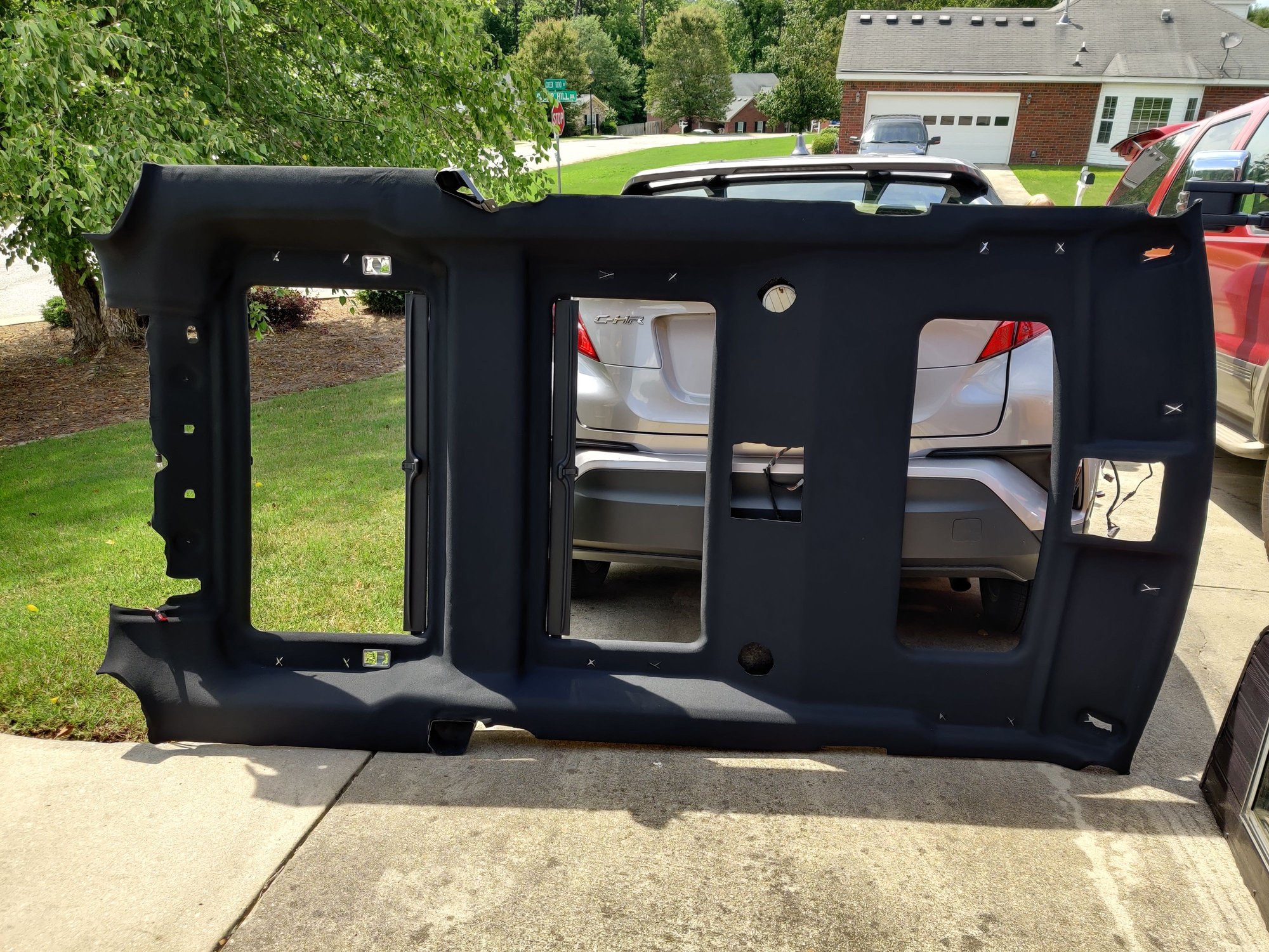

Picked up the refurbished headliner and sunvisors
