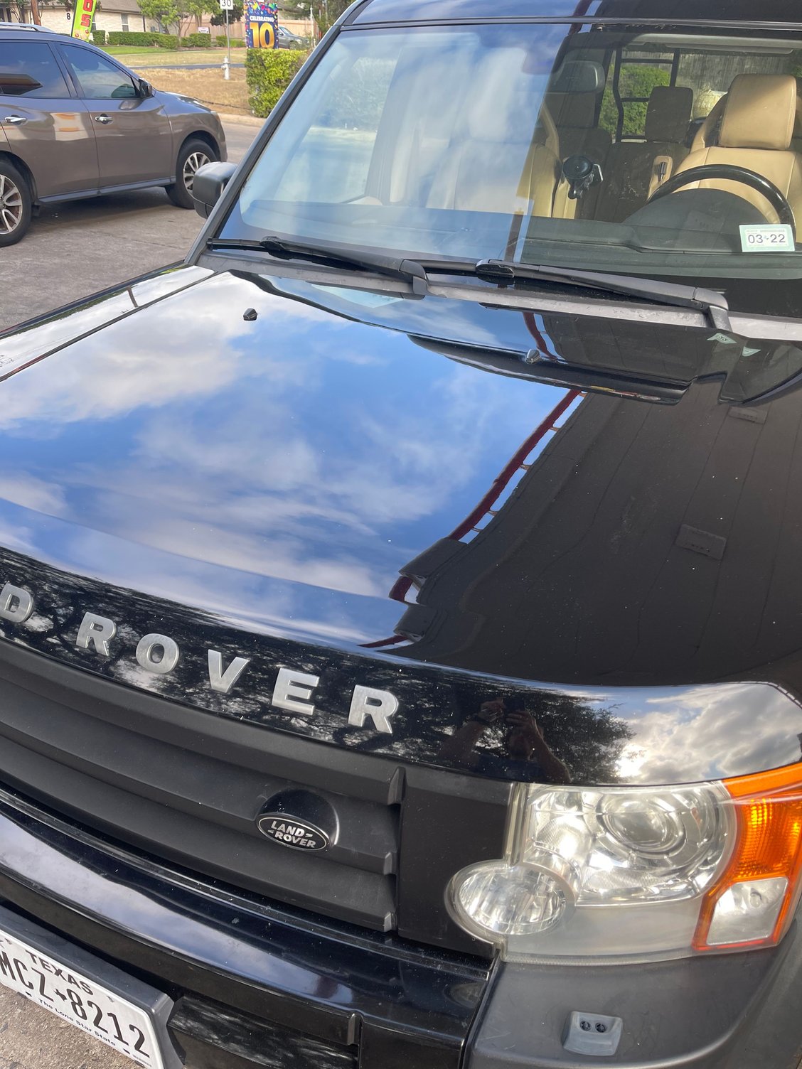

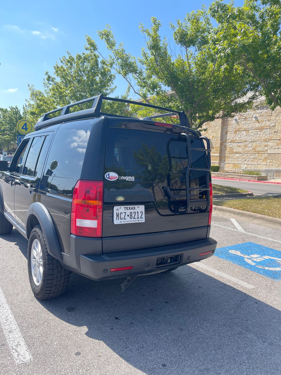

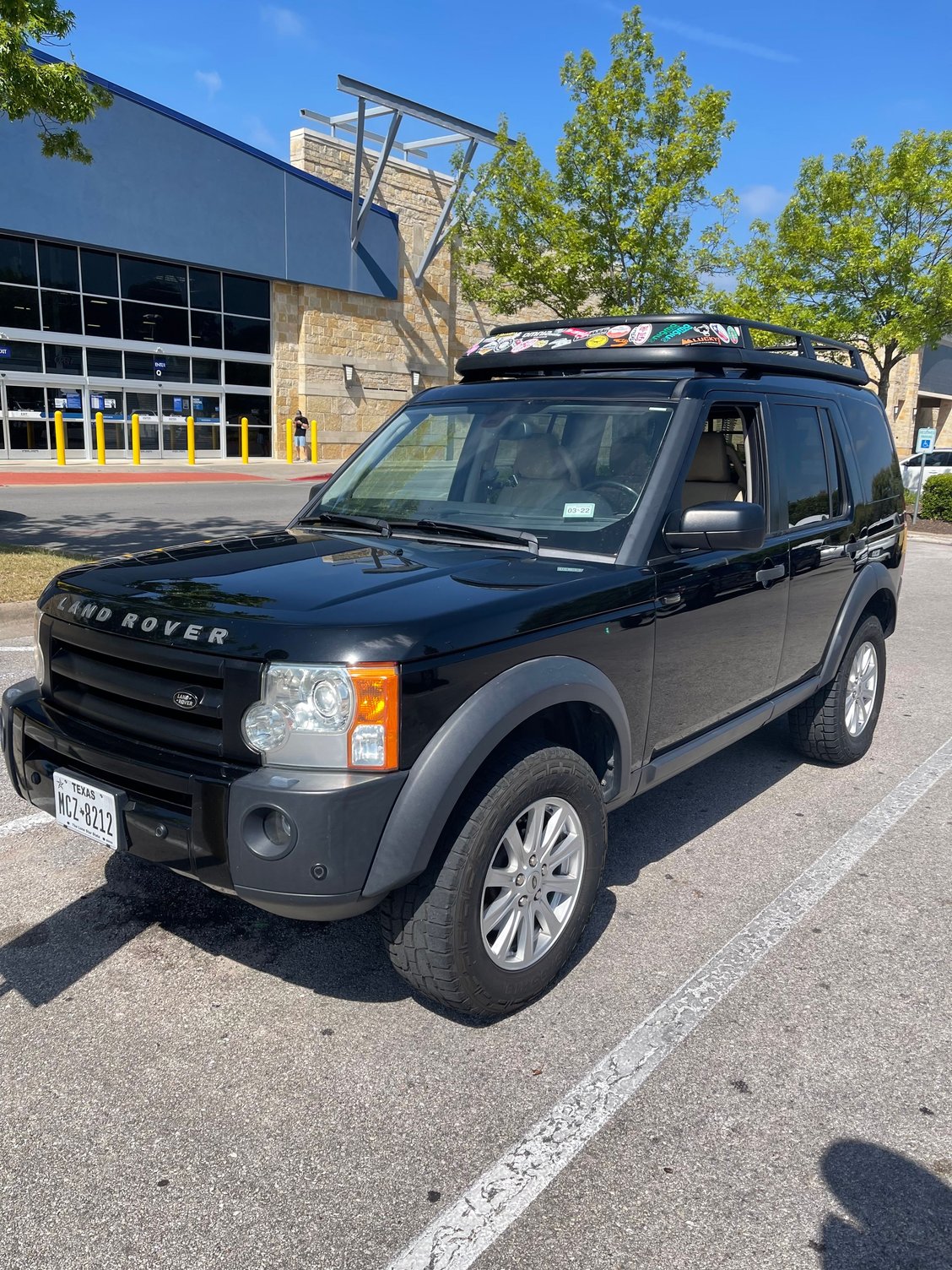

Wet sanded and buffed the hood and buffed the whole car in prep for a trip

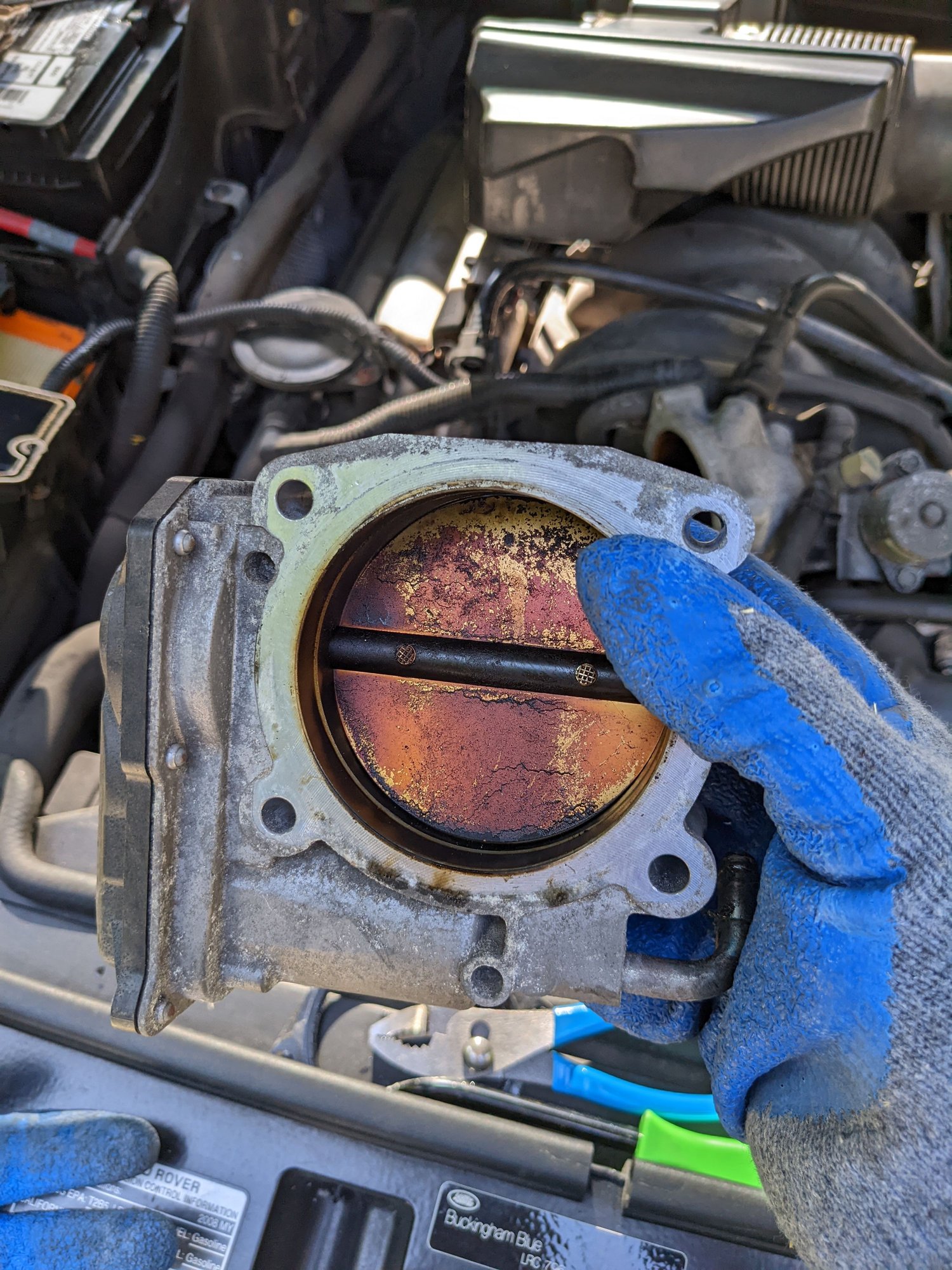

Cleaned the throttle body. Clearly a bit overdue...

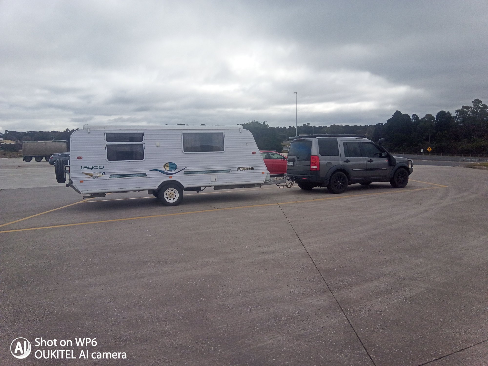

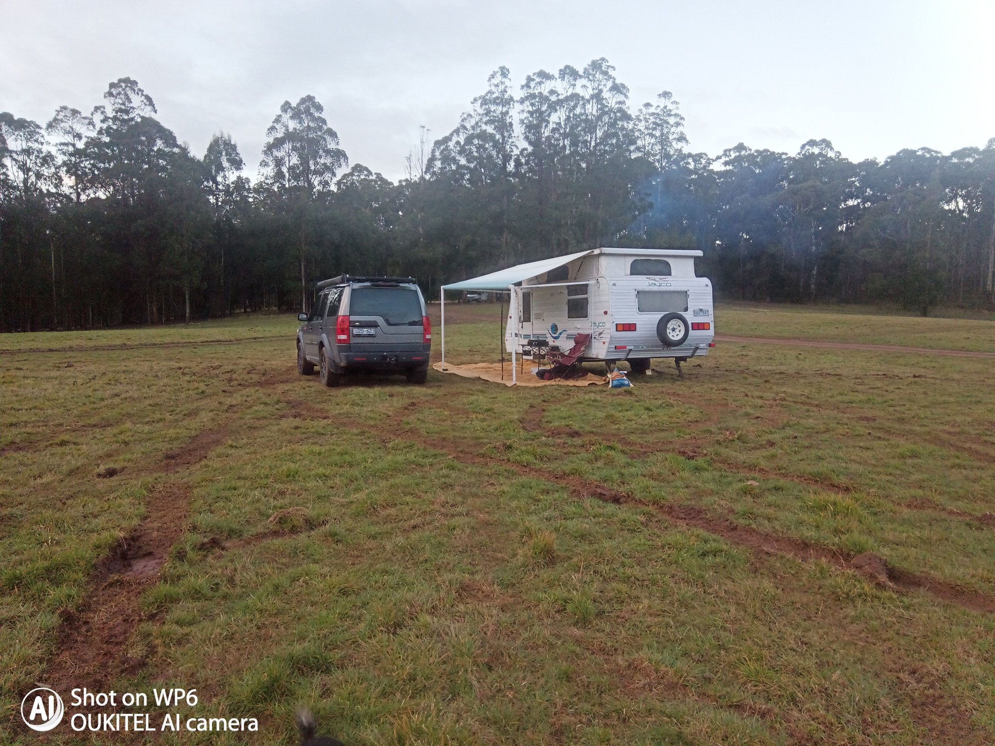

The weekend of the 6/7 of August was our annual winter camping weekend, i usually just take my swag but this year we took our caravan that we bought just before Easter.
Its only 17ft and fairly light at 1150kg and previous owner had fitted a drop axle so it has more ground clearance than stock with only 14" wheels and tyres, so much easier to setup and packup than our camper trailer was so this will get the wife out more often. I have a few things ready to ready like a diesel heater and 2 x 190w solar panels and 2 x 100ah AGM batteries so we should have plenty of power available.
The TDV6 barely felt the van on the back and happy to do 70mph up the long windy hills where my old 300TDI could barely crack 40 and still able to get 12.5L/100 klms (22mpg).
