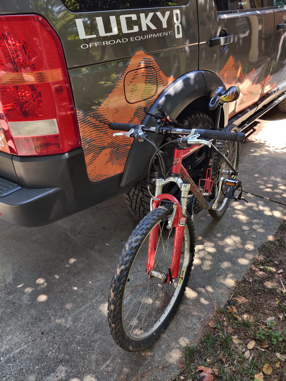

After that, I drove down to the bike shop and picked up my GT, with it's new used Duke XC front suspension fork installed.

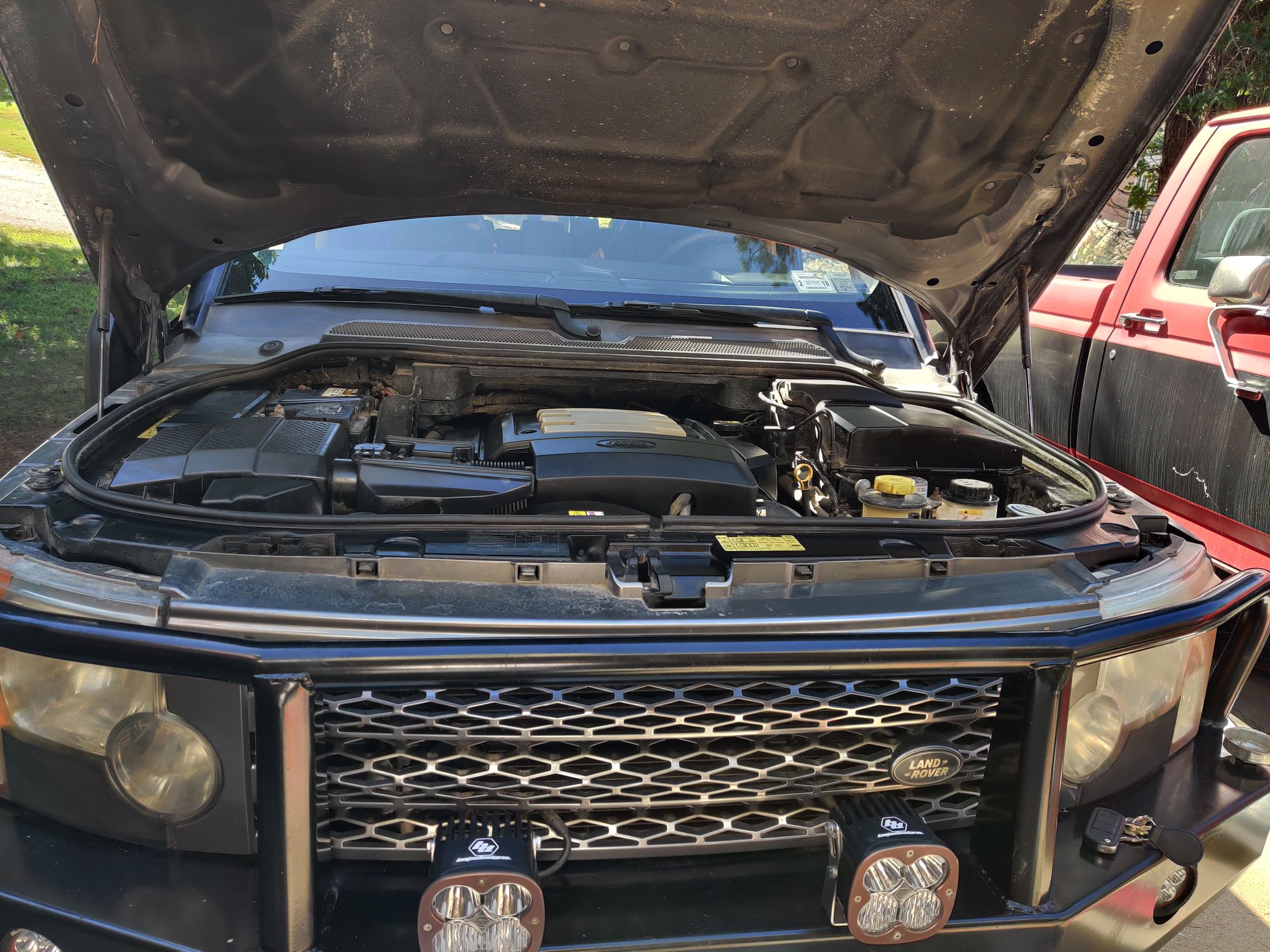

Once it was all together I started stripping the front of the truck. That mini soft shackle is so handy. I have had that in my trucks since 2015.

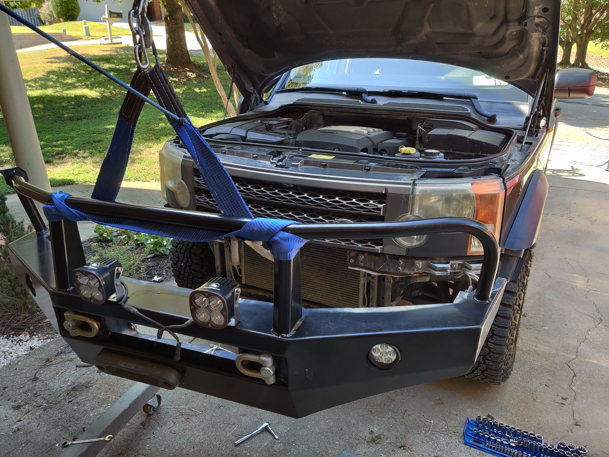

Bumper had to come off so I could install the winch and have clear access to the headlights. Engine hoist is the perfect tool for solo removal and installation. That Proud Rhino bumper is stout.

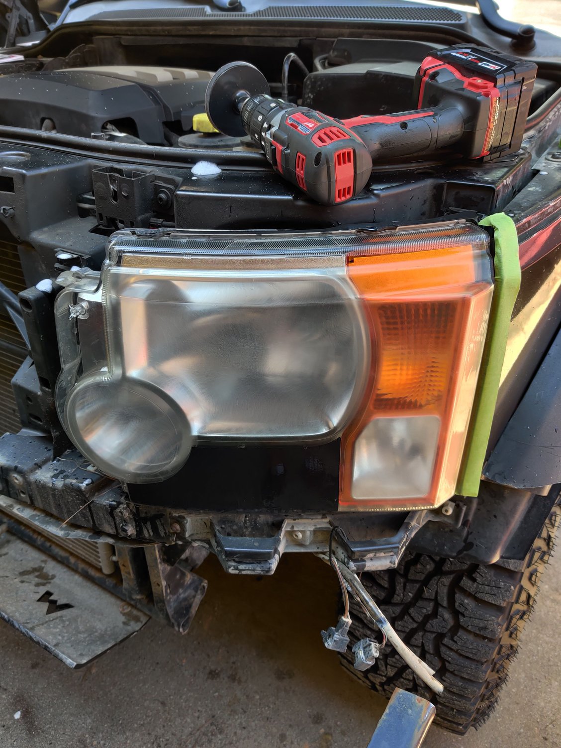

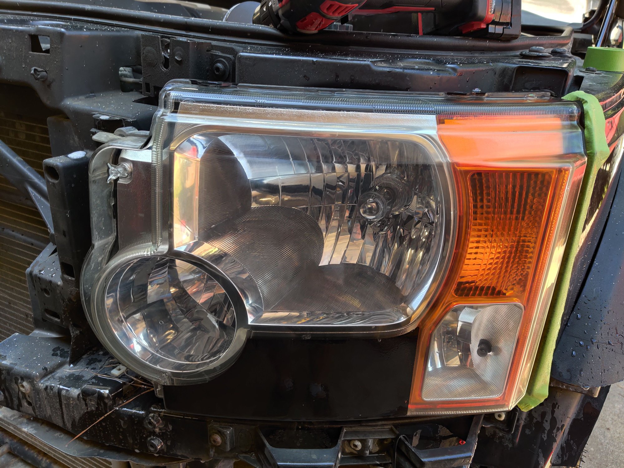

So I moved on to the headlights at this point until I was done I didn't realize how bad of shape they were in.
First step 500 grit
Second step 800 grit
Final Polish 3000 grit

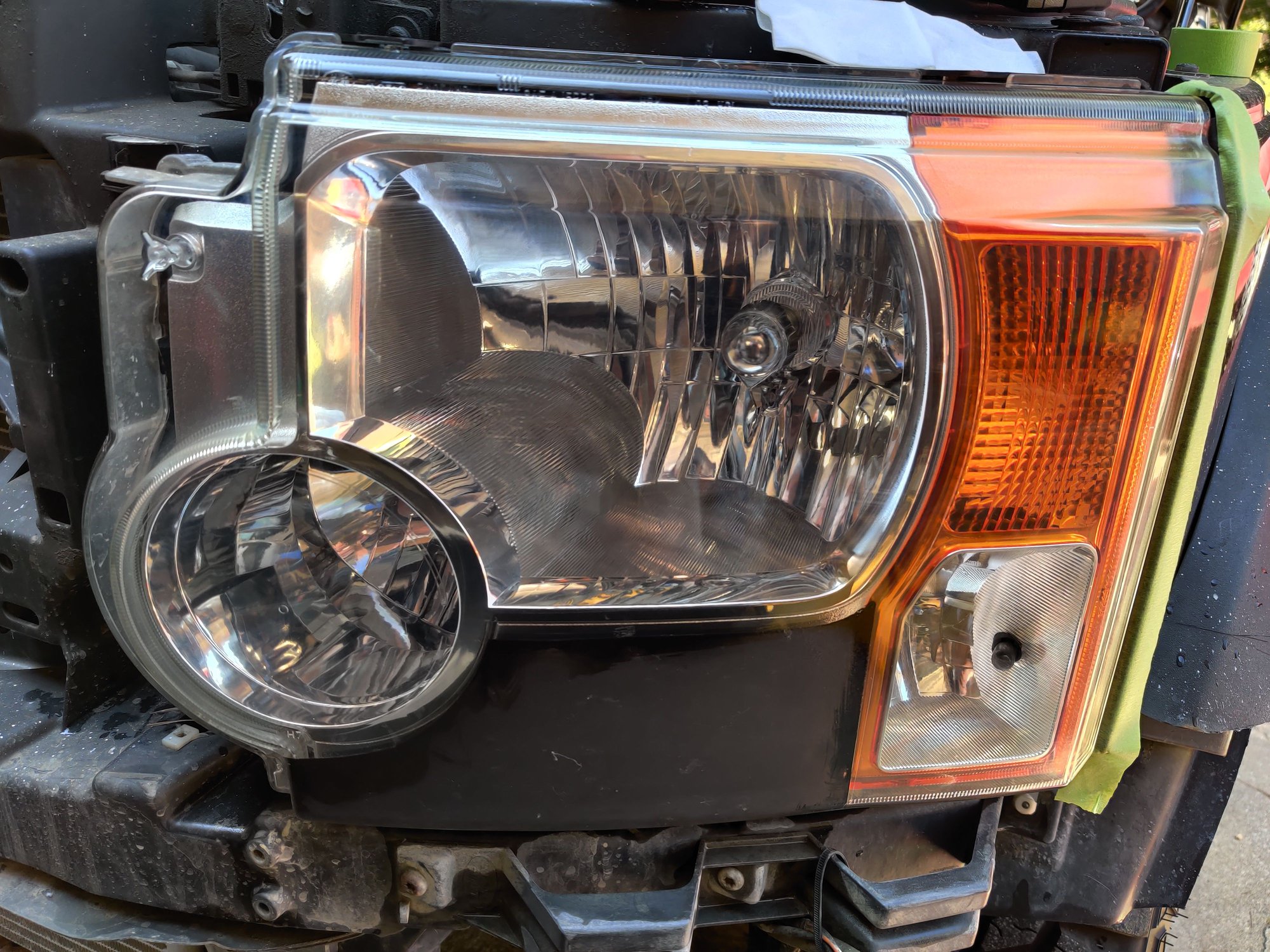

Final wipe on the headlights
Since I had it all torn down and I had a spare set of LED bulbs laying around for some reason. I went ahead and made a minor adjustment to the bulb clips and got them installed since it was apart anyways..
