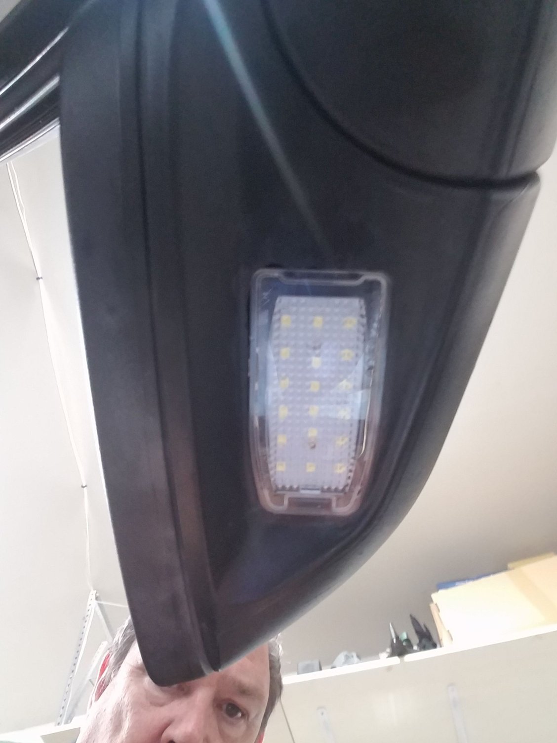

Could you post a jpg of the underside of the mirror showing the LEDs? I must admire your determination and also your success.
Here you go.
They say it is a direct replacement. I did see an outline under the mirror, but it was bigger than the LED, so that is why I measured. This is the second one. I was tired and the opening has a couple of .... OOPS moments, but I think a small dab of clear RTV will solve that issue.
Had to turn off the garage lights to admire my 4 1/2 hours of work. My helper spent most of the time stretched out in the middle row seats waiting to go for a ride.

Originally Posted by Rufflyer
Here you go.
Much appreciated - that looks like the under the door lights but LED rather than incandescent.
I have never looked at the factory mirror puddle lights - will have to start looking on the newer 3's or 4's.
