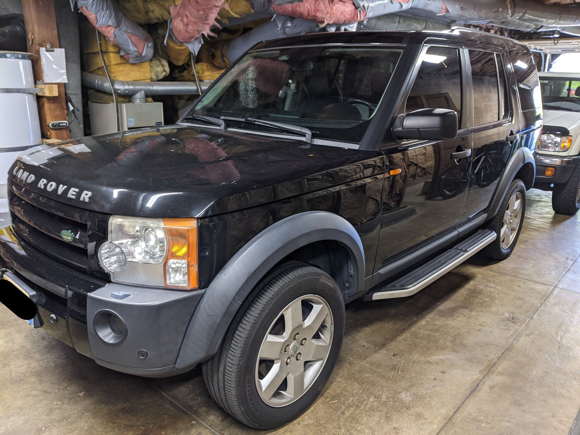

Installed side steps / running boards. I found a used set at a salvage yard on Thursday. I picked them up yesterday and cleaned them up last night. Today, I installed them.

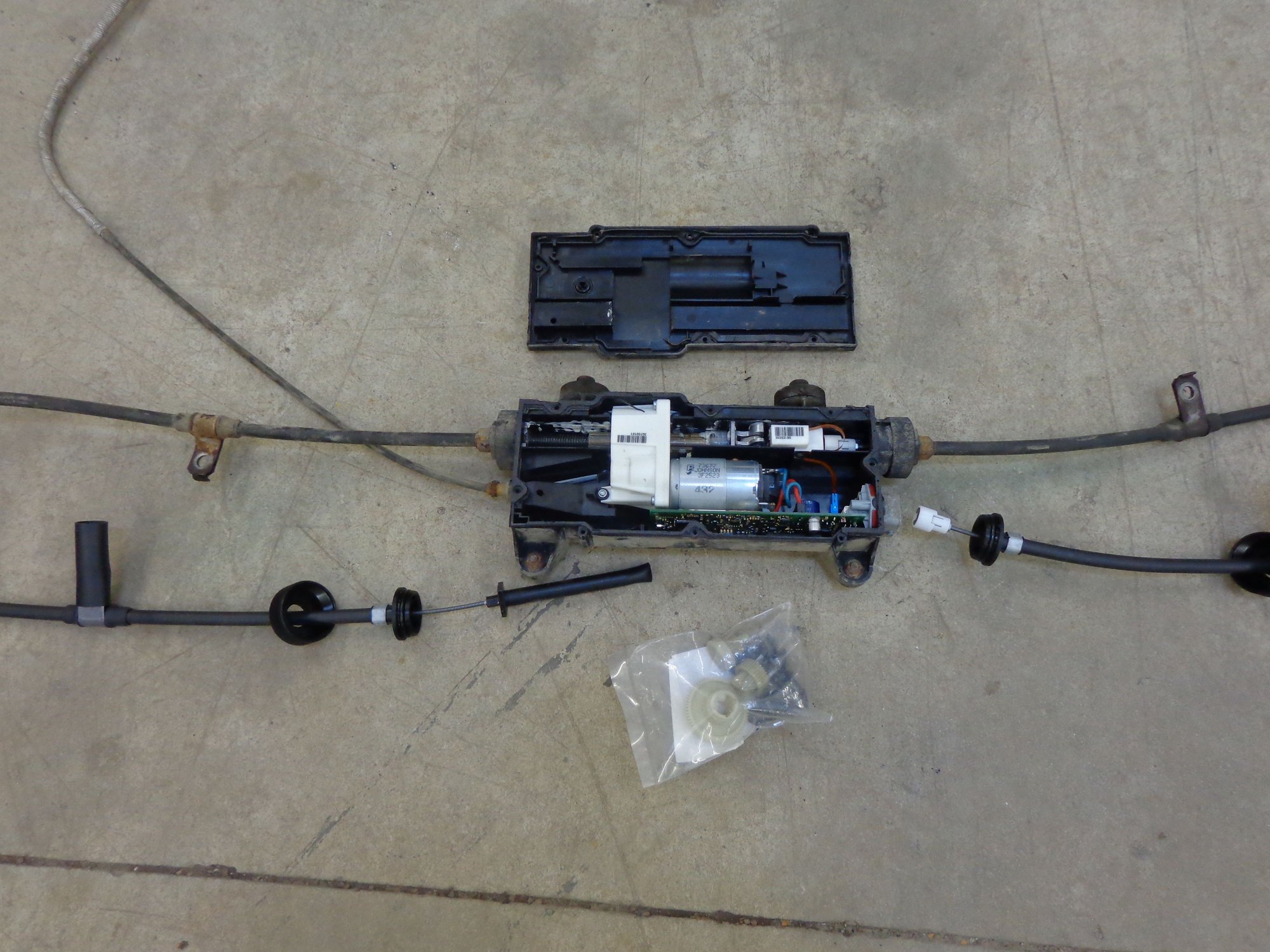

Started out by thinking it would be a good idea to get my ebrake working again on the LR3. Typical grinding noise coming from the ebrake module when applying the ebrake switch.

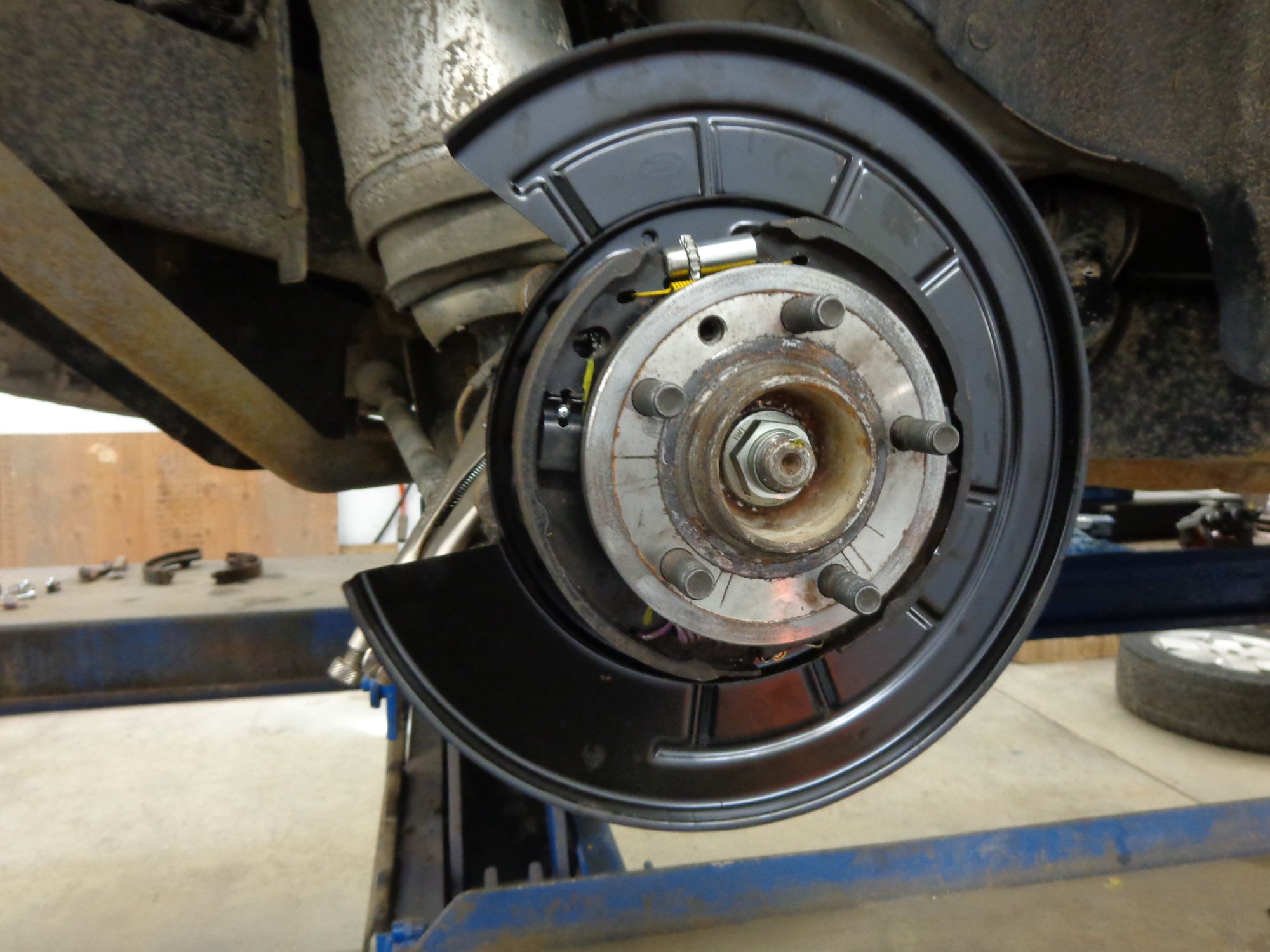

Remove rear wheels and find the backing plate is rusted out and the nuts holding the cables are split and can't be reused. To get the backing plate off you need to knock out (destroy) the rear wheel bearings, so will need to replace them as well. Checking the brakes and see that one rear caliper is seizing up, pads are worn considerable more on one side then the other.
So what did get replaced?
New gear set inside the ebrake module
New backing plates
New cables. The emergency release cable is still good, so don't need to replace it
New wheel bearings
New calipers, pads and rotors
Ebrake now working as it should
A quote I say recently: LAND ROVER-MAKING OWNERS INTO MECHANICS SINCE 1959
ebrake module on the floor with the new cables ready to go in
New gears going into the module
New backing plate in place, ebrake shoes on and getting ready to install the new rotors, pads and calipers.

Nice work, I have to service my e-brake also. I plan on new cables. But FYI you can buy the backing plates as two-part. I dont think LR produces them, maybe Dorman does but I have seen them available. With that said this is the opportunity to replace the rear bearing anyway, they are not easy. So no loss in getting it ALL done in one go. I have new knuckles that I will bench build then install along with all new control arms.
I did the upper and lower control arms along with the air suspension and air compressor a couple of years ago, so should be good for suspension and brakes for awhile-here's hoping anyway.
