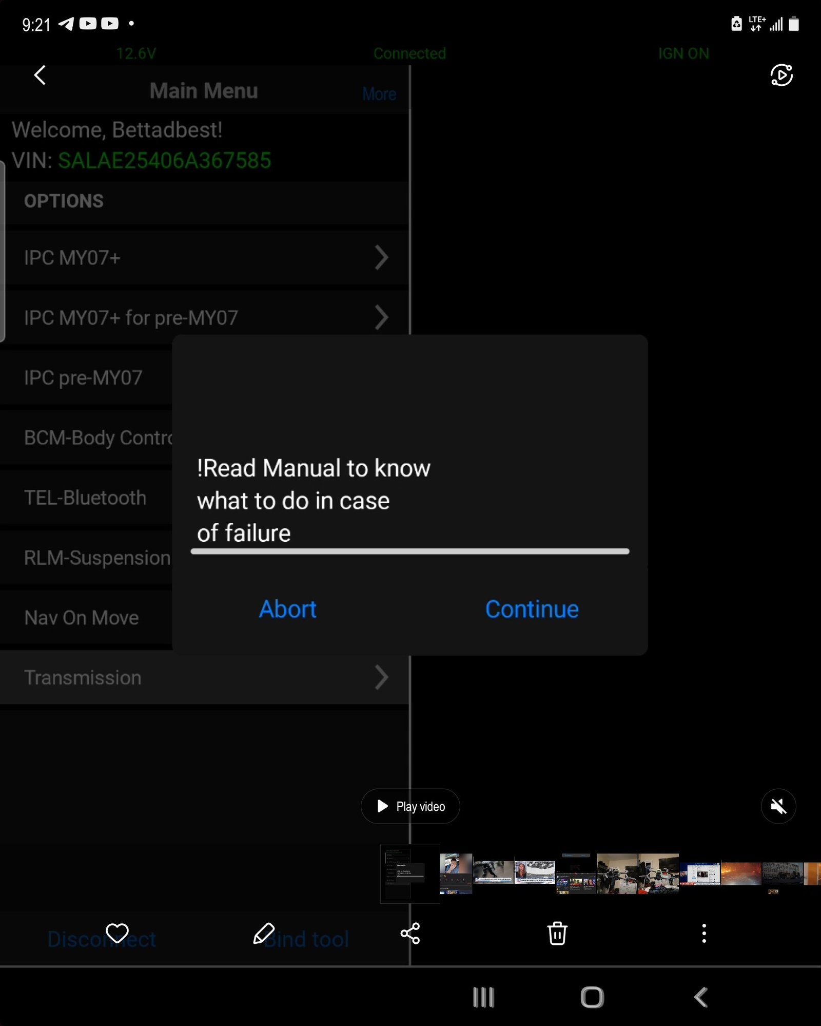

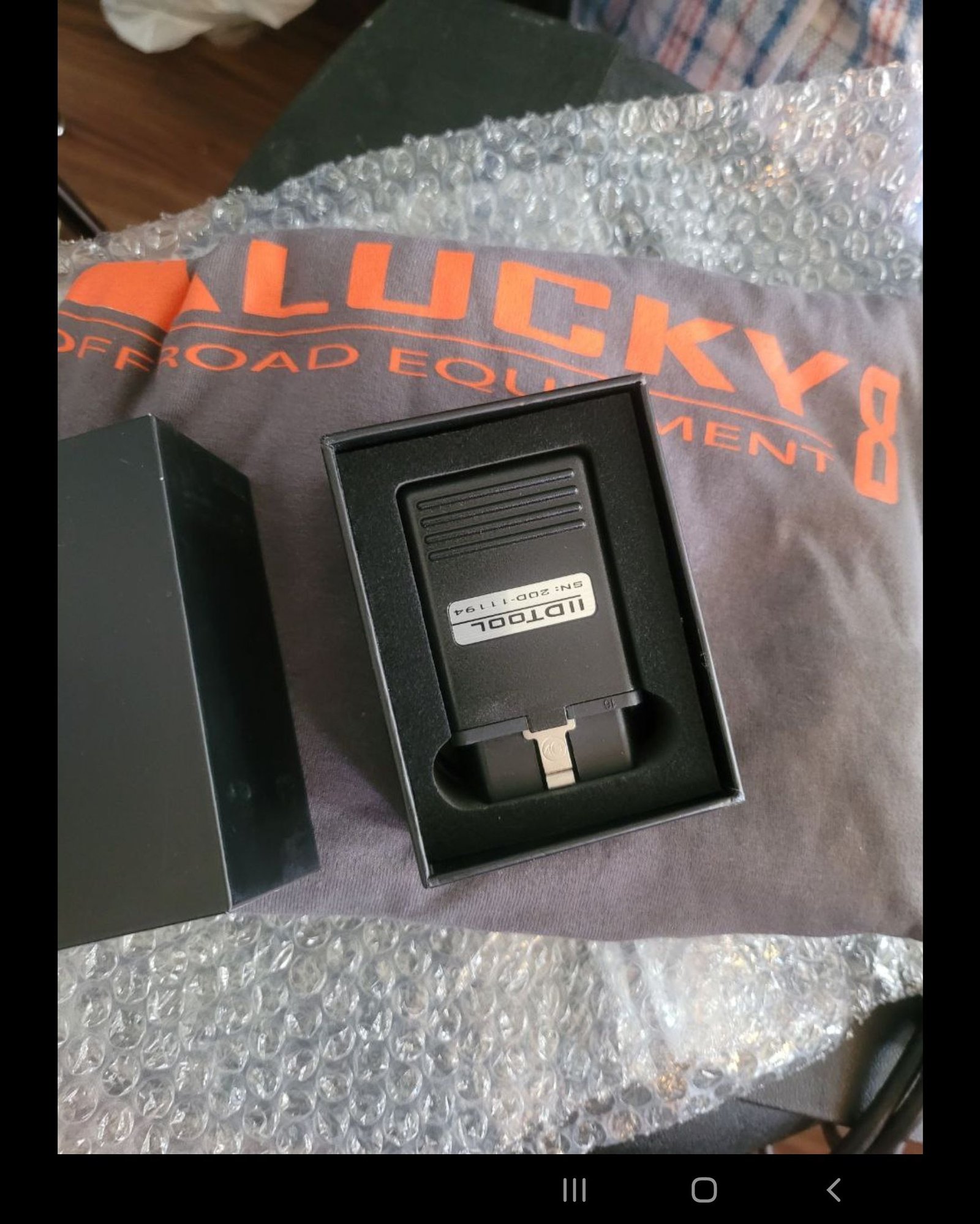

Default Happy day
Just got my gab iid tool very excited latter i will update my transmission Ecu

Default Transmission problem fixed
My California hesitation is gone after the update thanks god
