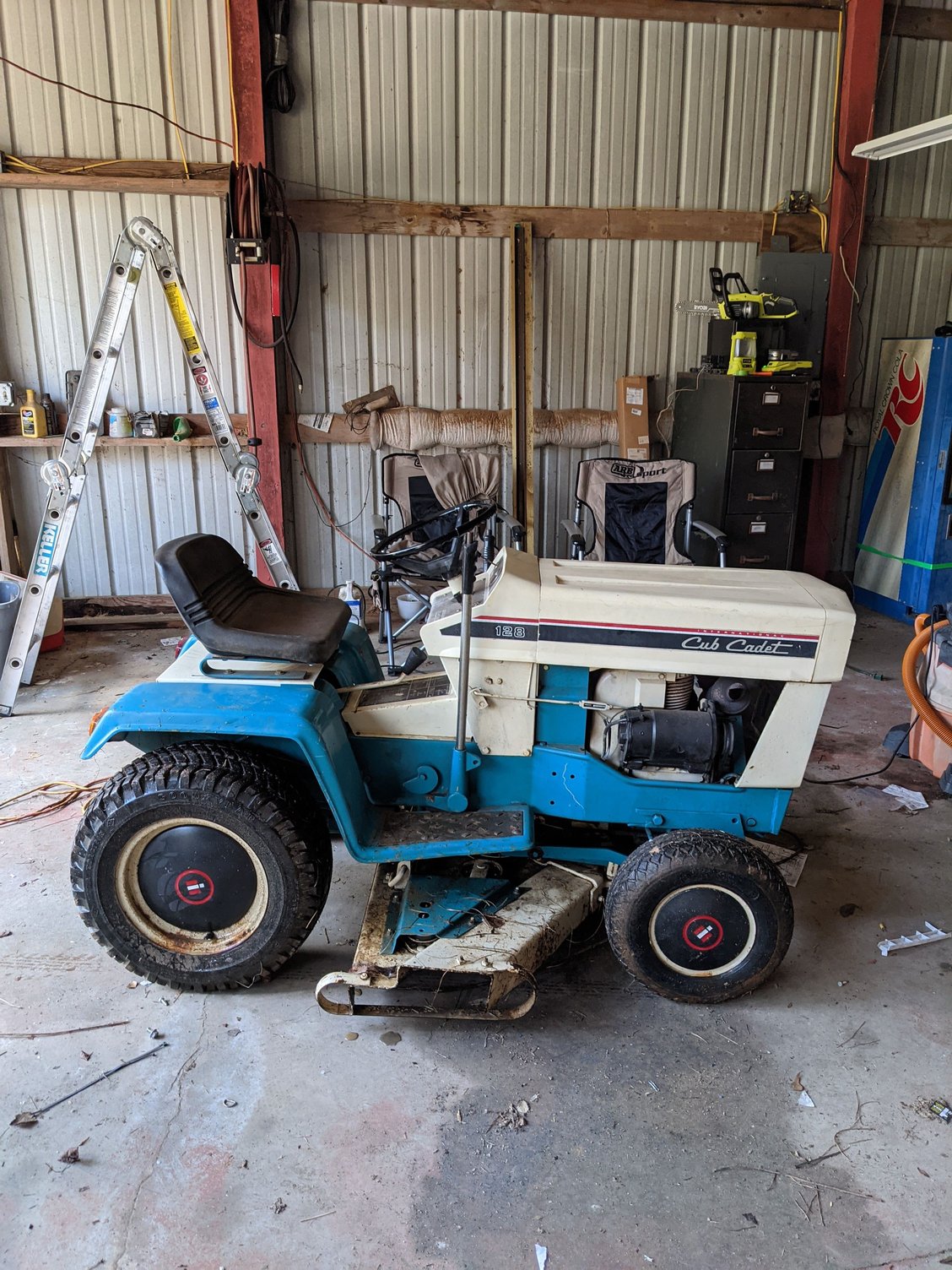

Time flies....
I took mine for a road trip today to pick up a new to me piece of equipment.
Cub Cadet 128 with the 50" deck. Should really fit the need.

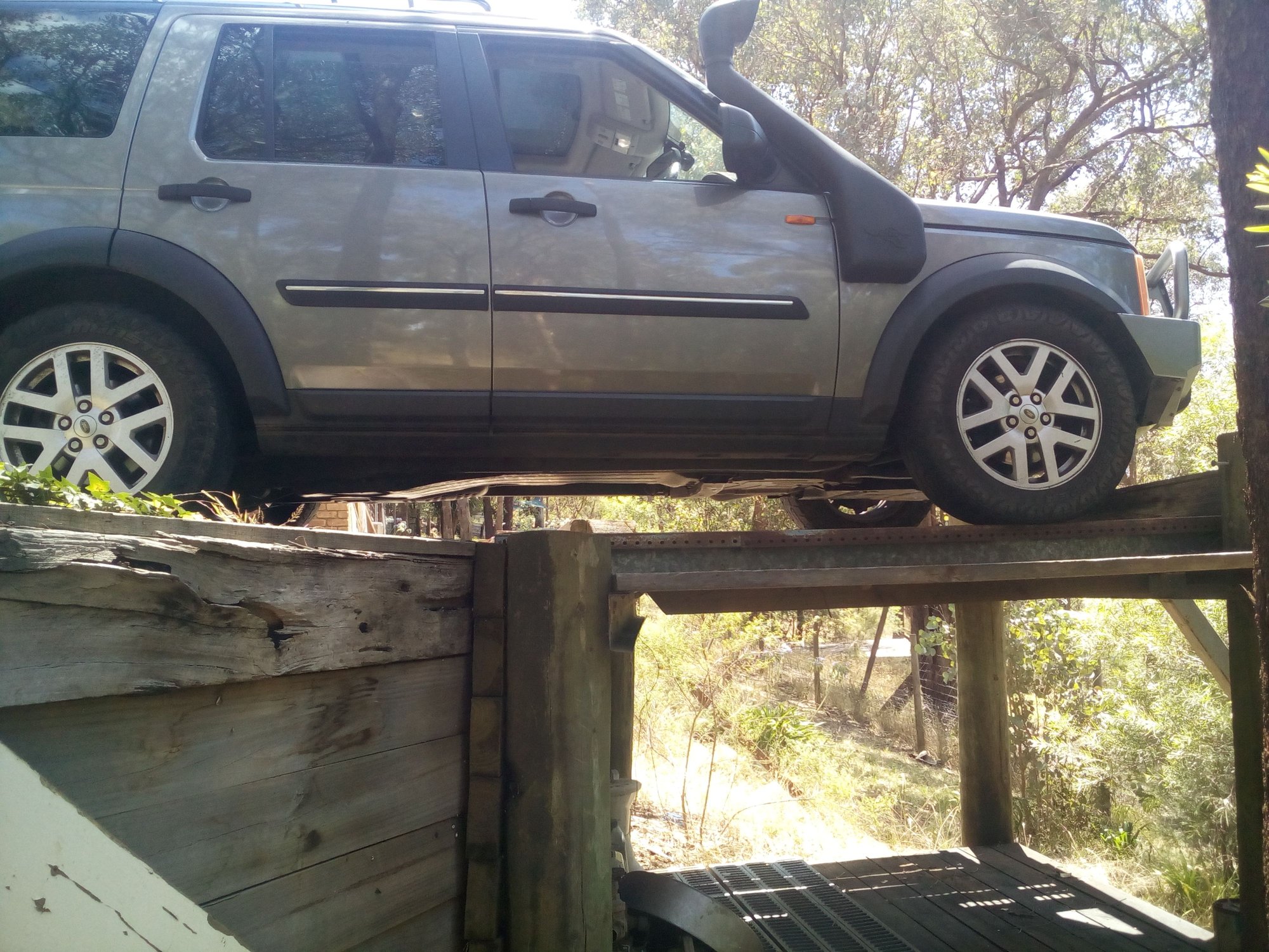

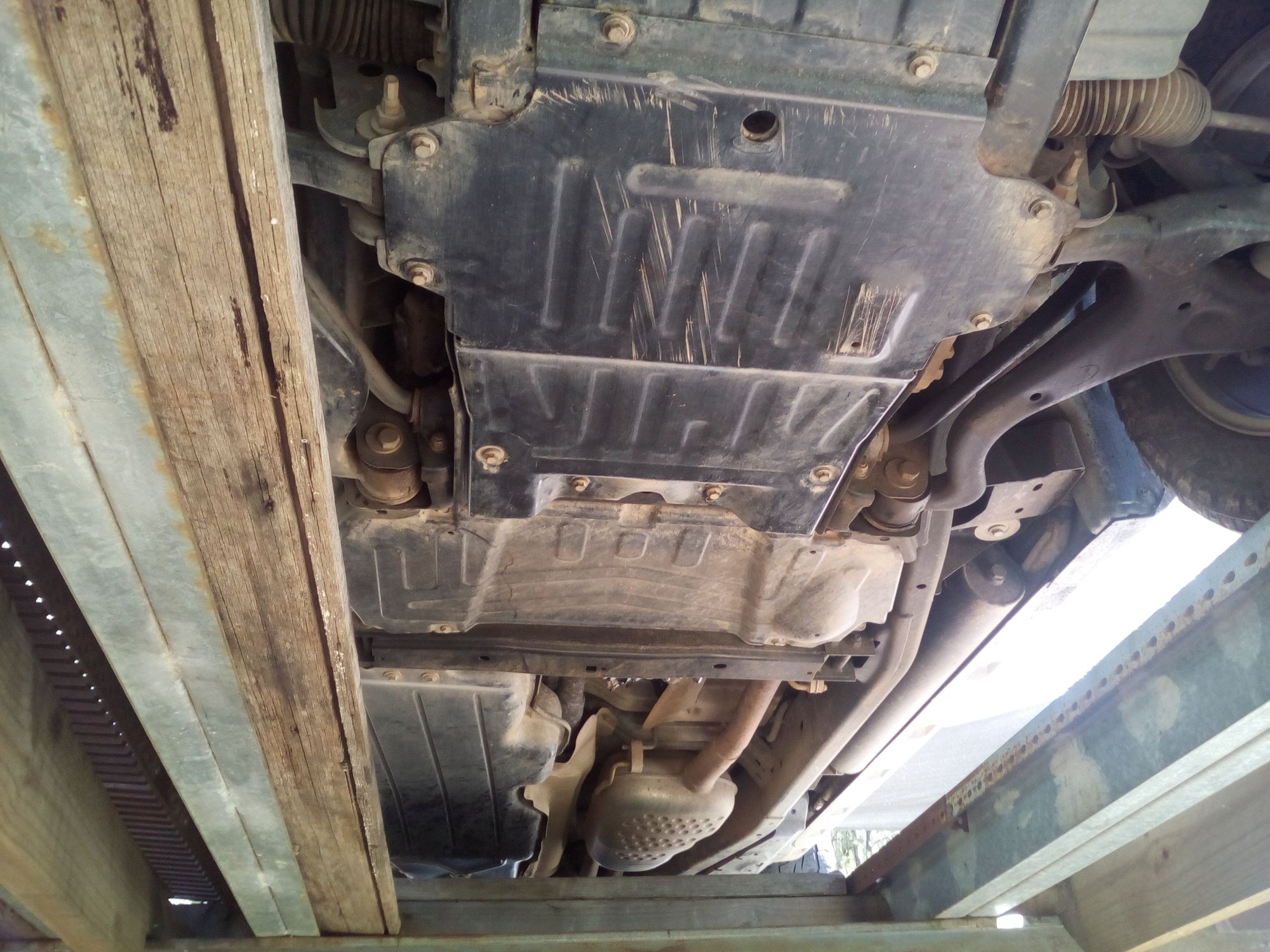

Finally found the time between the heatwave and the blast of wet weather to fit my steel ZF pan kit and replace the valve body seals. The TDV6 versions have much better access underneath than the petrol versions from what ive seen.
That was yesterday and today did a coffee run to 711 to get the trans up to temp then topped it off 700mls.

That inspection pit looks handy

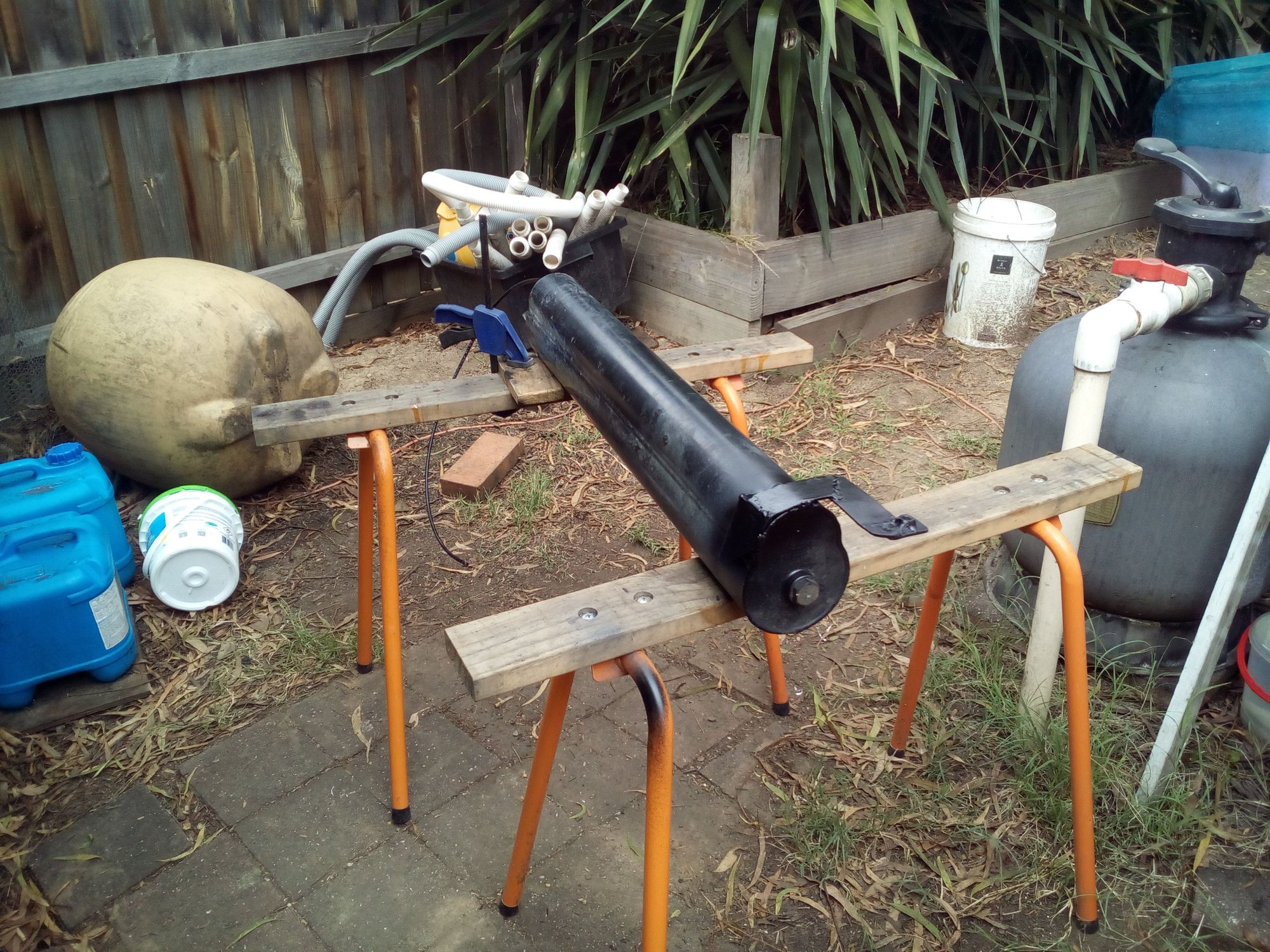

Replaced my shifter and loom due to the corrosion in the plug that frid the shifter PCB and gave some transmission faults, while at the wreckers i got a passenger side cup holder and an EAS reservoir that i mounted on the driver side in the same location as the factory one.
Welded a bracket for one end so i could use existing chassis holes, tank sits higher than the chassis which is what i was aiming for.

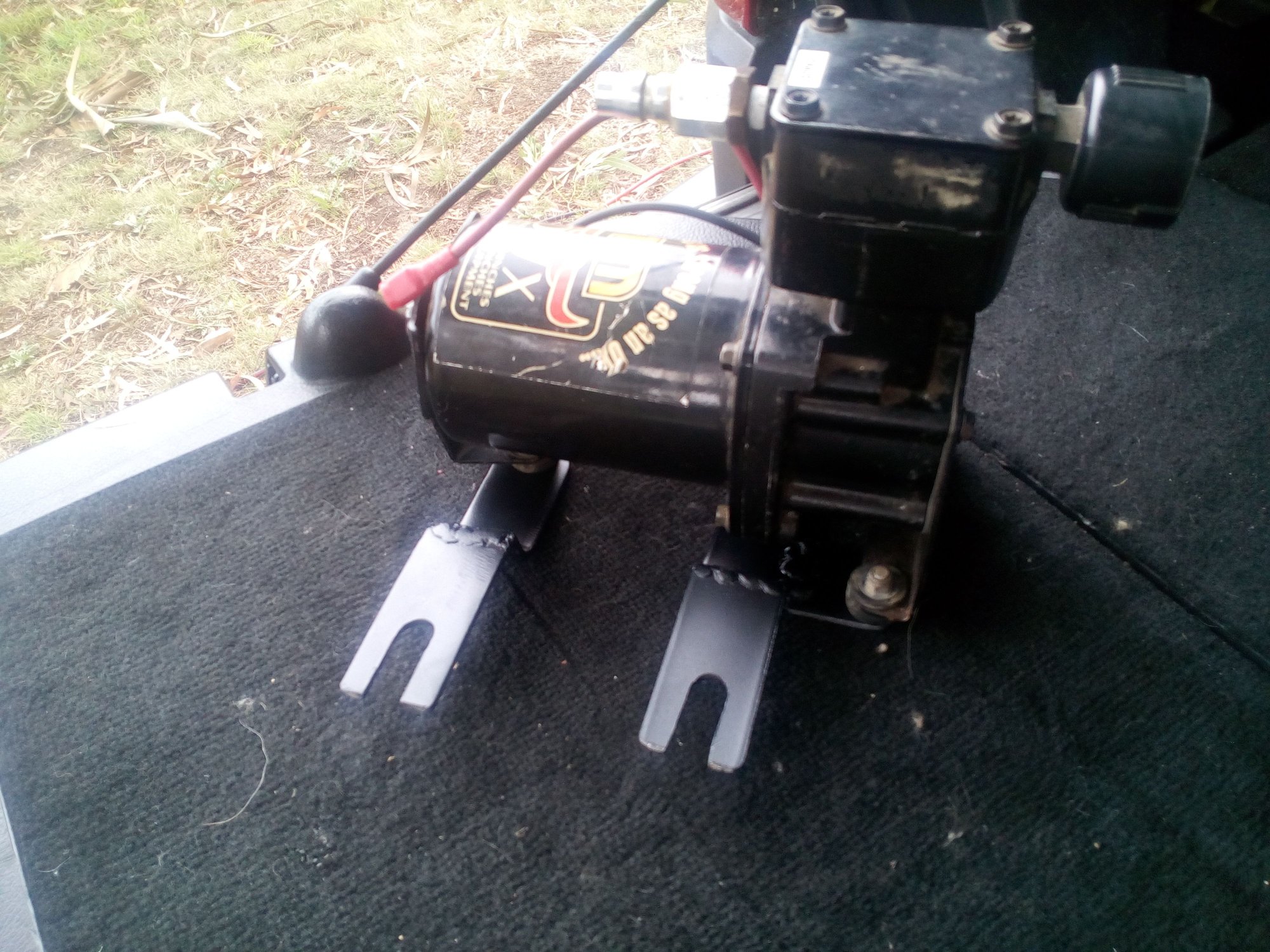

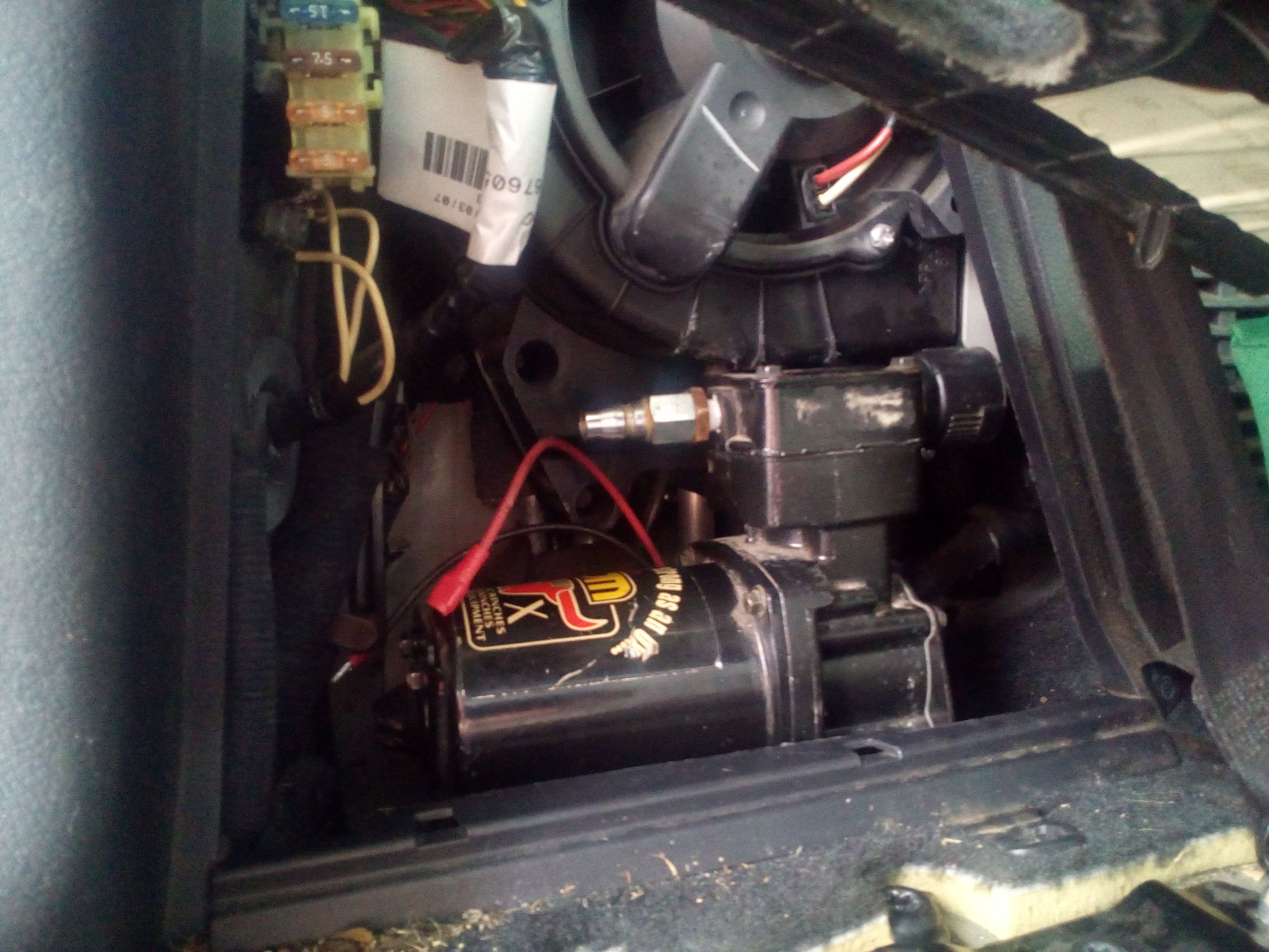

Removed the tow hitch foam and bracket and made some brackets to mount a TJM compressor in its place, tight fit but still space around it.

Is that trans cover plate factory? Was it only on TDV6? I have yet to find a LR3 with that plate actually installed.

Yeah factory , must be TDV6 only as the petrol's are different underneath. Its only plastic so would like to make an alloy replacement at some stage.

Final fitment.

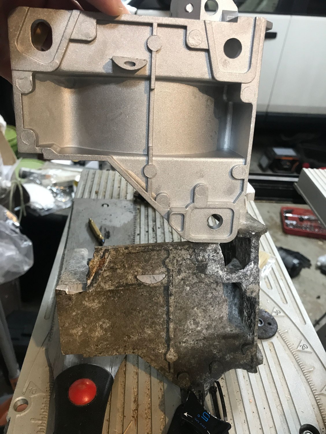

Gotta love that new england salt
Much needed compressor bracket replacement

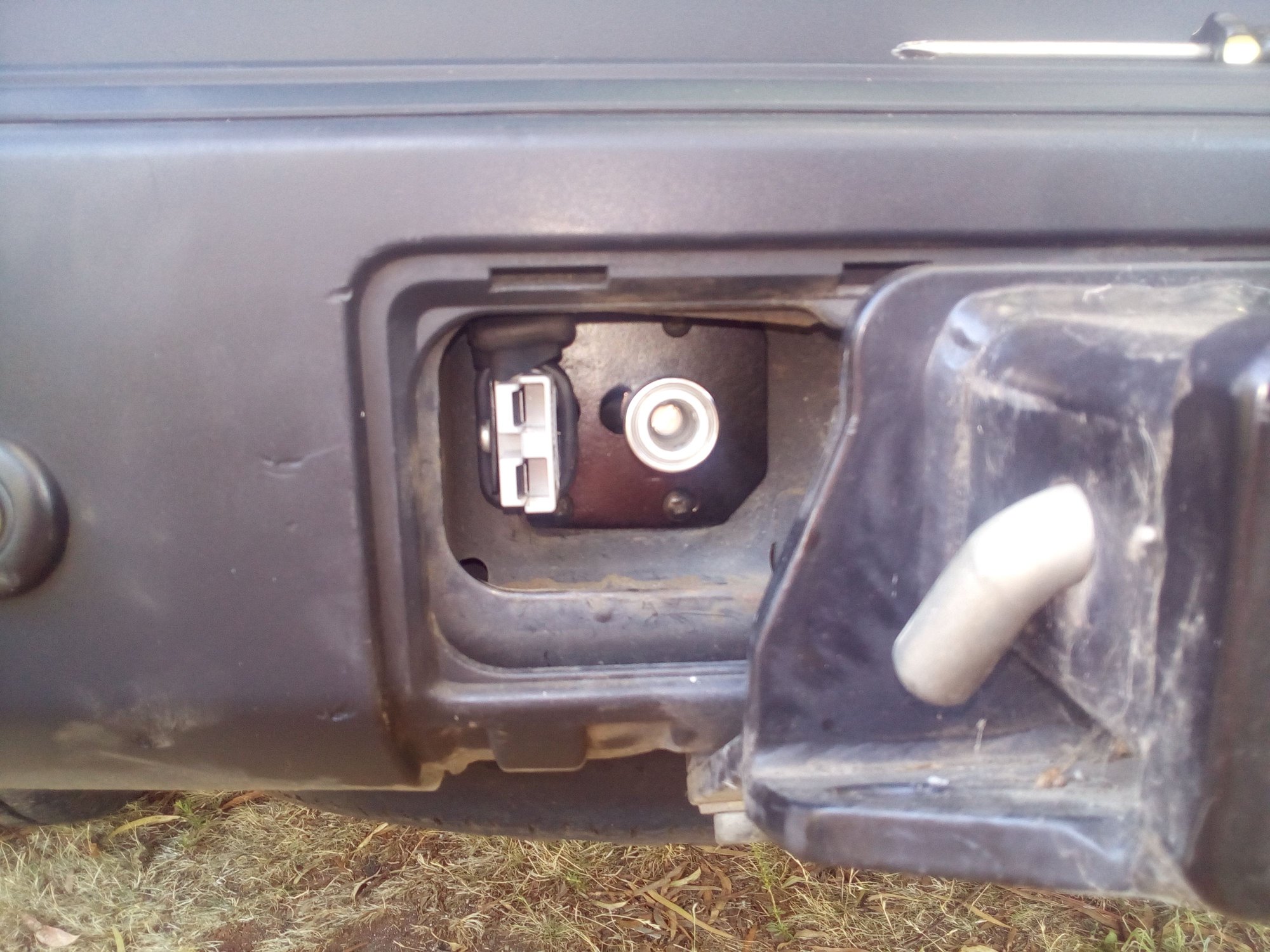

Removed the 12s socket and made a bracket to mount an anderson plug and a nitto air receiver
