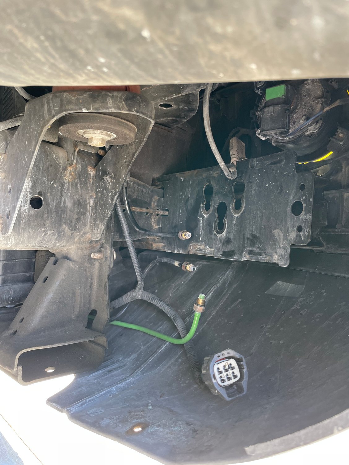

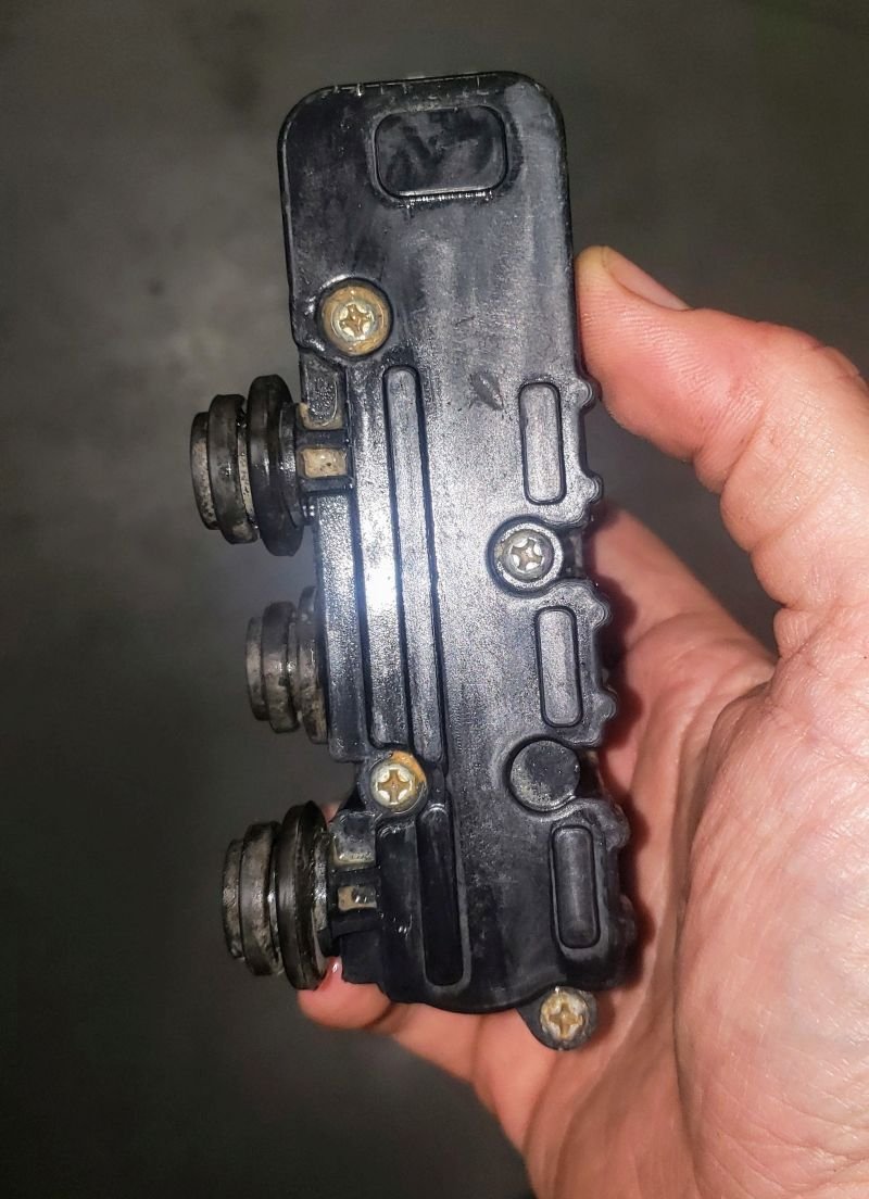

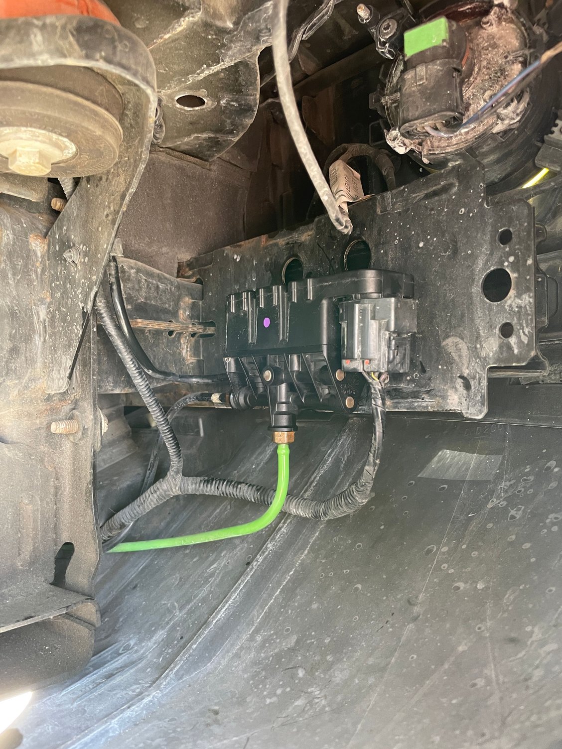

Replaced my front suspension valve block with an extra one I rebuilt ahead of time. Also found you do not have to take the whole liner out, 3 screws and one push pin is plenty. The flat rate tech in me is always looking for tricks to get these jobs done quicker. I'll take apart the original one when I have some spare time and see how bad it is. You can see in the second photo the 3 lines had quite a bit of white powder on them so I have a feeling it isn't going to be great inside the original valve. I do know that on first start up the front end came up quicker than it ever has. Sitting overnight will tell me if it's better/fixed as that is about how long it took to get it to sag.

Great tip Alex! I just replaced mine this week too. 3rd time and usually do the same trick The last one valve block I got was from Amazon was a 1/3 the price (~$50), but only lasted 14 months.
I was getting C1A31 which typically mean broken wire. I took out the entire wheel liner looking for any wire damage. WOW there are alot of clips holing them in and after 14 years they do not want to budge. I did remove 5 pounds of 14 year old dirt!
BTW - you can tell the difference between Genuine OEM and knockoffs by the top side which many ebay and amazon listings omit photos of the top. Genuine have torx screws and engraving. The knockoffs have phillips screws and not engraving:
Replaced with genuine OEM from Lucky8 this time - not worth the hours of effort for cheaper non-oem part. If the price is too good to be true, it probably is.

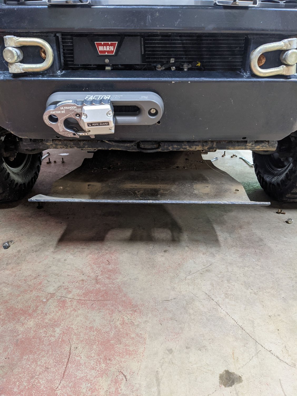

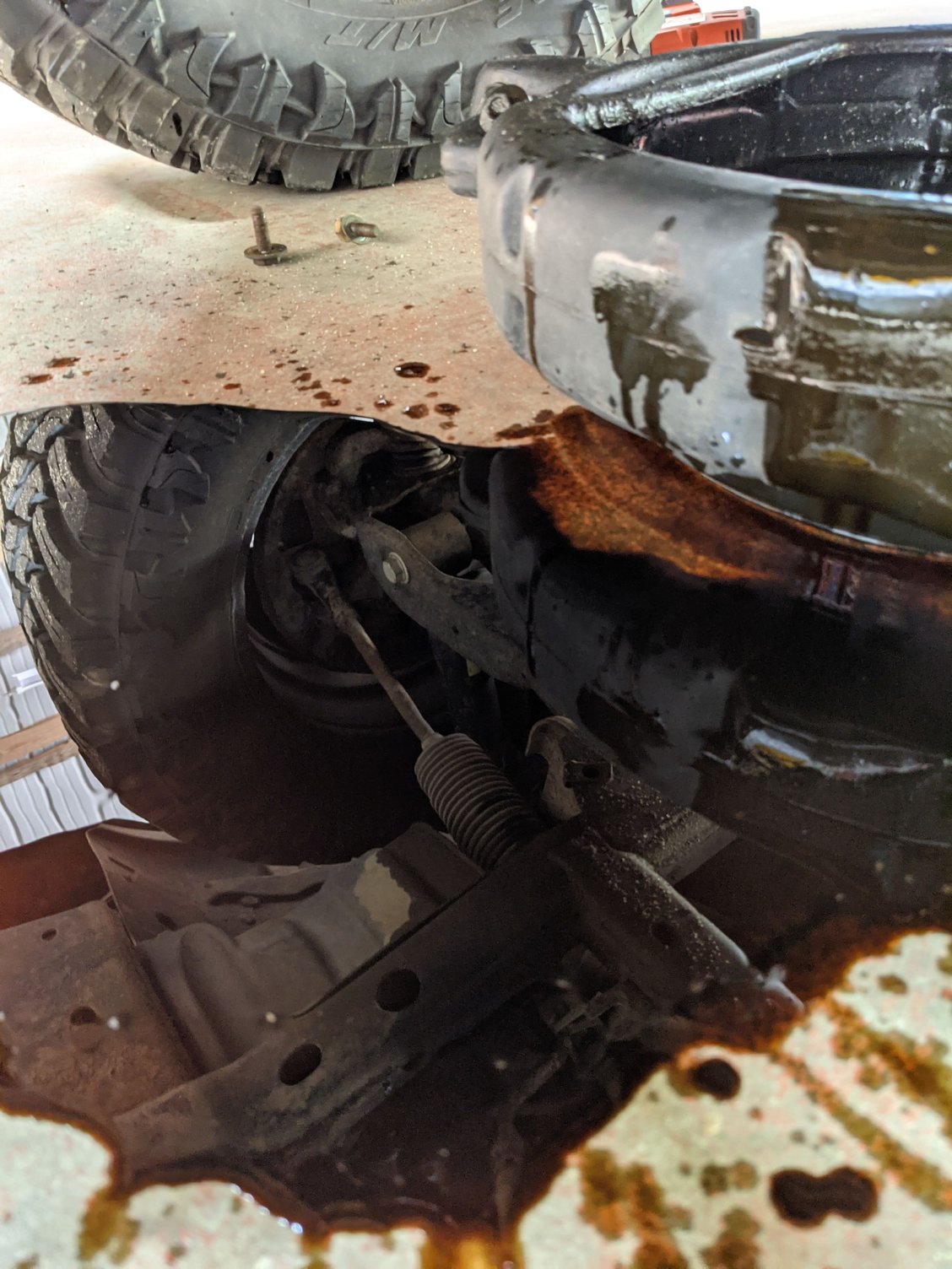

Did an oil change so off with the skid....
​​​​​​Than I spilled the oil everywhere so I used it as an underbody mirror to inspect 😂
Pretty sure I spotted a diff leaking...

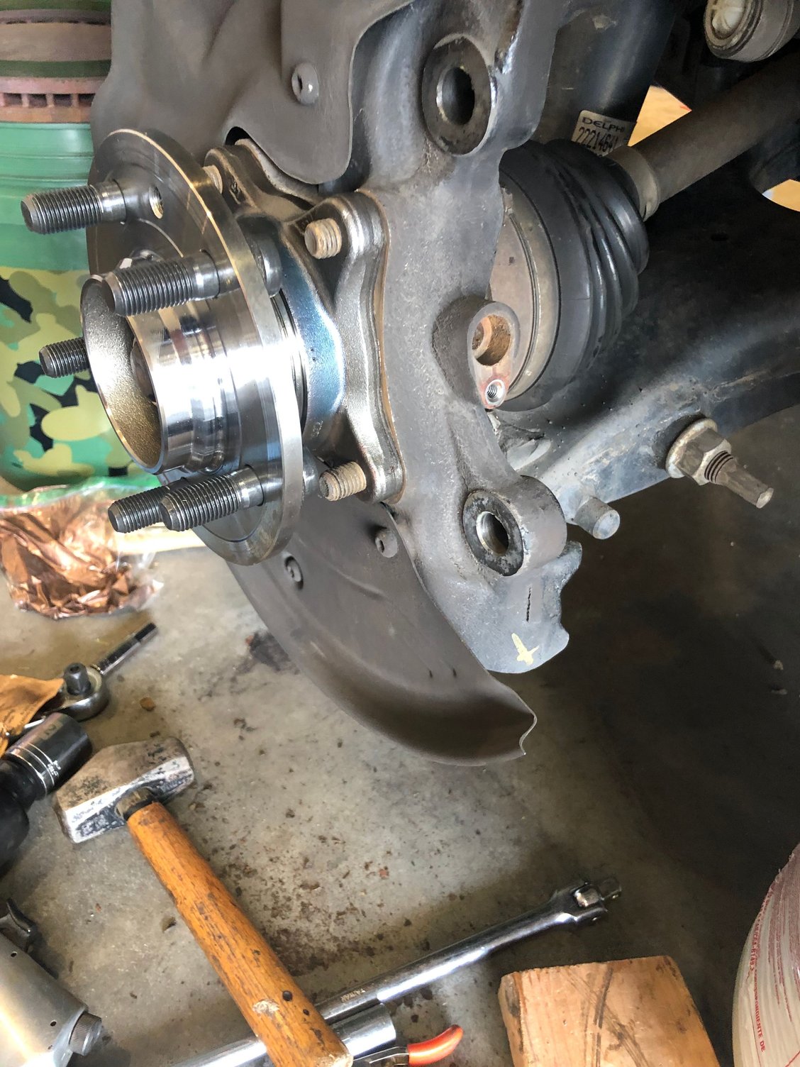

  #1630
COSPILOT's Avatar
Joined: Jun 2017
Posts: 256
Likes: 37
From: Colorado Springs
Hit 163K and replaced both front wheel bearing hubs. Only took a few hours, left side was worse than the right, but neither as bad as the YouTube videos front Atlantic British on the subject. Cured some noise I didn’t realize I had. Semi convinced I should upgrade to Brembo brakes because I think the caliber design is better overall from the RR SC Sport, however I haven’t figured out if the early RRS four piston requires 20”, or just the later 6 piston RRS does. Beyond that, it’s simple. Wheels are cheap if I need to go from 19 to 20. No longer off roads for mine, keeping it pristine instead.
