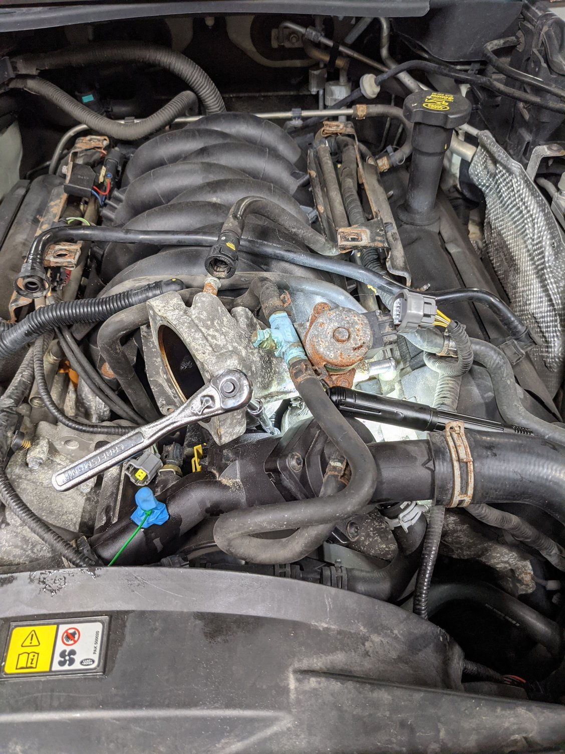

Started chasing down a coolant leak

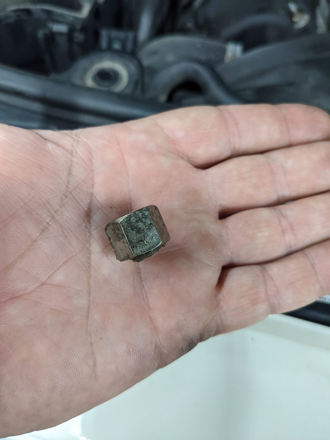

So that hose was snapped off from a larger hose that tied in a the back side of the thermostat housing area under the intake manifold.
Unbolted the manifold got it all moved for access and off the chunk came and I found this from a previous bleeder T.
So I think I found it. Got the cooling system bleed and all seems right in the world. A little driving should tell me if I am right.

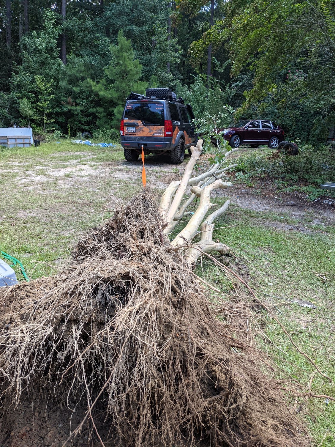

Put some Range Rover Sport wheels and tires on it and Monday I'm going to wash it before putting it up for sale on post. It has served my wife well but about 7 months ago I picked her up her dream car and I can't justify keeping it around.
Than I used my LR3 to yank a tree out

You don't have to pull the intake to do that hose, I think I made a write-up on how to? Well too late now anyway, but its easy to do.
