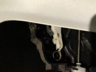

Im not sure of your precise issue but I have a problem with my driver door not locking. But if I lock it two or three times its fine and locked. Like its weak, so it needs a little more oomph to get it locked. If you dont have to to repair it you can at least try that. Might save you the hassle for now.
That was one of the first things I tried. The fix mine needed I found in a YouTube video. I bent a part of the metal arm to push on the plastic locking mechanism arm. This has fixed my issue and only took about an hour and a half of my time. The small metal arm I bent can be seen touching the white plastic lever. It took two different tries to get the right amount of bend in it but wasn’t too hard.
Here is the video I used that was the fix for my LR3. I was able to do the repair with the actuator in the door cavity, I just unbolted it from the door shell.
