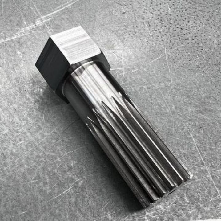

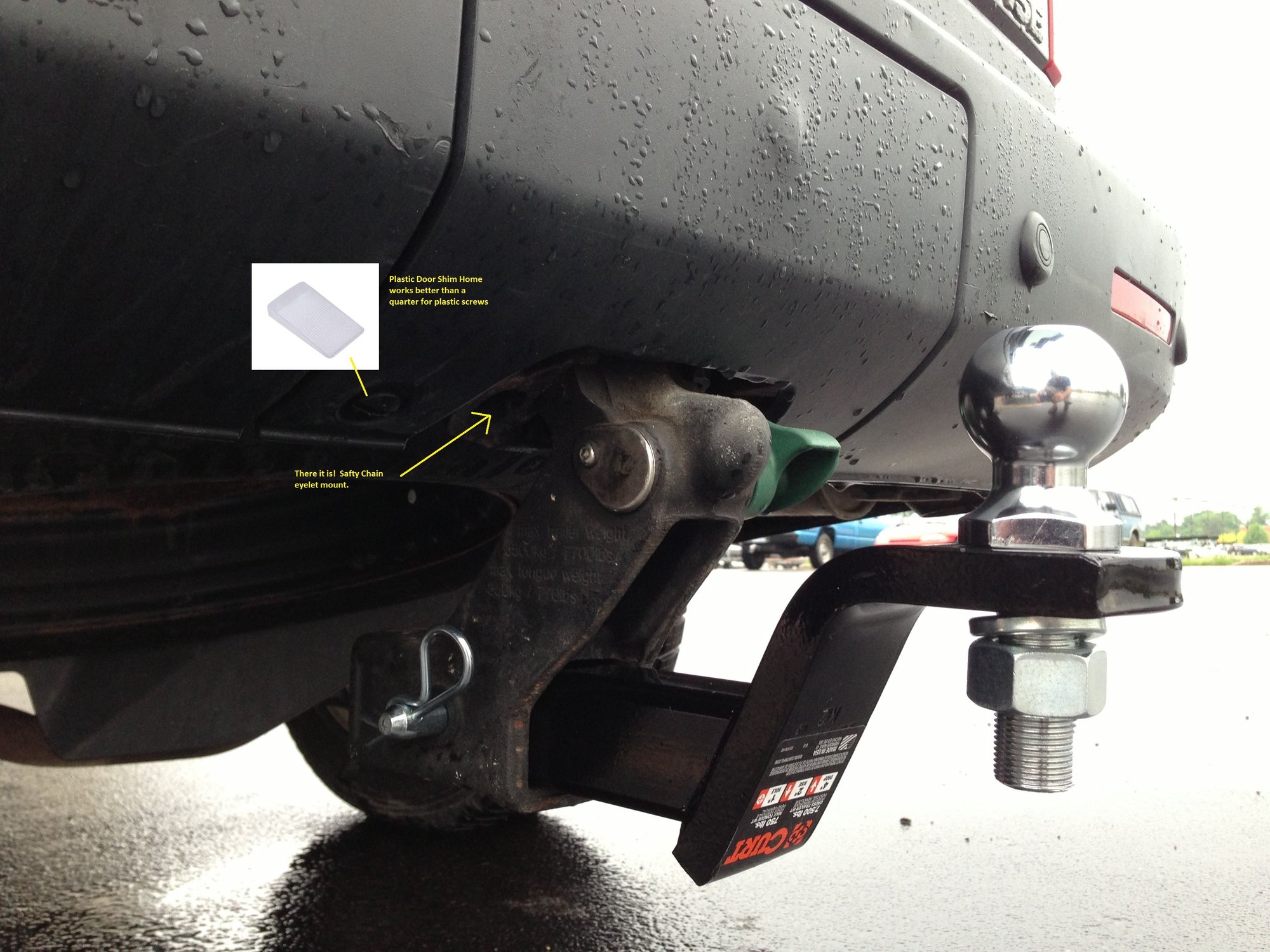

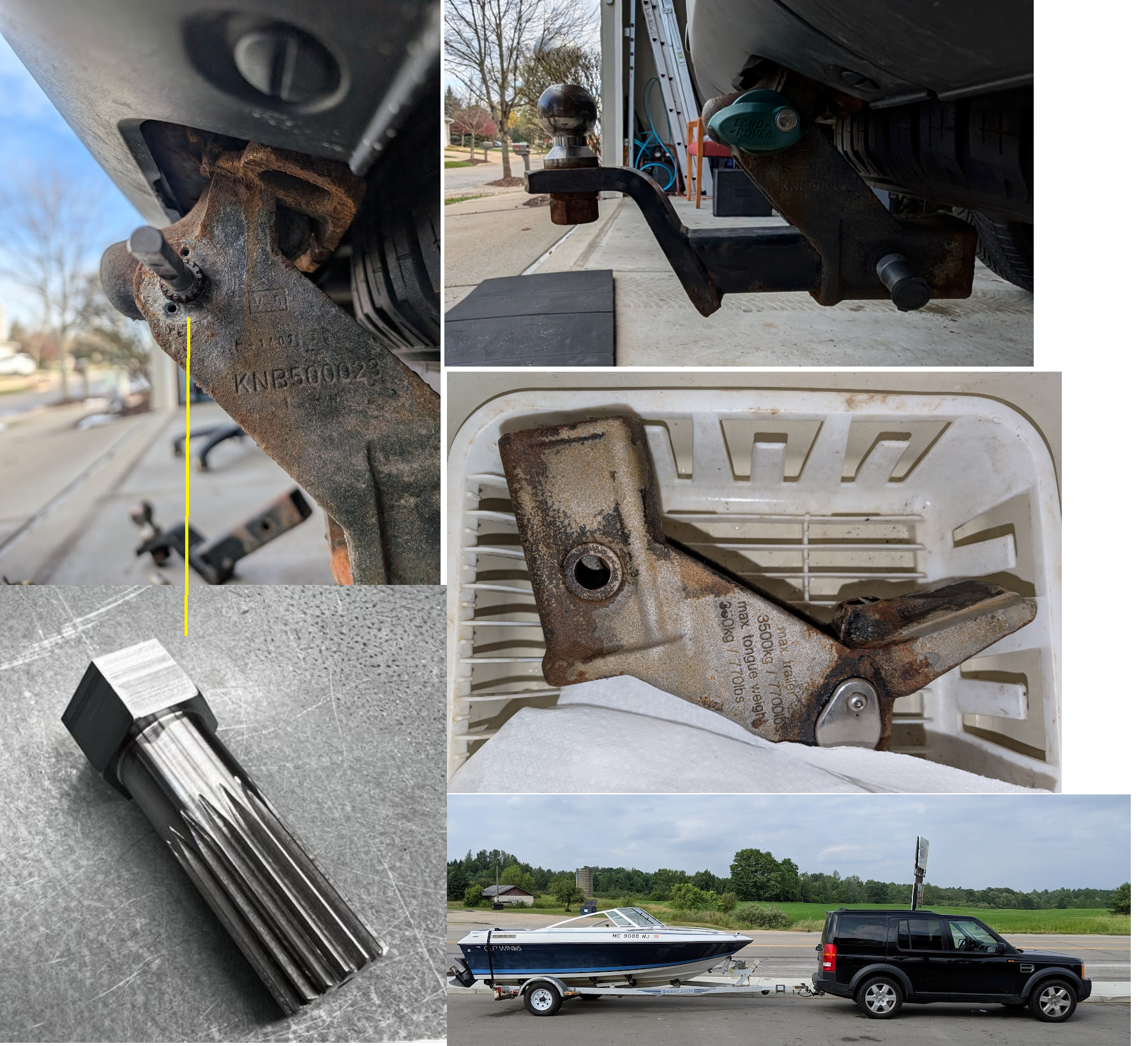

Finally was able to remove a frozen hitch 3+ years. I was towing a boat a few years back and was unable to remove the hitch using the green ****. I tried to rubber mallet off off etc. You really can't get any leverage using the puny green handle. I think I was going to use a grinder to cut it off. I just left it on year round and finally found this removal tool. You have to knock out a roll pin on the green handle and slide if off then swap the gear with one that has a 22mm nut on the end for some real leverage. Using just a Large crescent wrench I was able to muscle the pin to retract. (I jacked up the car 1" from bottom of hitch to take any pressure off the pin. Once I retracted the pin just a hard rap with a ruber mallet and the hitch dropped to the ground. I'm cleaning it up but so far I can't get that large pin out of it. Just going to soak it for a long time in penetrating oil. I ended up buy a new smaller hitch.
That is a goofy hitch design for sure, built to easily fail from rust. I plan on getting the rust off of it prime and paint it like new. Any advise of what paint to use?
