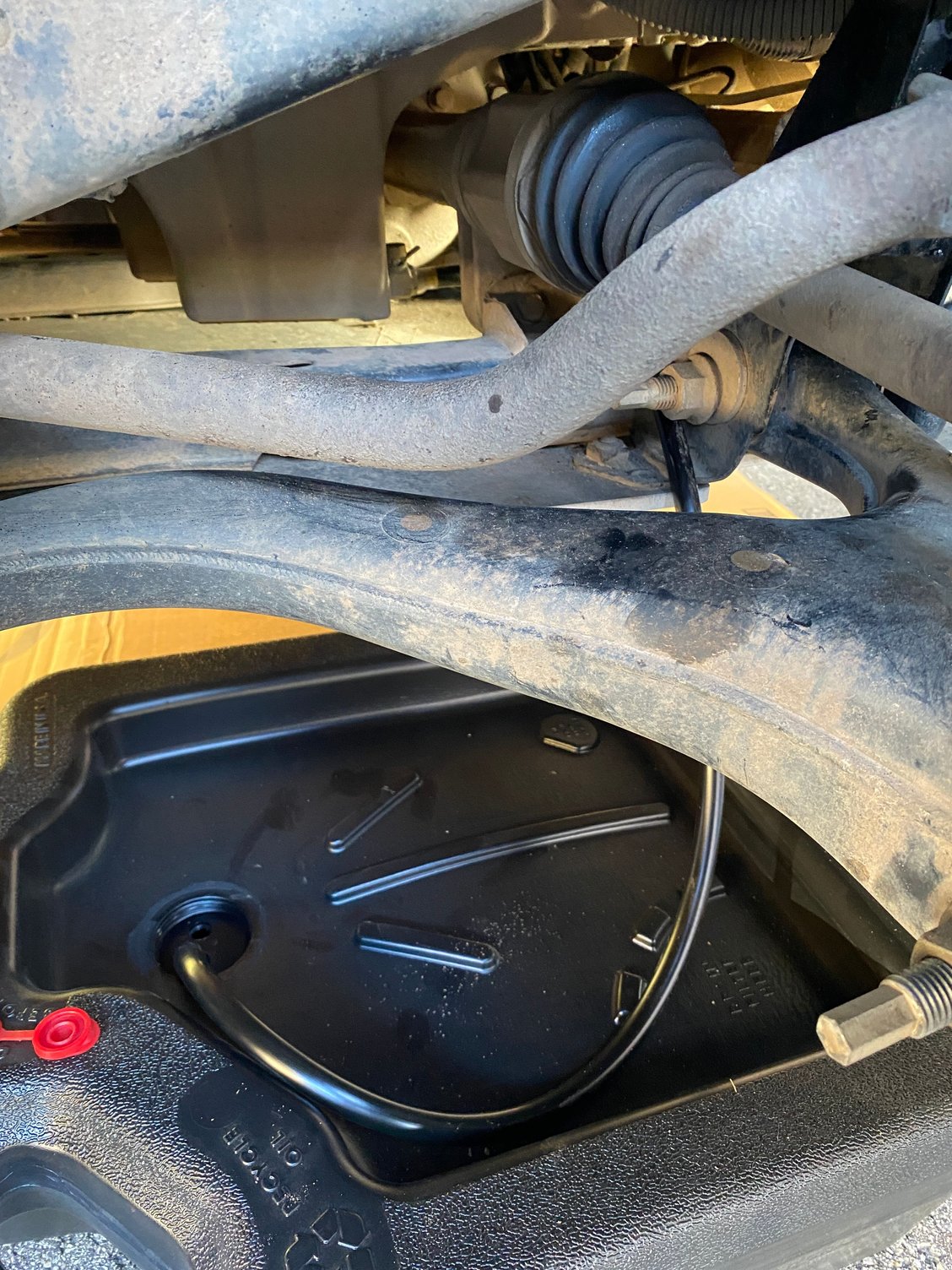

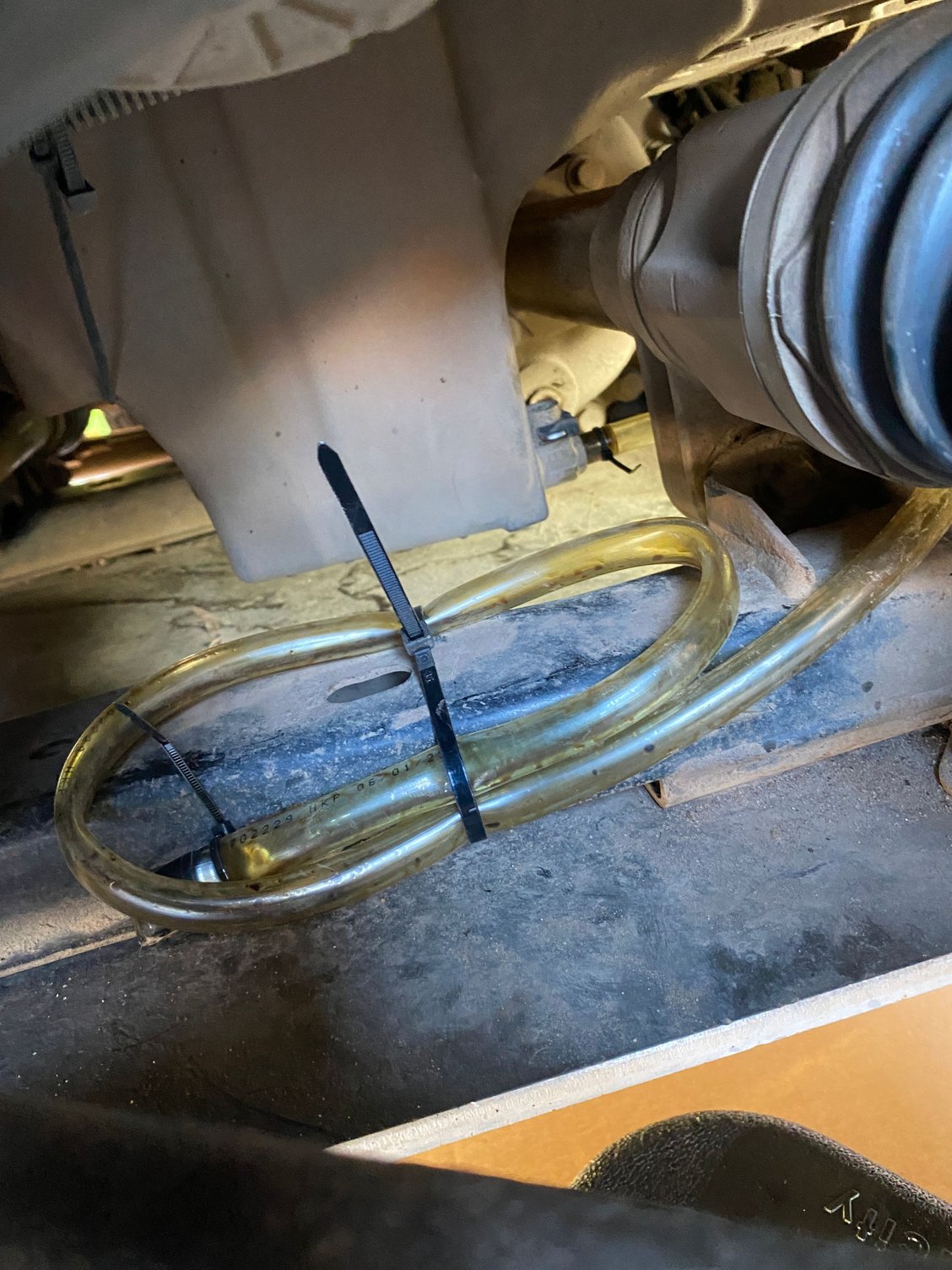

Did an oil change. But this is the first time I ever did one without removing the massive skid plate. I had to remove my passenger wheel to do some other work, but normally I can just turn the wheels to full driver. This allows two things. Lets me reach up behind the passenger wheel to get the hose out, remove the valve safety clip and open the valve. And on the driver side with the wheel kicked out I can pull the splash cover and reach in to remove the oil filter. I just have to put some towels down to catch the oil from removing the filter. makes for MUCH faster oil changes. Also since I had the wheel off I replaced the oil filter housing adapter gasket - that figure 8 one that likes to leak. Had that dang gasket on hand for like two years. Again, did that with the skid plate still installed and it was not difficult at all. Once I do my valve covers, the oil leaks will finally be done... for now...

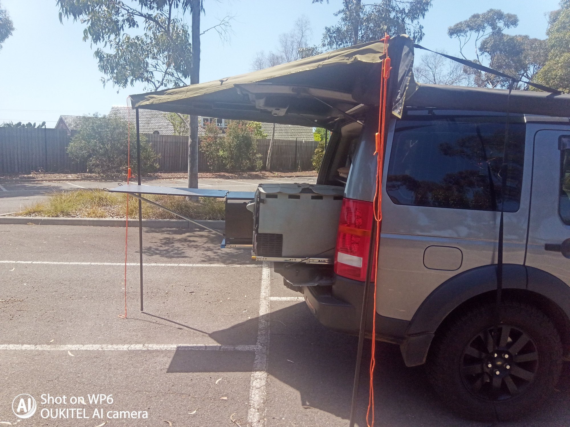

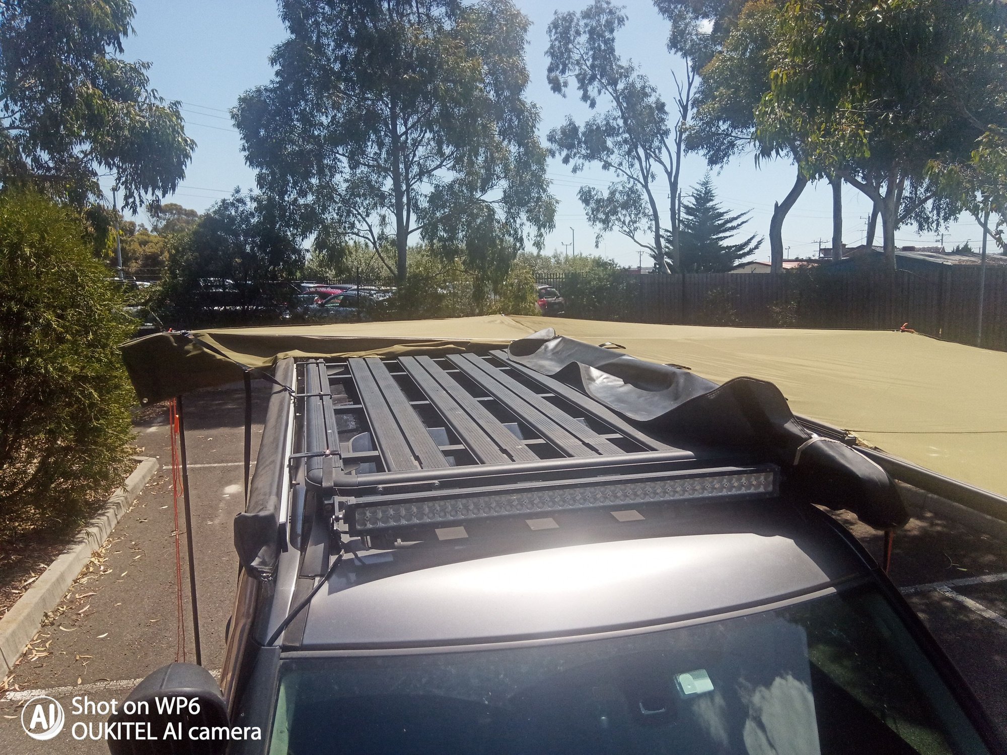

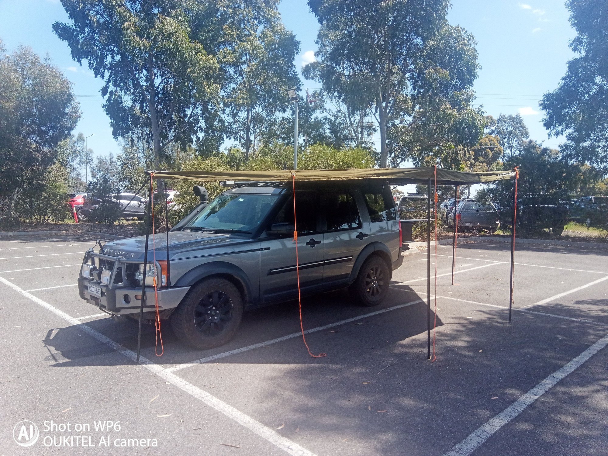

Just bought a 270 awning last week, 23Zero Falcon, and had a quite day at work so opened it up in the carpark, clears the tailgate nicely and doesnt add much height to the rack.

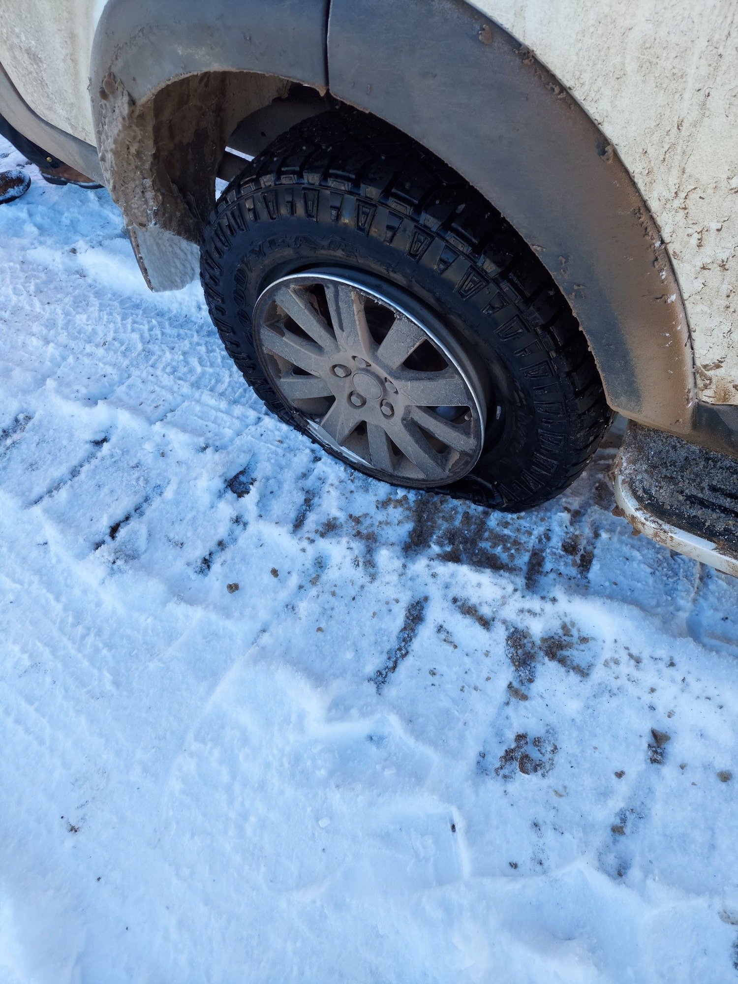

Took mine hu ting again from Atlanta to Colorado (1633 miles) one way. Drove all around the mountains on some sketchy roads with snow, ice, mud. Never let me down other than when the temp in the morning was -5 degrees the compressor gave me a warning light and disabled the special programs and would let me go to Offroad height. Once she warmed up and I restarted the LR it worked fine. No other warning lights the whole trip. Right around 4000 miles this trip. I’m sitting at 258,500 miles and still rolling strong. Picked up somebody’s wheel weight going up a snowy trail. Luckily I was about 4ft from the top, so I was able to pull off and get the spare out on (in negative 4 degree’s). That was not a fun task.
