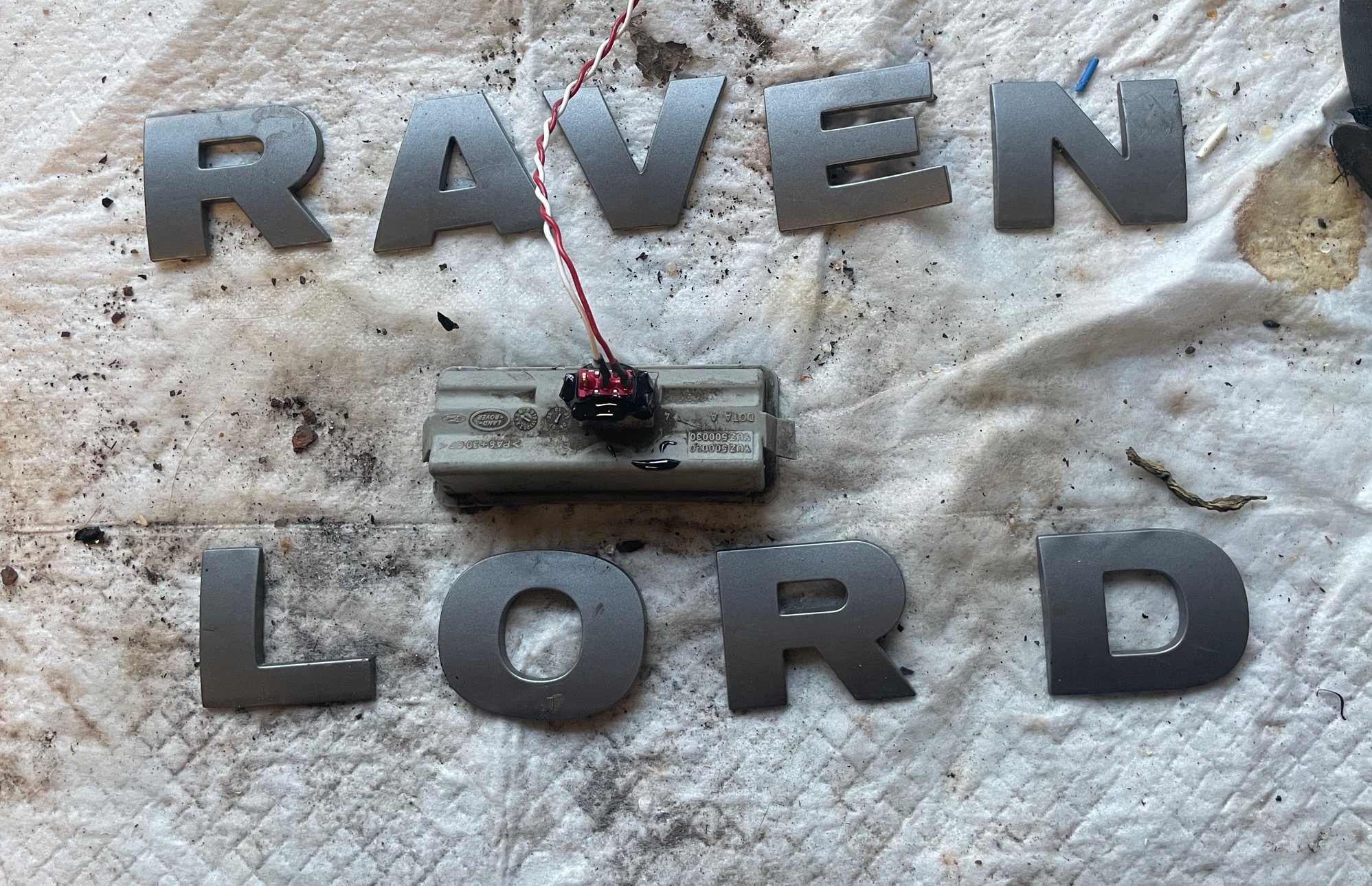

It's an anagram!
It's an anagram!
anyways, the switch in the tailgate handle failed and rather than replace the entire handle and spending $70 I decided to raid the junkbox and epoxy in a computer switch.
