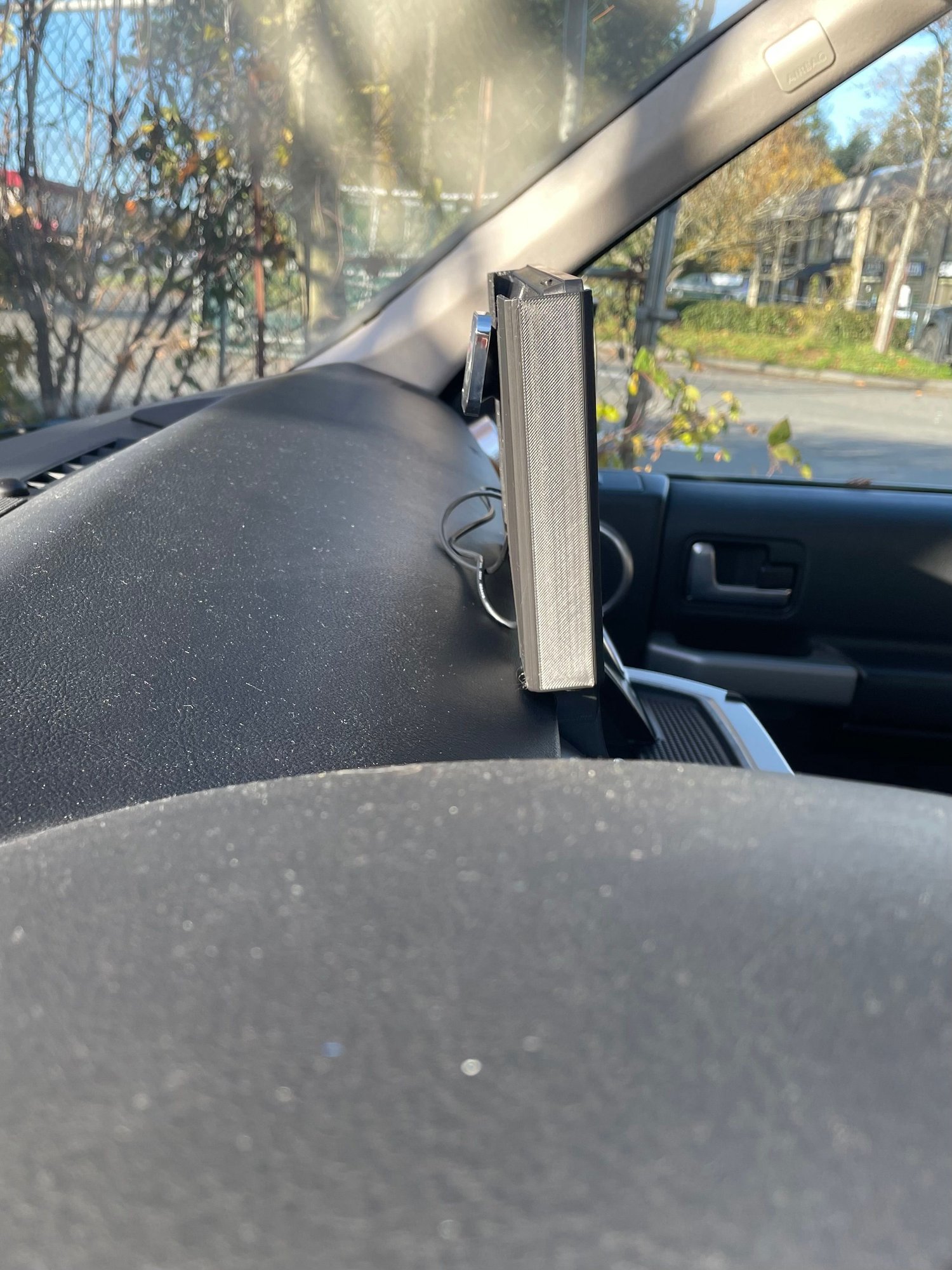

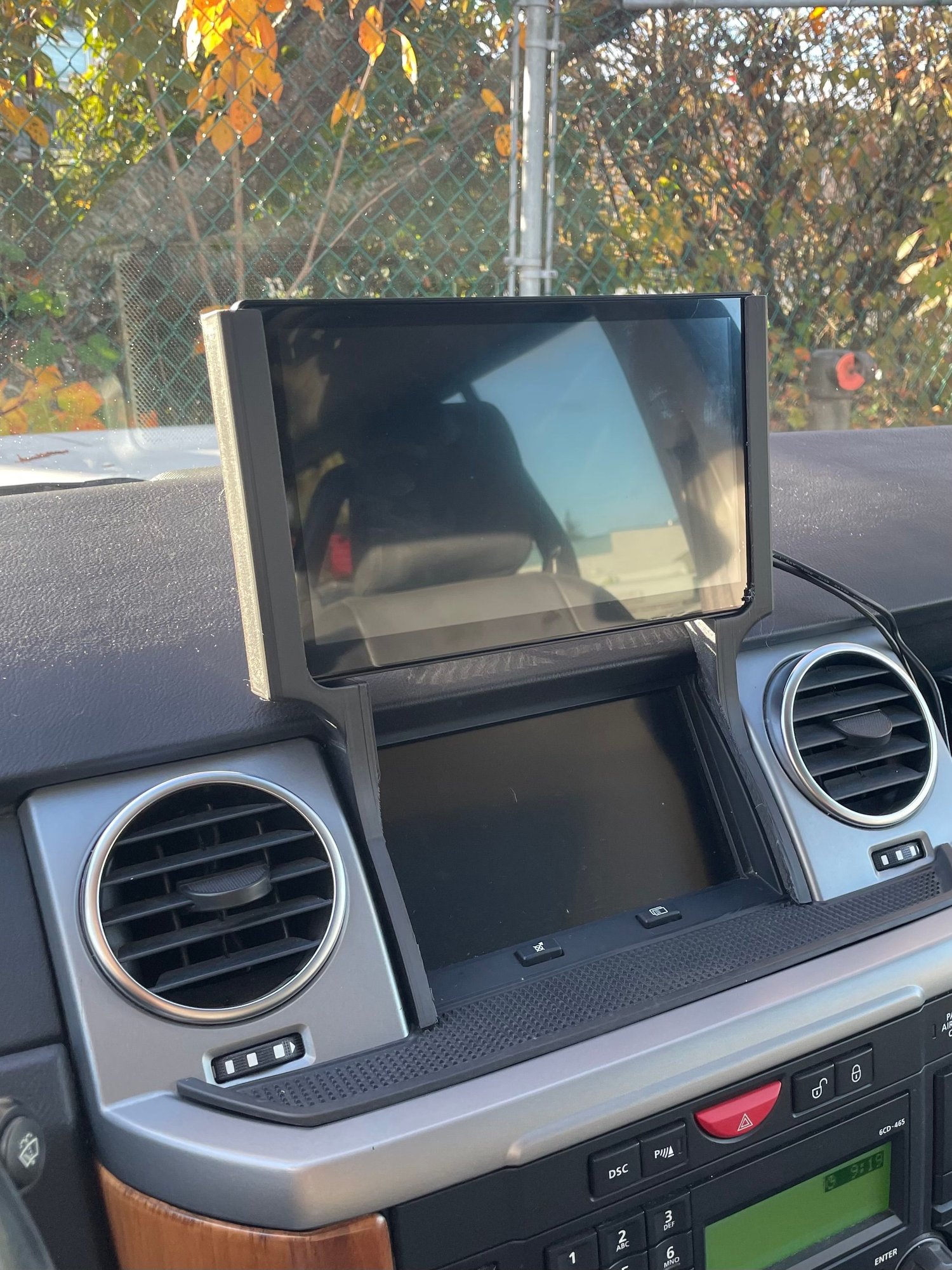

Ive been really wanting an actual functional screen in my lr3 for a while, but I also didn’t wanna replace my screen cause it still “works”, so I finally pulled the trigger and I bought a 9” carplay screen off amazon for $100 that came with a forward and backwards camera. I spent a couple hours designing some mounts and 3d printed them so I could fix a little more seamlessly vs the suction cup ones they provided. I didn’t want to use any adhesive, so these are friction fit into the tiny gaps between the vents and screen. I gave it a pretty good test drive today and she held sturdy. This is just my POC so it’s a little rough around the edges. I’m also ultimately planning on running the wires behind the dash from a little gap top right above the vent so they will be barley visible. I’m pretty happy with how it turned out so far, the best part imo is that everything is still original.

Very nice! I need to make something similar for my iPad. I bought a holder, but it is large and cumbersome.

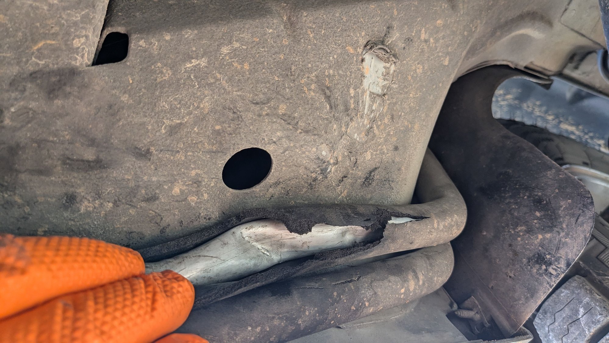

I was working the rover clearing more trees on the property last week and it seems I drove over a large root on the trail as I was dragging a tree trunk,
It hit the rear heater coolant line and then hit the body coating. I have ordered a replacement part (Good thing I don't go into town to buy those $5 cups of coffee because after THAT purchase I will have money to buy a double latte, double camel two shot whipped cream something or other in the near future). As "Trail Fix" I cut the aluminium tubing and patched in a 5/8 (16mm) heater hose with 2 hose clamps.
I have avoided adding rock sliders for many reasons. Mostly the weight and amount of time I would actually be on rocky trails bad enough that I would need them. And of course the cost.
It took a small hit on just one hose and then again on the body.
