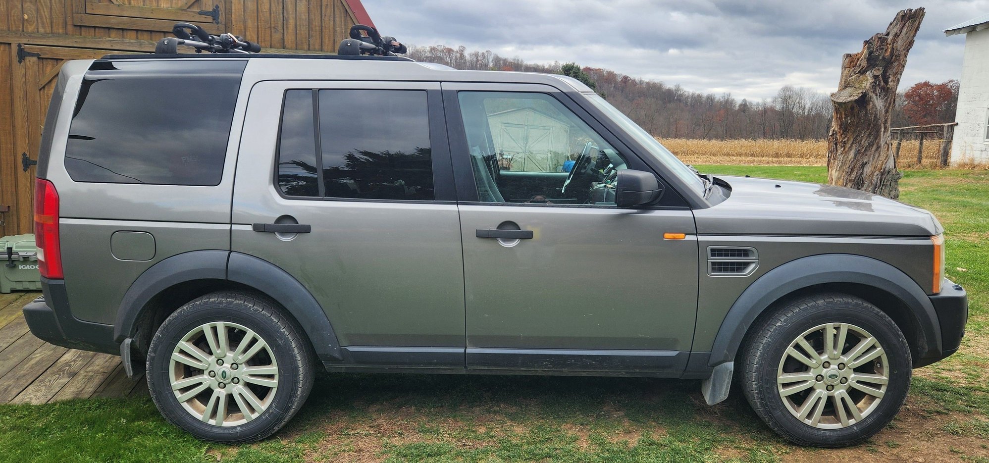

Finished the following projects on the 2008 LR3 - Front Lower Control Arms, Front Wheel Bearings, New Driveshaft Carrier, Rear Brakes, Land Rover OEM Front and Reservoir Suspension Air Valves, and Oil Change

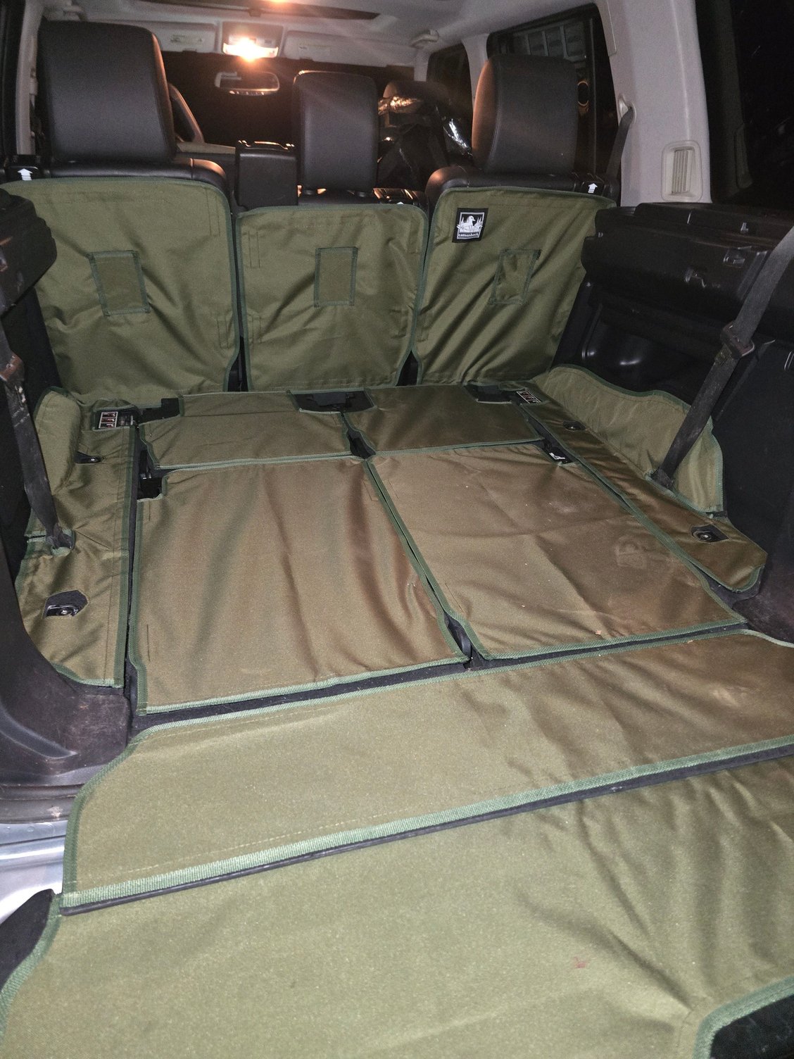

Finnally got my Canvasback cargo liner installed!

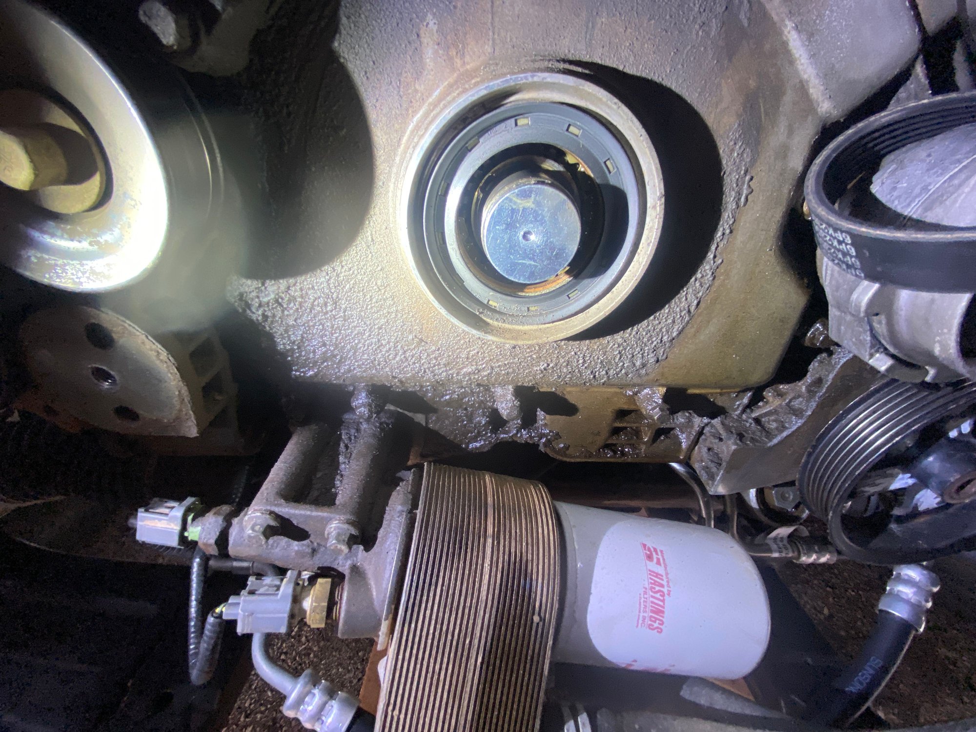

Put a new crank seal in today on my 2006 with 235k miles. Annoyingly it was not needed. I bought the seal, new crank bolt, tool kit, etc... But it was way too clean behind the crank pulley for it to have been leaking. First time doing this job and it was oddly easy! I started it today (Friday) after work to get a jump start on it. Was to be the main weekend project. But I got it done in less than three hours. Will post a thread with more details, but here is how the old one looked. No oil leaking and the back of the crank pulley was clean too. And incase anyone asks, I had already replaced my oil housing seal. In fact to be certain it was not leaking I replaced it again a couple weeks ago. Seems I have a timing cover leak.

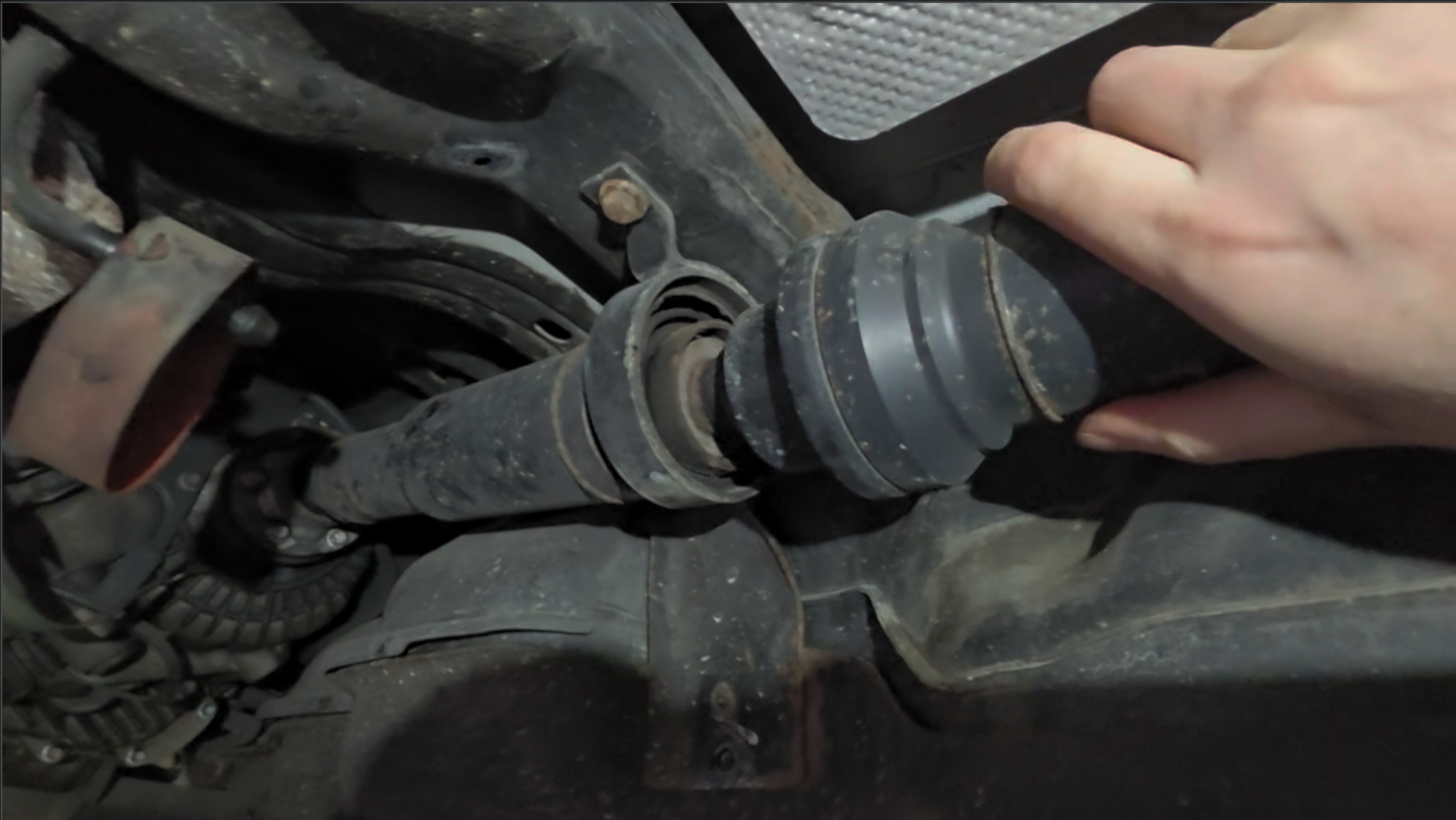

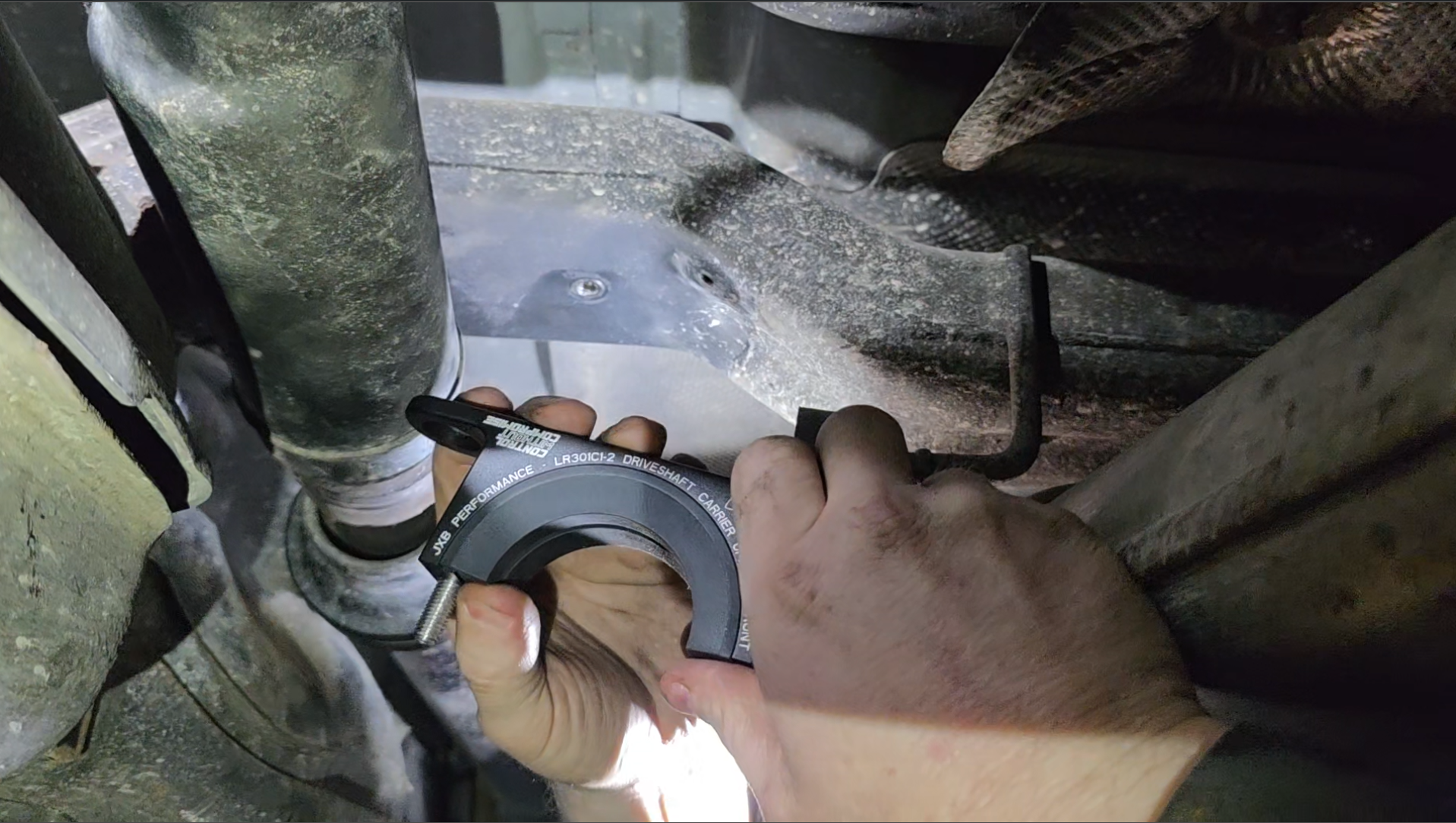

Replaced the driveline carrier with an aftermarket solution. Had purchased this for my truck, but when installing a new diff in his, we noticed how worn out it was and so I gave it to him. Pretty easy, the 2 minute manufacturer's video is all you need to know, but we had fun making a full process video!
worn out factory bushing
aftermarket carrier
aftermarket carrier

I like the idea of that driveline support, but by the time the carrier goes sometimes the CV and u-joint are also worn out. This annoyed me greatly as I had a new carier bearing on hand!
It would be handy for on the road, because that banging around underneath gets pretty ridiculous.

^ Exactly. For the price of those, which does not replace the bearing in the center support, you are much better off with a new driveshaft.

Good feedback! I got it as a gift for a friend, we'll report back on how long the rest of the driveshaft lasts. How would we go about judging the ujoint and bearing quality, do we have to pull the driveshaft to do so? When replacing that carrier, there wasn't any rotational slop in the drivenline (ujoints still good?) and the movement at the bearing between the 2 pieces seemed smooth (would the joint show wear somehow?).
Thanks for the advice!

I'm not sure you can really tell the condition of the bearings with the drive shaft connected, unless the wear is severe enough to show play in the joints.
I found that my rear U-Joint was notchy when I removed it, if I hadn't I wouldn't have known it. I do know that when I made a fast start from a full stop it made a lot of noise underneath, almost like a stripping sort of noise, as well as the slapping around the center bearing.
