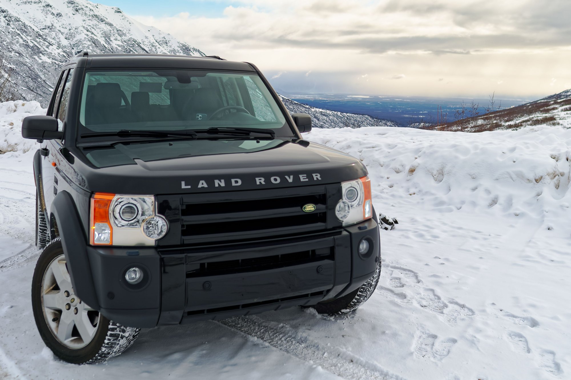

Hello from Alaska! Got mine on the 9th last month. 2008 Java Black LR3 HSE with 114k miles. Not exactly just a "what I did to mine today" kinda post, but what I've done in the past month, and what's to come this month.
I began with some light paint correction - scratch x, polish, and wax. The paint was pretty dull looking when I first got it.
Next, I ordered the OEM trailer hitch and trailer wiring kit, OEM ipod kit (so I can use either my ipod or one of those bluetooth adapters), and changed out all the outside halogen bulbs (parking/turn bulbs) for LED. Changed out the side markers that were cracked for clear LED ones.
I've got some other OEM accessories I ordered that it was missing - roof rack, rubber floor mats, etc.
Today though, I'm changing out the front lower control arms. The left side has been clunking slightly since I got it.
Still winter in Hatcher Pass I see. But then again, I escaped te 907 14 years ago and it snowed here in northern Michigan yesterday.
If I was still there with an LR3 I'd be going up to Monument up by Eureka, Jim Creek, Purinton Creek, just in case you needed some bad ideas

I've been wanting to go to Jim Creek, but the control arm issue has kinda put a damper on that. Ended up having to cut the back bolt on the LCA. Of all the years I used to work as a mechanic, I don't think I ever had issues with suspension bolts... def had to torch some exhaust bolts to get them out though. I'm at the point where I'm just gonna pay a shop to do the other side , then get the alignment done.
I'm waiting on the summer tires to come in (ordered some terraincontact a/t). I kinda wanted something a bit more aggressive, but I travel a lot for work.
