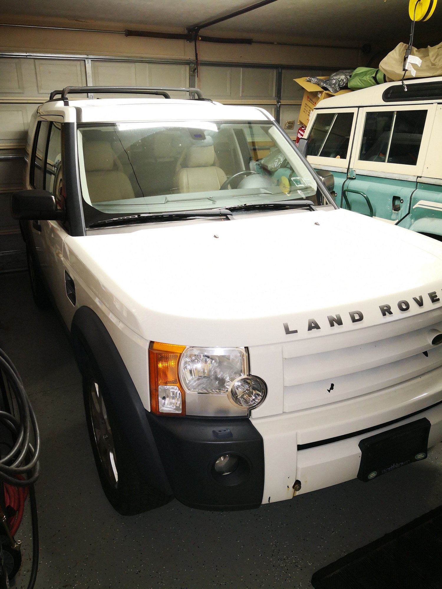

So the LR3 was in my Garage waiting for me. Shift linkage was jammed. Pulled it apart, cleaned it up and lubed it. Still a bit stiff but functional till I can get the parts delivered from Lucky8.

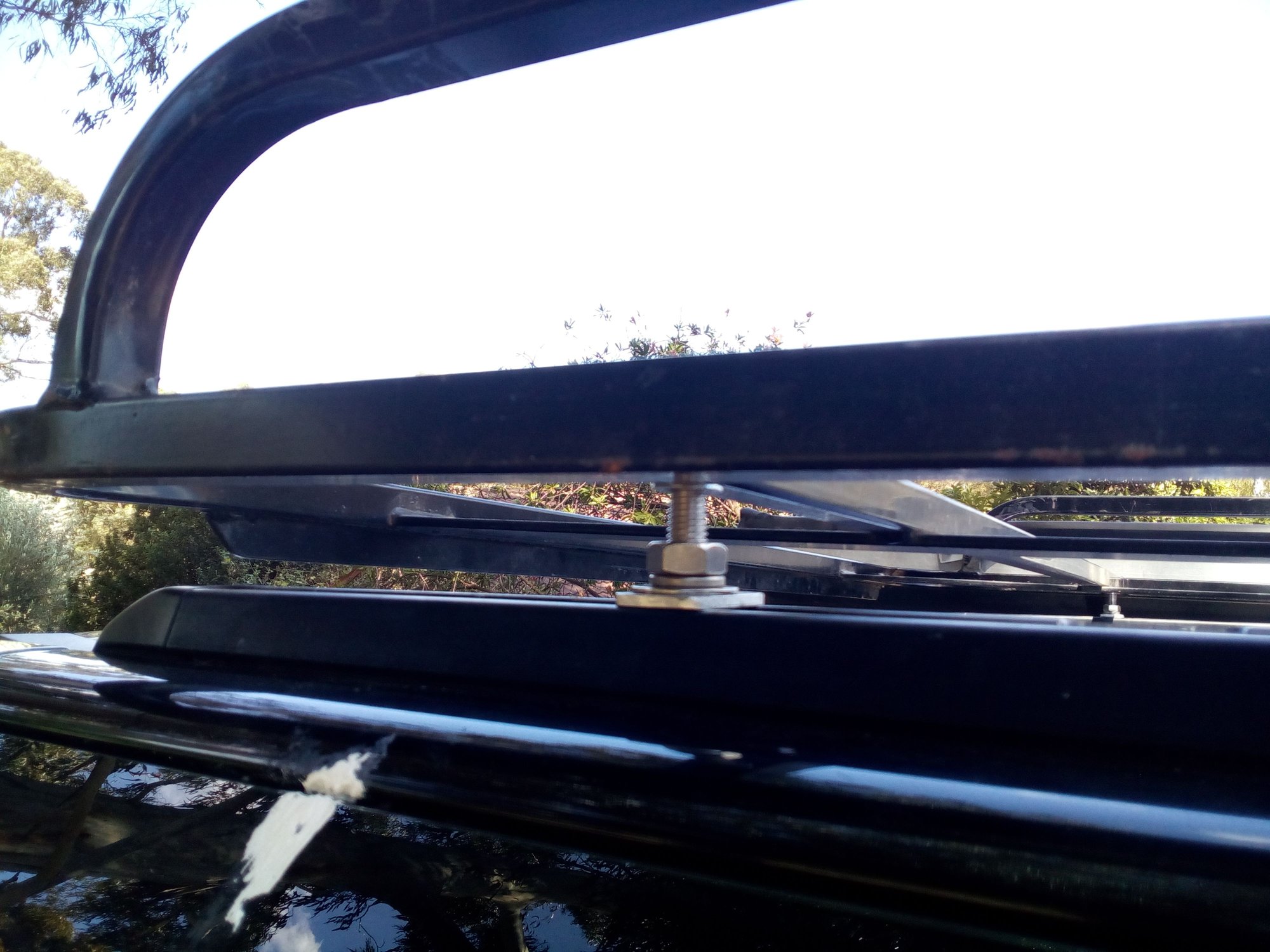

Did this last week before going away, had this rack i got cheap off ebay and set about making brackets as it didn't have any. I wanted it low and to use the existing short rails but also to clear the sunroof, came up with a simple idea of using rivnuts in the rack then some countersunk M10 s/s bolts + nuts with some alloy flat bar. My only flaw in this plan is that the rails are not parallel as they taper from front to back, easy enough to get around by fitting the mounts in the track then screwing the bolts into the rack.
Now i have something to mount my 42" light bar to that's been in the box since selling the D1.

Apart from the bird **** on the rear glass it WAS pretty clean, it also helps helps when you buy a 1 owner well maintained vehicle which has been 99% trouble free.
