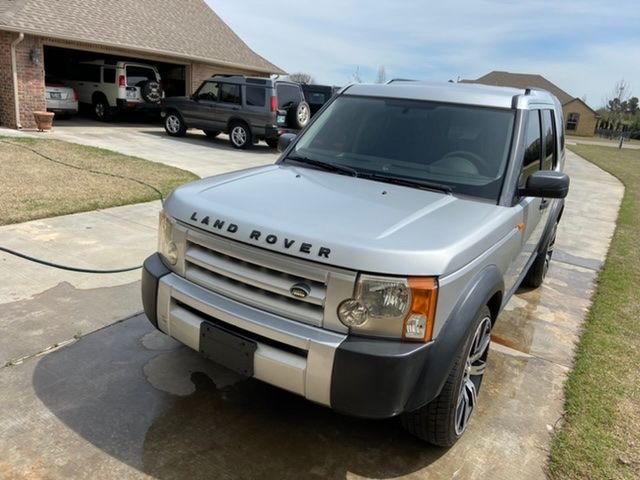

Left front in, now to the right.
Time to re strut the rover, so the dogs can ride in comfort.
