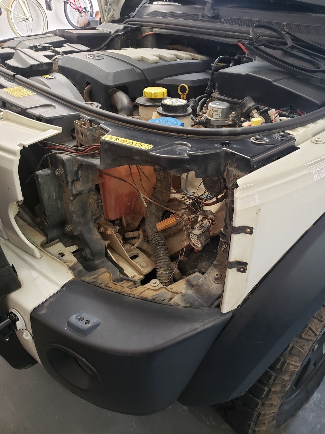

Smelled something not-so-sweet:
Wet coolant tank bad sign
Literally sprang a leak
Replacing the coolant tank is 100X easier with the headlight out. Even with A-Frame and headlight guards its worth the extra step.
Watch the AB/RoverParts How-to video and its a breeze! Less than 1 hour including the celebratory beverage.

Wow, kudos, I wudda jb welded that and had several beverages. ..maybe I'm really a Jeep guy underneath all my Rover-love..
