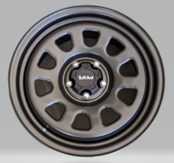

I'm having a hard time searching -- coming up with definitive specs to run 33-34" tires with 18 wheels.
I'm assuming I can achieve all this with the full SYA kit, IIDTOOL and Rims and some trimming?
+ Harness relocation
+ AC Line relocation
+ Flattening out the wheel well pinch welds ?
Can anyone help -- Which backspacing is the most ideal?
I'd prefer a more skinny tire vs a wide tire personally.
I think I'm going to go with the Tuff Ant wheels in charcoal.
https://www.tuffantusa.com/product-p...8-steel-wheels
I can't find any 18" beadlocks beside the Tibus 18" $$$ Nice but not practical right now.

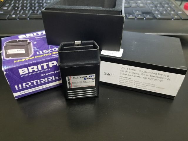

The BRITPART BT IIDTOOL showed up today.

I have 5X Tuff Ant Wheels are on the UPS truck as we speak. They should be on my side of the border next week.

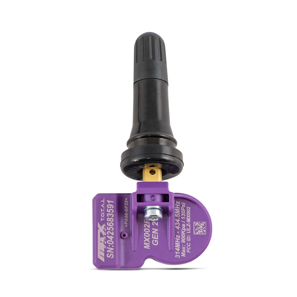

I need to figure out the TPMS solution once the wheels arrive. I understand OEM sensors wont work due the the shape of the wheel.
They recommend using the band type, but I don't understand why certain aftermarket, non-band type TPMS sensors won't work with these wheels.
This TPMS sensor "in theory" should work because its not a hard mount like the OEM It's a pull through valve type.
It is held in place only by the rubber valve itself.
So again, "in theory" is the wheel can accept a valve stem, this type of aftermarket sensor should also work...?

The IID tool works. For troubleshooting and diagnostics, it's perfect, simple. It just works.
It came in handy when I enabled the towing features on the LR3 after installing the trailer wiring kit from British Atlantic.
I don't exactly see how its practical for lifting. In my opinion, it's a bit "slow" and cumbersome to connect, sync, calibrate, lift, adjust.... yadda yadda.

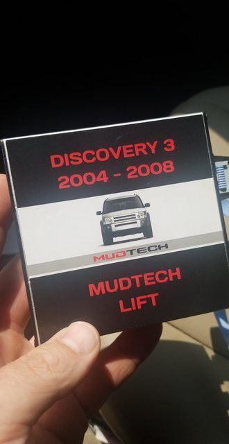

The MudTech4X4 ANITAS lift showed up yesterday.
It took 15 minutes to install. only tools required were a Torx bit and a Philips screwdriver. It was a painless, plug-n-play install.
Now I have the lift controls available at the push of a button.
No Calibration required.
No connecting, no logging in, no authorizing, no fumbling with screens.
7 preset button functions. The device is pre calibrated.
