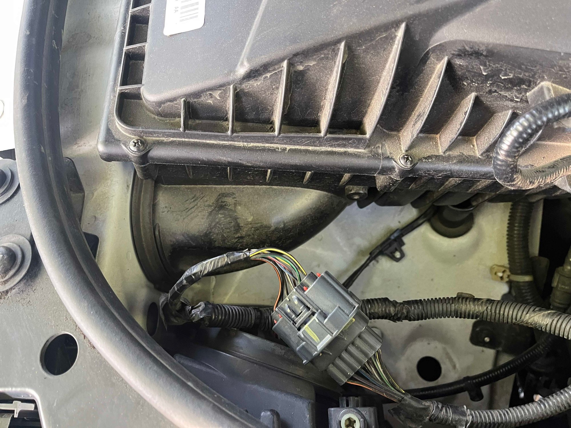

I learned something new. The air suspension from the front valve block and the front right sensor stop and plug into a separate wiring harness just behind the right headlight. Someone had unplugged this connection.
I am rebuilding a LR4 so there are some unknowns.
So I did not need to replace the front right sensor, however any day you get the air suspension working properly is a good day.
Here is a picture of the connection
