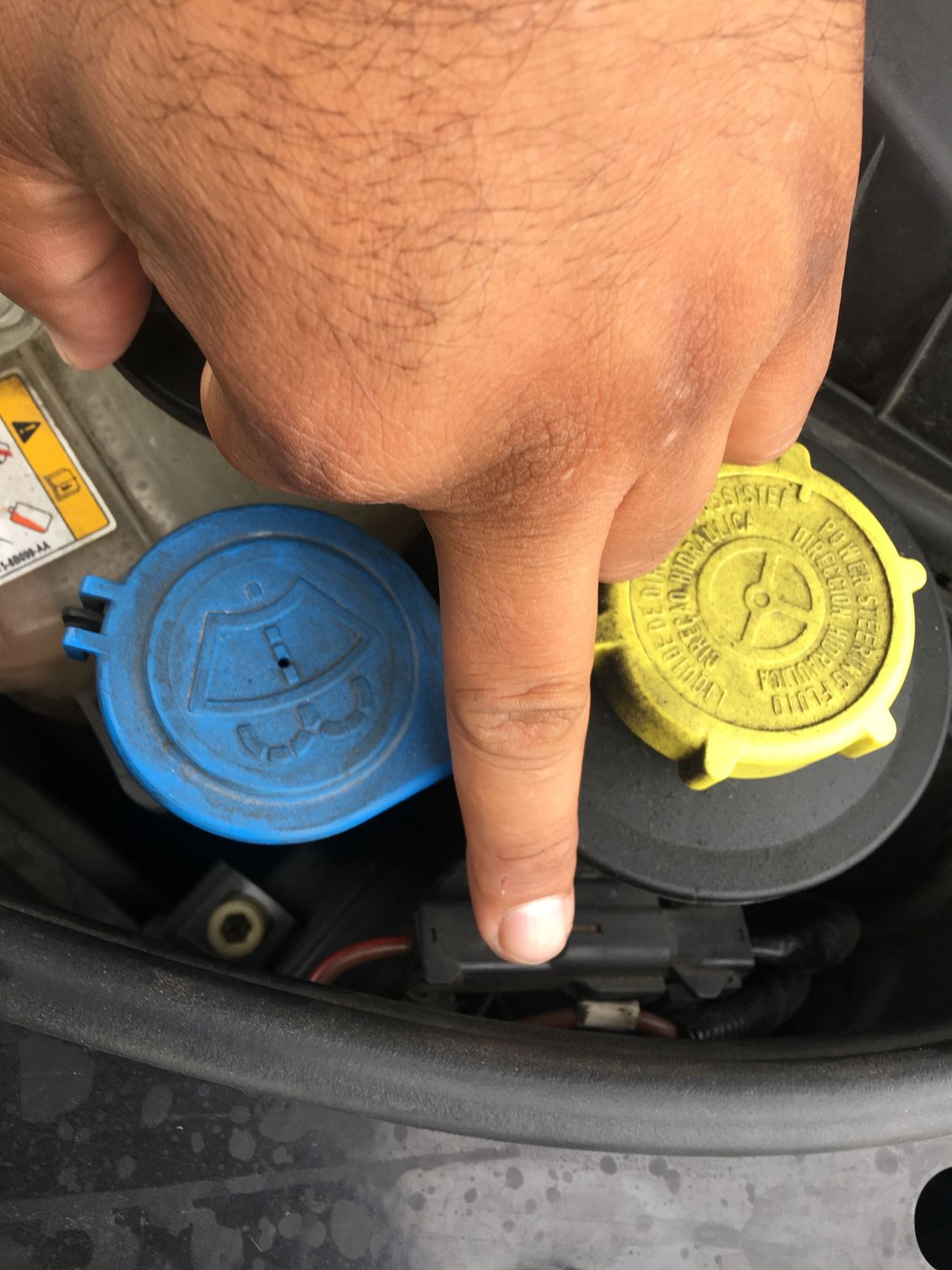

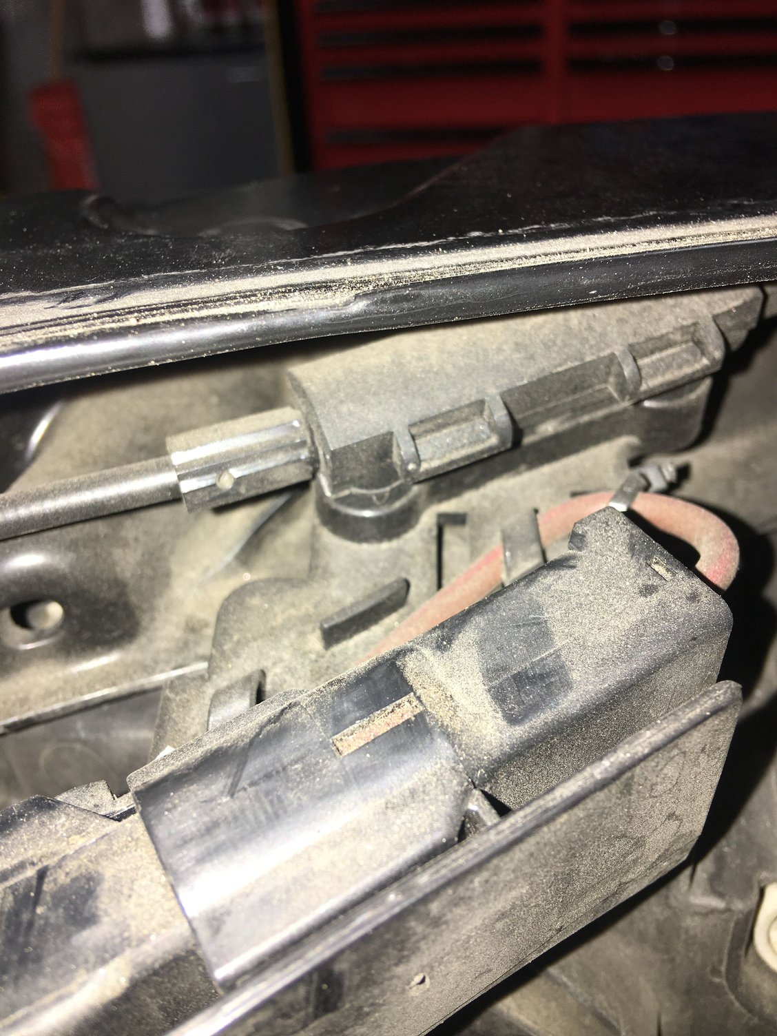

Im in the final stages of putting my LR4 back together after a lady ran a red light and swiped the front end. There are a couple of electrical connectors on the front left that I cant seem to figure out where they belong. Can anyone possibly shed some light on the situation?

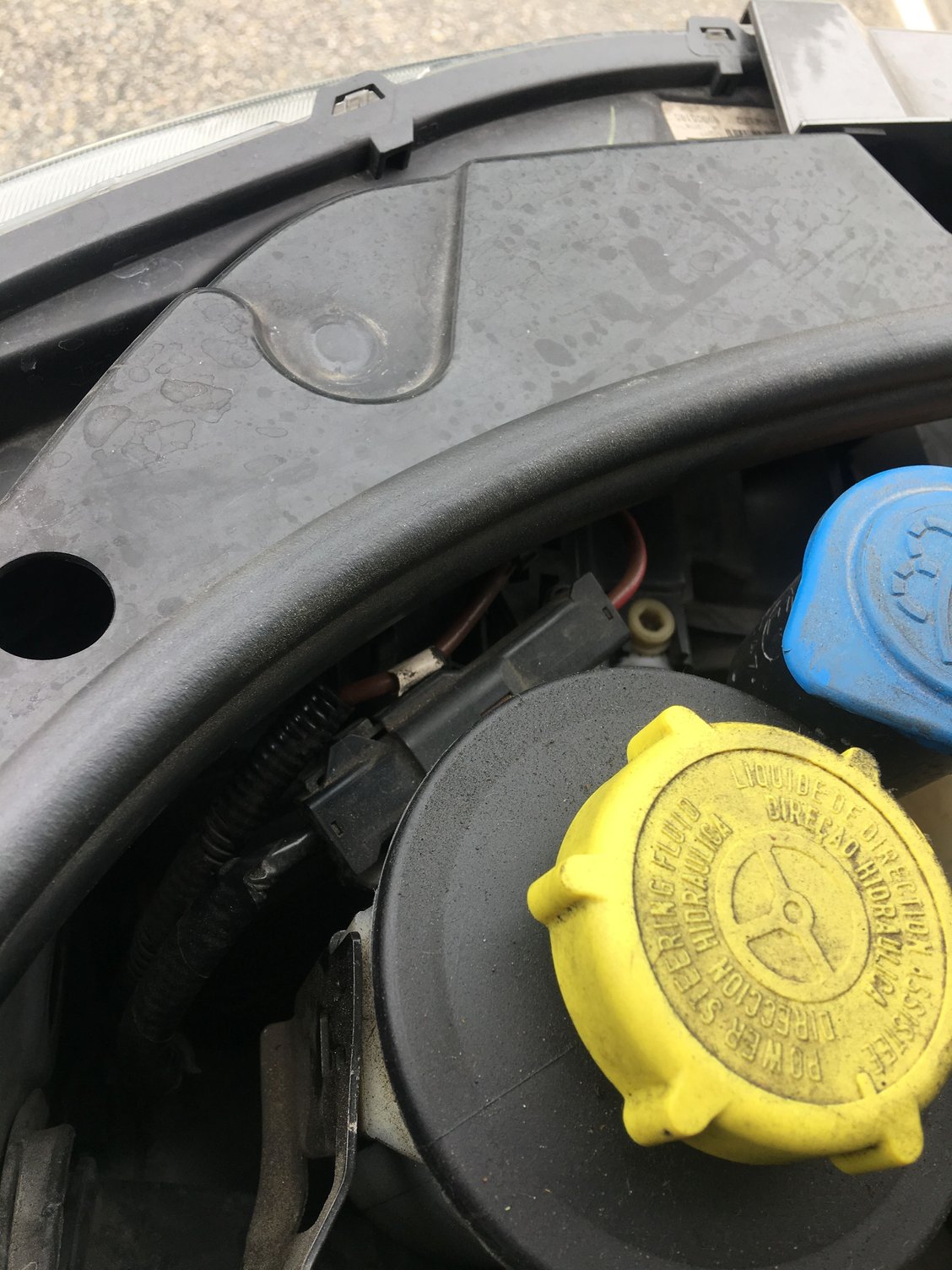

Also, how is this bracket supposed to attach to the body?

So to answer the first two questions, the connectors are the TPS receiver and coolant level sensor, which means that the coolant level sensor that came with the tank is plugged into the wrong connector right now.

Bump - any ideas about where that bracket attaches?

Which Bracket exactly? Also, can you upload your photos to this site?

The one in the 3rd link. The hood release cable goes through it and its supposed to be attached somewhere around the front left fender/core support.

It’s mounted to the bracket in front of the p/s reservoir and above the headlight

Thank! Now its just the suspension issue left to solve. I already tried a different relay and that wasnt it.
