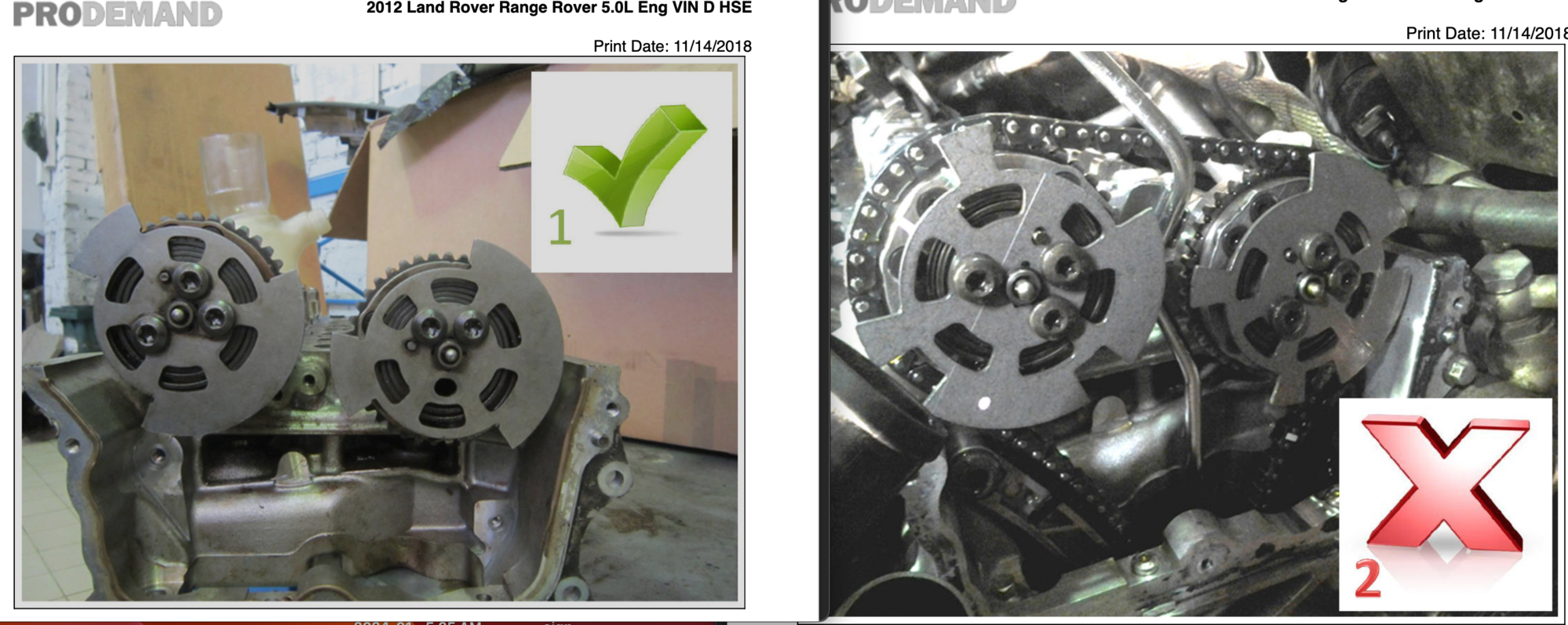

I’m not sure, but I believe that the camshaft pick ups on the jag motor are different than LR pick ups. If that’s the case, you will need to do a semi timing job to change them.
File Type: pdf
File Type: pdf
