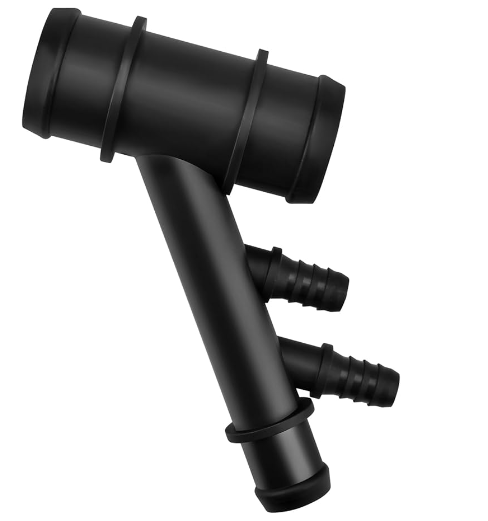

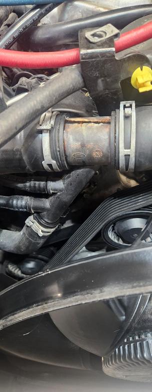

Installed the new fan and now we're blowing 42F in 95F+ so I'm good to go there, but during that I found the upper radiator hose connector had a crack the length of the fitting. So I replaced it and today went for a drive, stopped to get gas and smoke was pouring out from the hood. Pop the hood and the lower hose popped off from the fitting. I was able to re install it and I think what happened I didn't have the spring clamp quite in the correct place. Now it's at my in-laws since they were right around the corner. Spent about an hour trying to get the air out of the system. I had to leave it be to get to work, but does anyone have a trick to bleeding the coolant system quicker? I have a few ideas I may try tomorrow, but just throwing it out there while I was on here updating my A/C issue.
