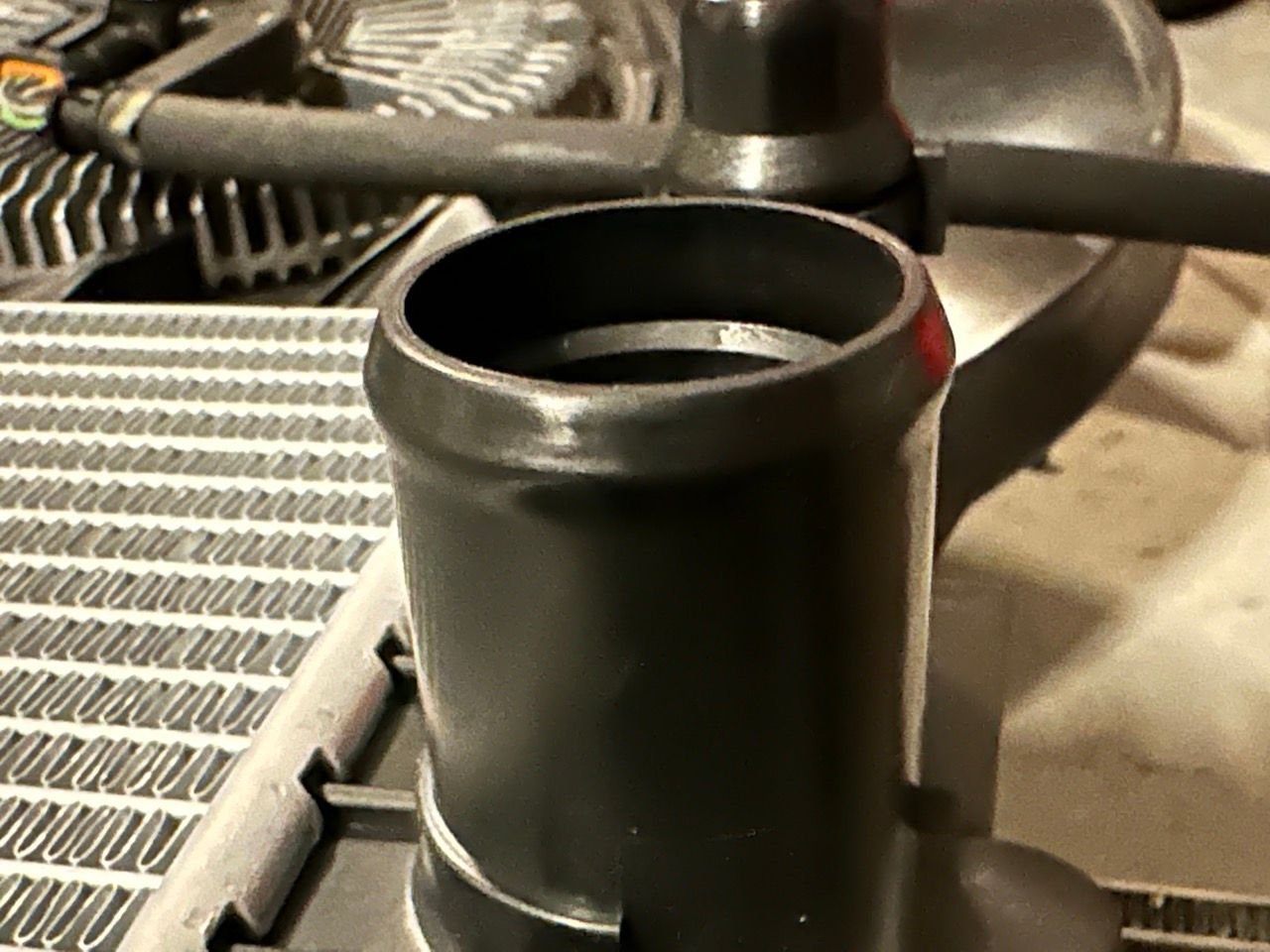

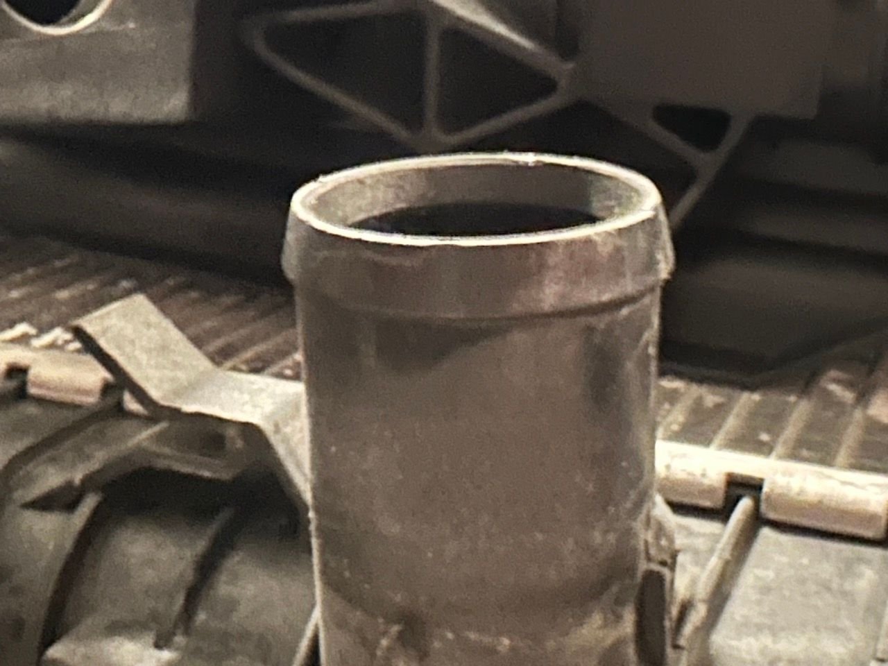

Managed to fit the Nissens and it works. Still unimpressed with the quality for the price. Also the mounting holes for the condenser and intercooler did not line up very well. If there's a next time, I'll either hope for the genuine to be available or go with Eurospare.
I didn't take all the pics I intended but here's one example of pipe flare differences. The genuine/Eurospare has the well defined flare to retain the hoses.
