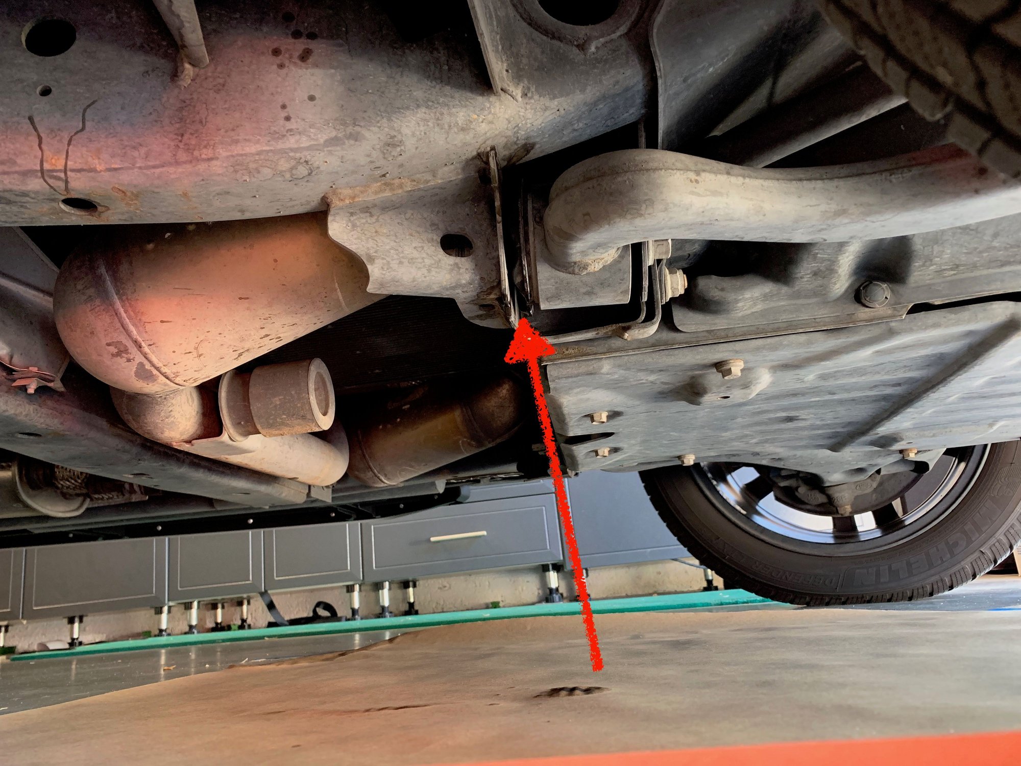

Took the car around for errands and I noticed 6 drops of oil on the garage floor. It was near the passenger front tire. I cleaned up the oil and did more errands and parked it. Again, 6 more drops almost within 10 minutes. First time I've seen any oil leak out of this thing.
It's covered under warranty but I was wondering if anyone had any guesses. I'm thinking this is a suspension issue. Thoughts?

If there is nothing above that, that is wet, its the bushing. Not sure its covered under warranty

HYdro-bushings, factory warranty will be covered. CPO warranty not as easy since it’s a wear and tear item. GL

You were right @abran. It was the bushings!
