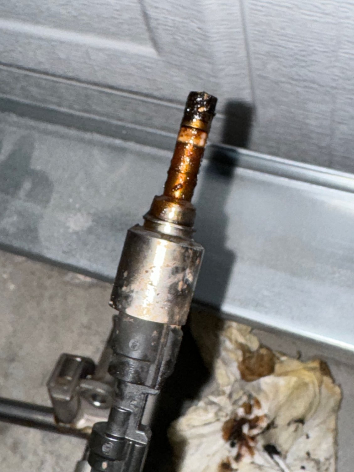

Job done. Short test drive engine seems smoother and quieter and more responsive. Tomorrow I'll go for a 100+ mile drive and see what happens. Based on the condition of the RH injectors I reckon it's time to do the left side...
Pic is of injector 3

A few hundred miles done and no further injector/misfires, acceleration's definitely massively faster and smoother and a random rattle on acceleration which the main dealer could never identify's gone ( I thought it was knock but no one else could confirm). When I get to the LH side, I'm certain it'll be further improved. Interestingly, the spark plug wear and colour on all three was identical and perfectly normal even considering they had done 100K miles, but the injectors were a different story from 1-3, front to back the first was decent though tip erroded and 1 hole plugged, the second one was dirtier and of course the third failed one, pictured previously was the worst.
