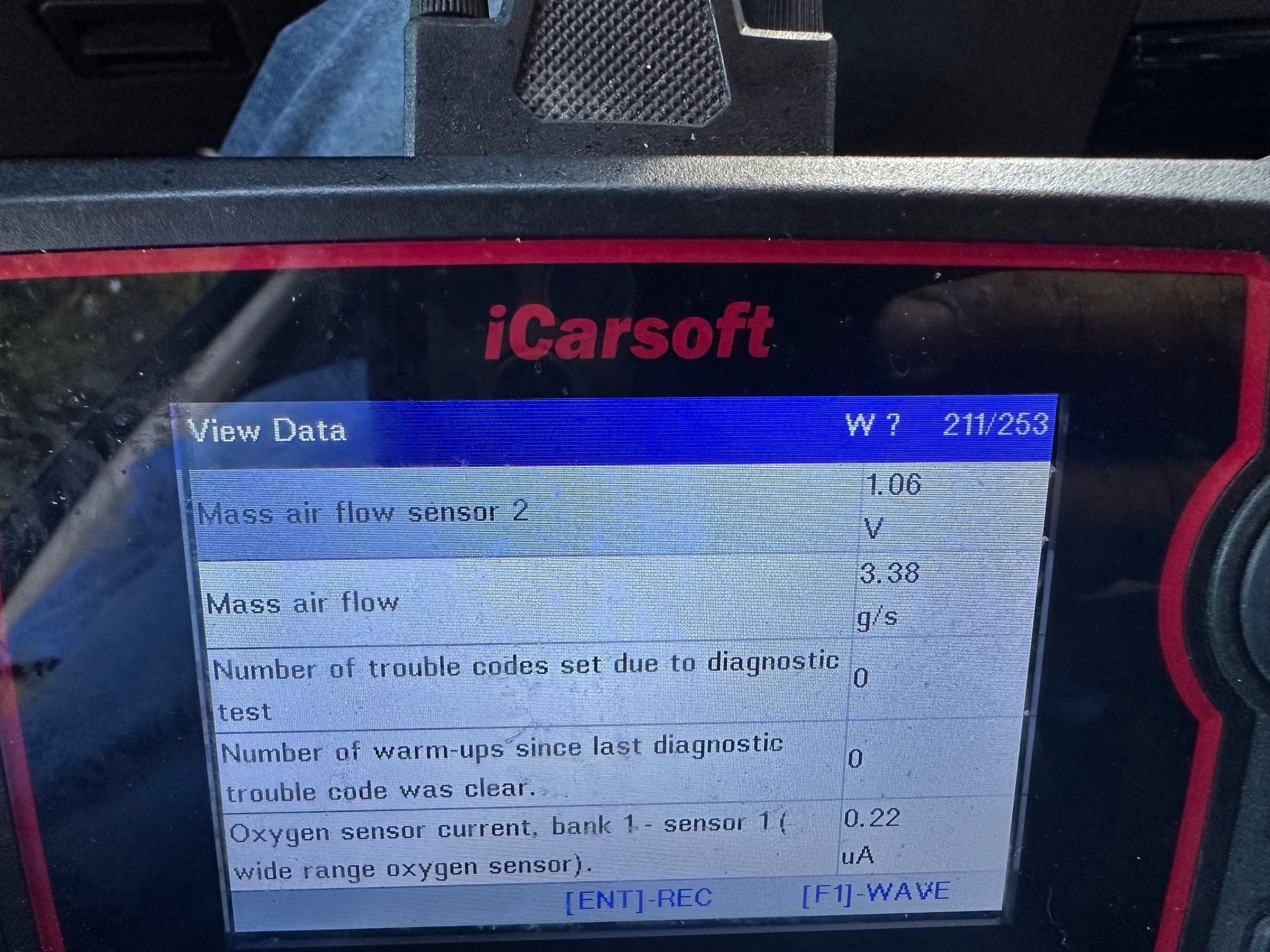

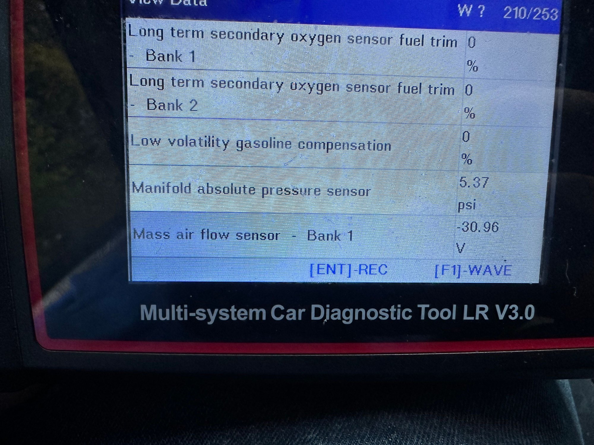

Old Apr 28, 2025 | 09:54 AM
malibumike's Avatar
Joined: Jan 2006
Posts: 31
Originally Posted by guy
-30v??
yes. Pictures uploaded. Switched mafs to opposite sides and -30 did not follow. Stayed on same side.
do I test reference voltage now?
