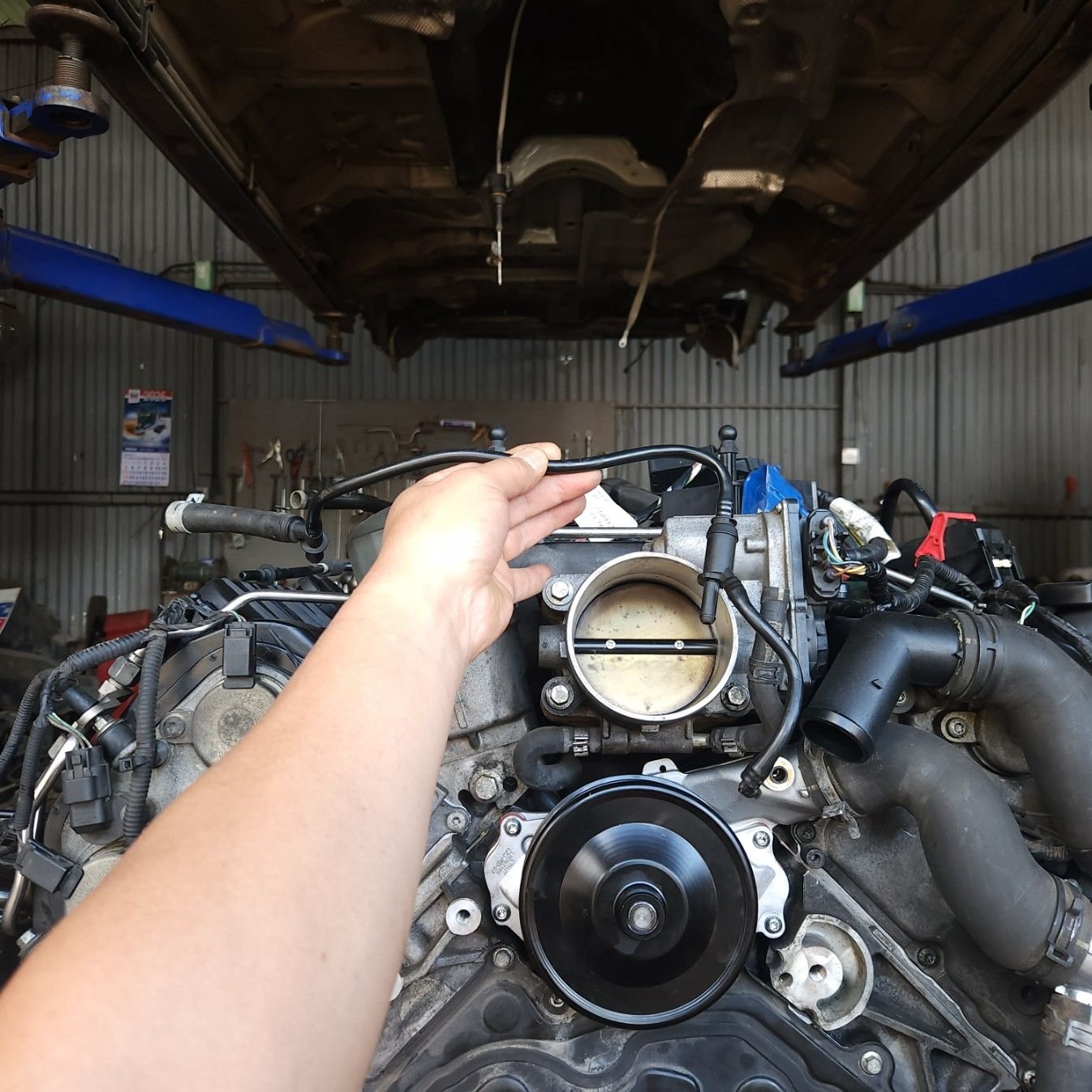

Hello, I have 2012 LR4 5.0 V8. I was changing Timing belt and during I found attached Hose tip is broken. I am trying to buy online but I can not get the right code. Can anyone help me to get part code and where I might be able to buy them online. Thank you.

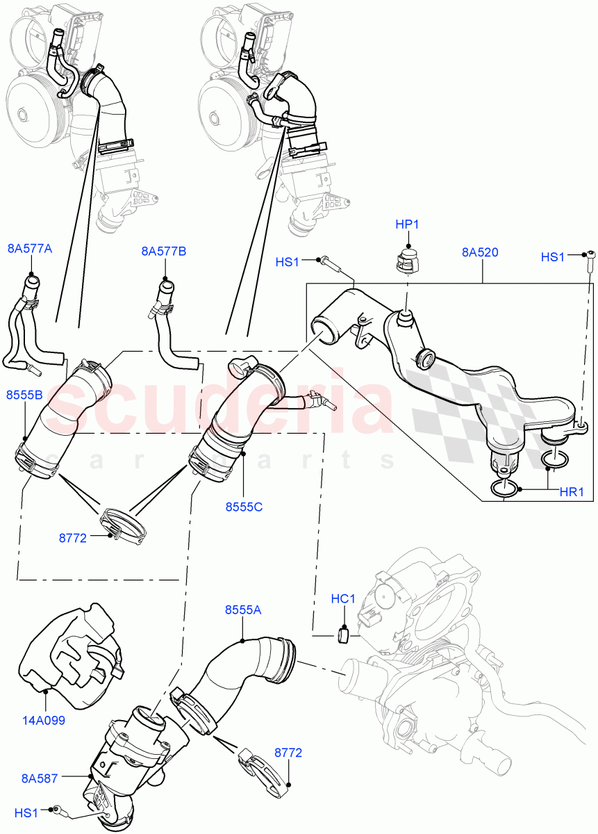

Looks to me like it's the hose that connects to the throttle body heater outlet
https://landrover.scuderiacarparts.c...470/4430/81648
8A577A = LR012636

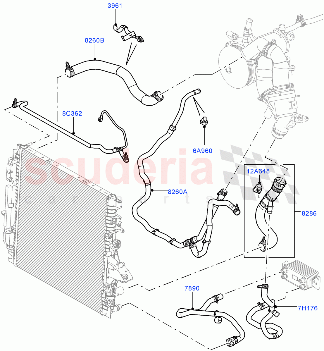

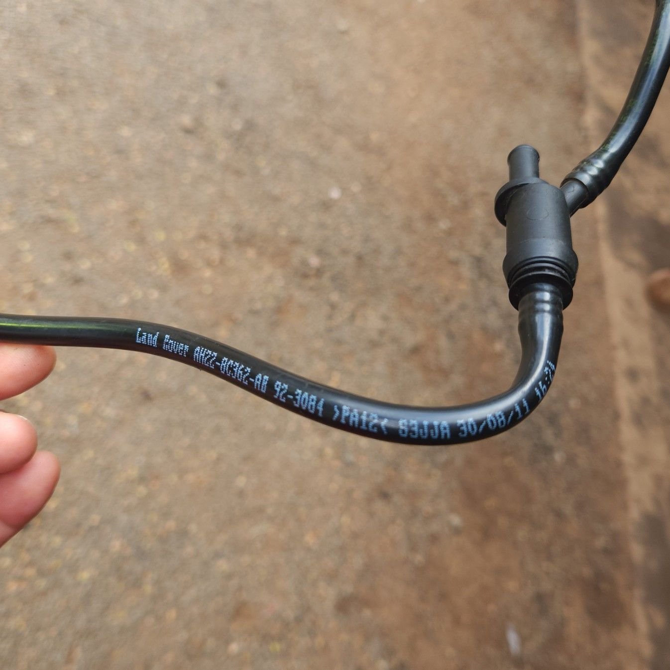

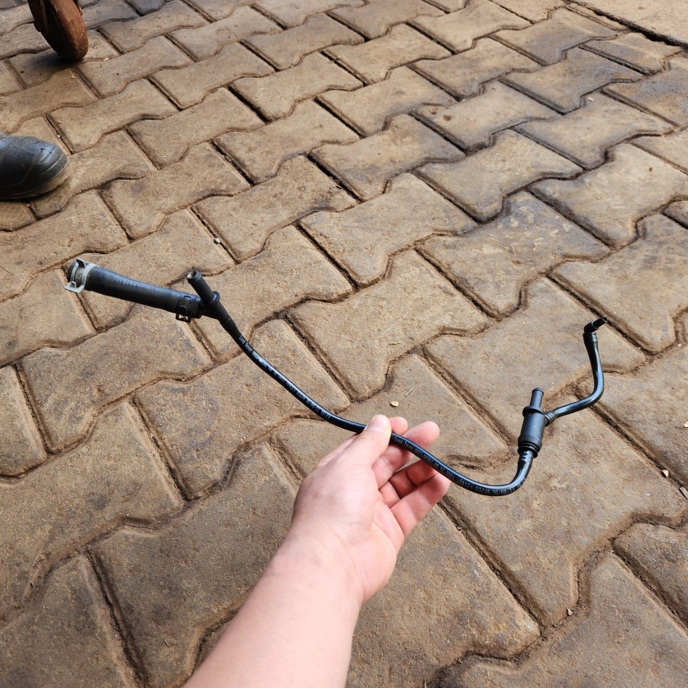

Not sure which part is broken, but based on the images you attached you're looking at 2 things -
Throttle body inlet posted above, and the Coolant Hose - Radiator to Expansion Tank
8C362 = LR013687
https://landrover.scuderiacarparts.c...3687/hose.html
