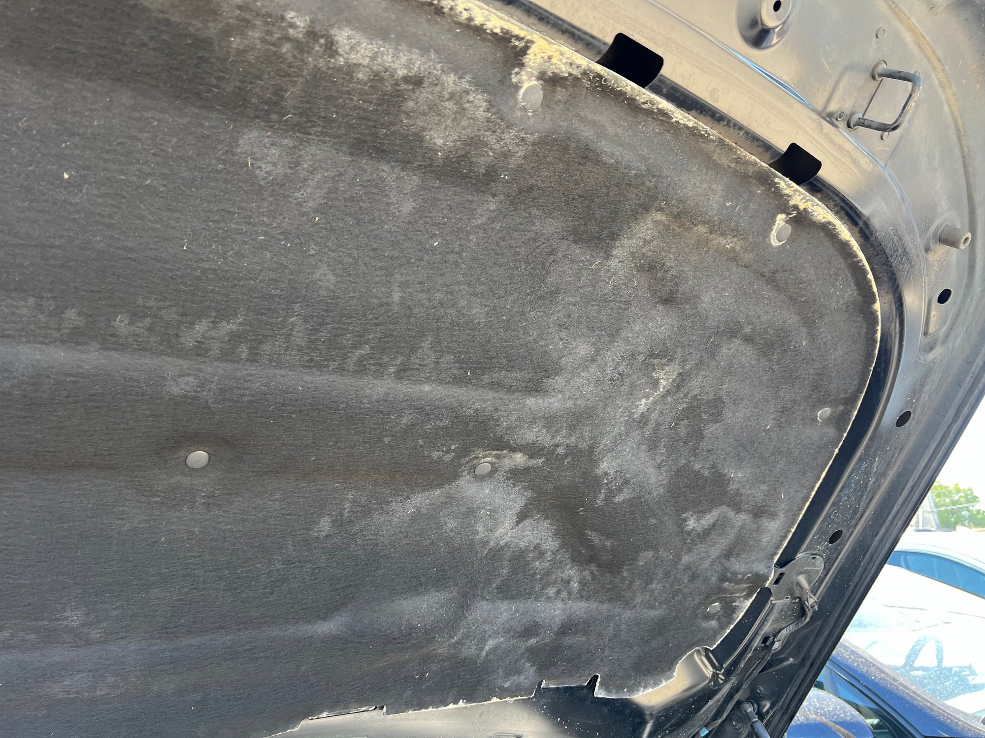

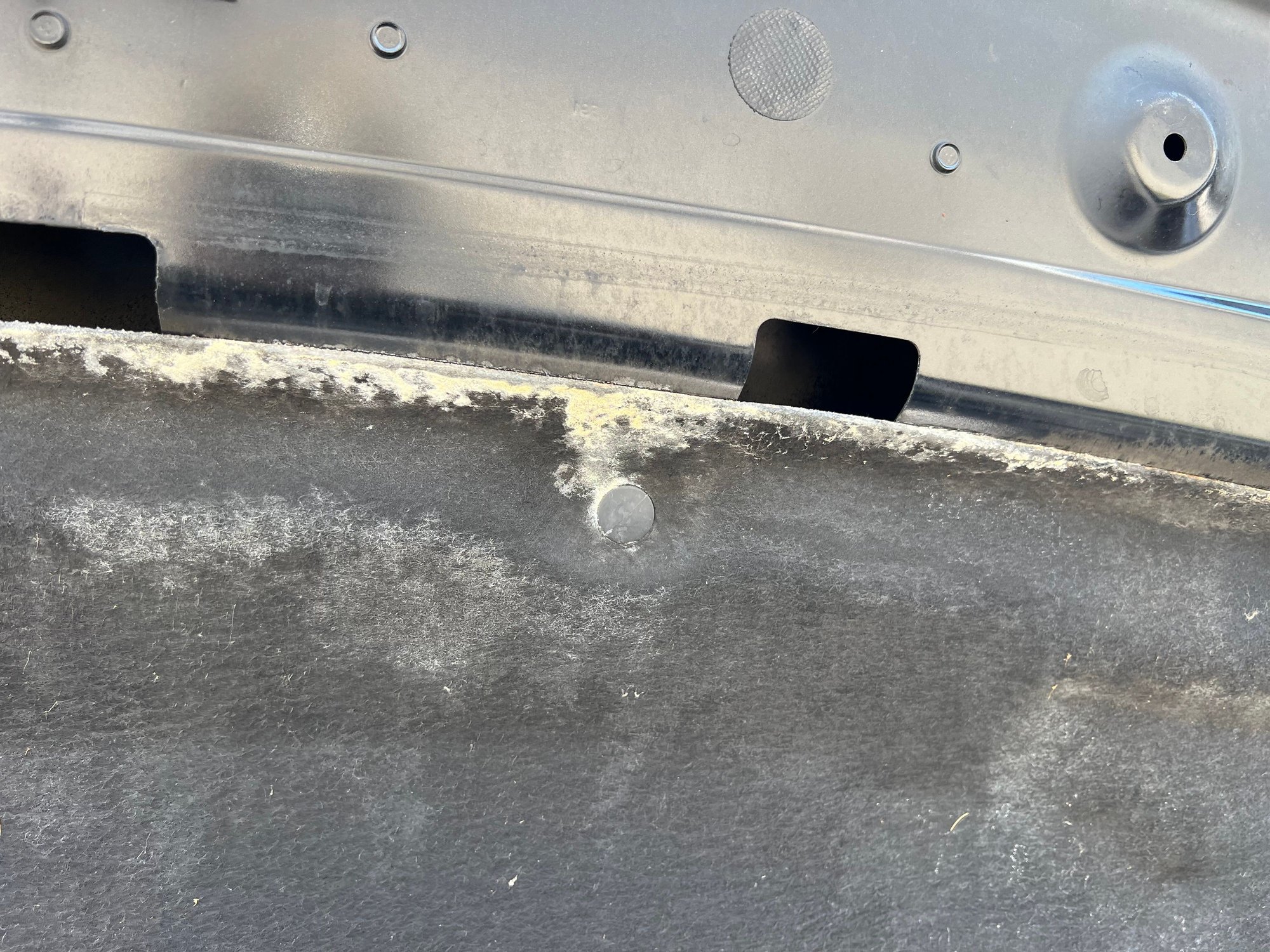

Hey all, I'm in Eastern Washington, Spokane, to be specific. Wife wants an LR4, and we've got a potential candidate. 2015, Lux model, all black, one owner, 118k miles. VERY clean inside and out, clean vehicle history report, runs and drives like a top. Only thing giving me any pause on this one is under the bonnet, there's evidence of a prior coolant leak. Coolant smells fine, no oil on the surface or scent of exhaust, zero gunk under the oil cap. Check engine light is on for a fuel pump which the dealer says they'll fix. I took a couple snapshots of what looks like dried coolant residue on the bonnet liner, and it looks a couple years old to me, but I'm not sure. I drove it for about 30 min during the middle of a hot day in Spokane (ext temps were over 90), AC on, and had my ultra gauge hooked up to monitor coolant temps. Took 15-20 min to get up to temperature, it got up to 219, then the thermostat would kick on and drop it down to 210-217. Drove a combination of fast and slow, uphill, down, and flat. Appears to be functioning nominally. And yet, the bonnet liner gives me some pause. Perhaps a hose blew, or the thermostat housing cracked at some point? Or is this a clear indication of a boilerover/overheat? Should I go for it and just make sure to get a warranty? What say you gurus? Thanks in advance!

Yes, if a coolant hose split (and they do at this milage) there would be residue. Shame it wasn’t cleaned up.
