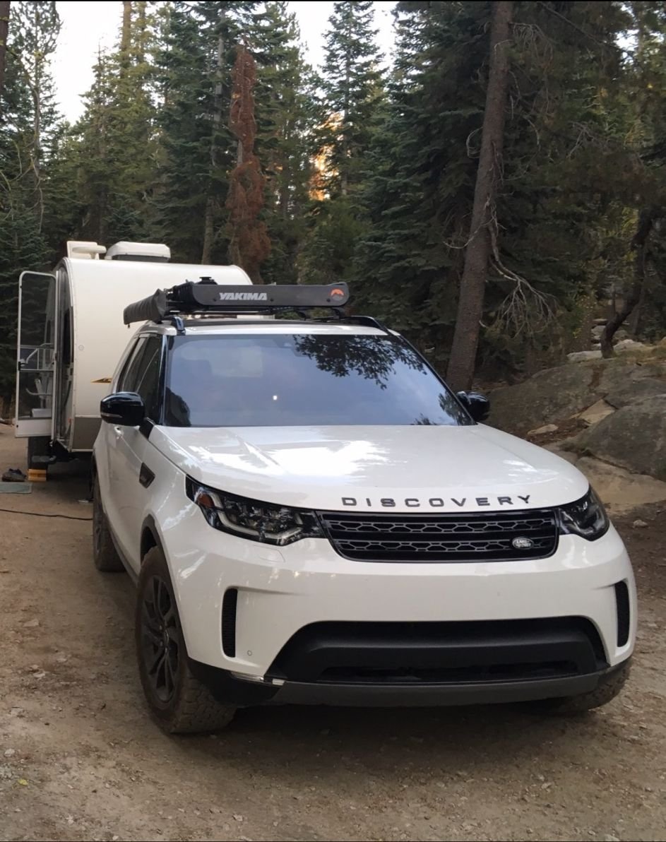

I think the lift will help it look better and give you more ground clearance which is always good.
the 275-55-20 seems to be a favorite with the 1.5 inch Johnson Rod lift.

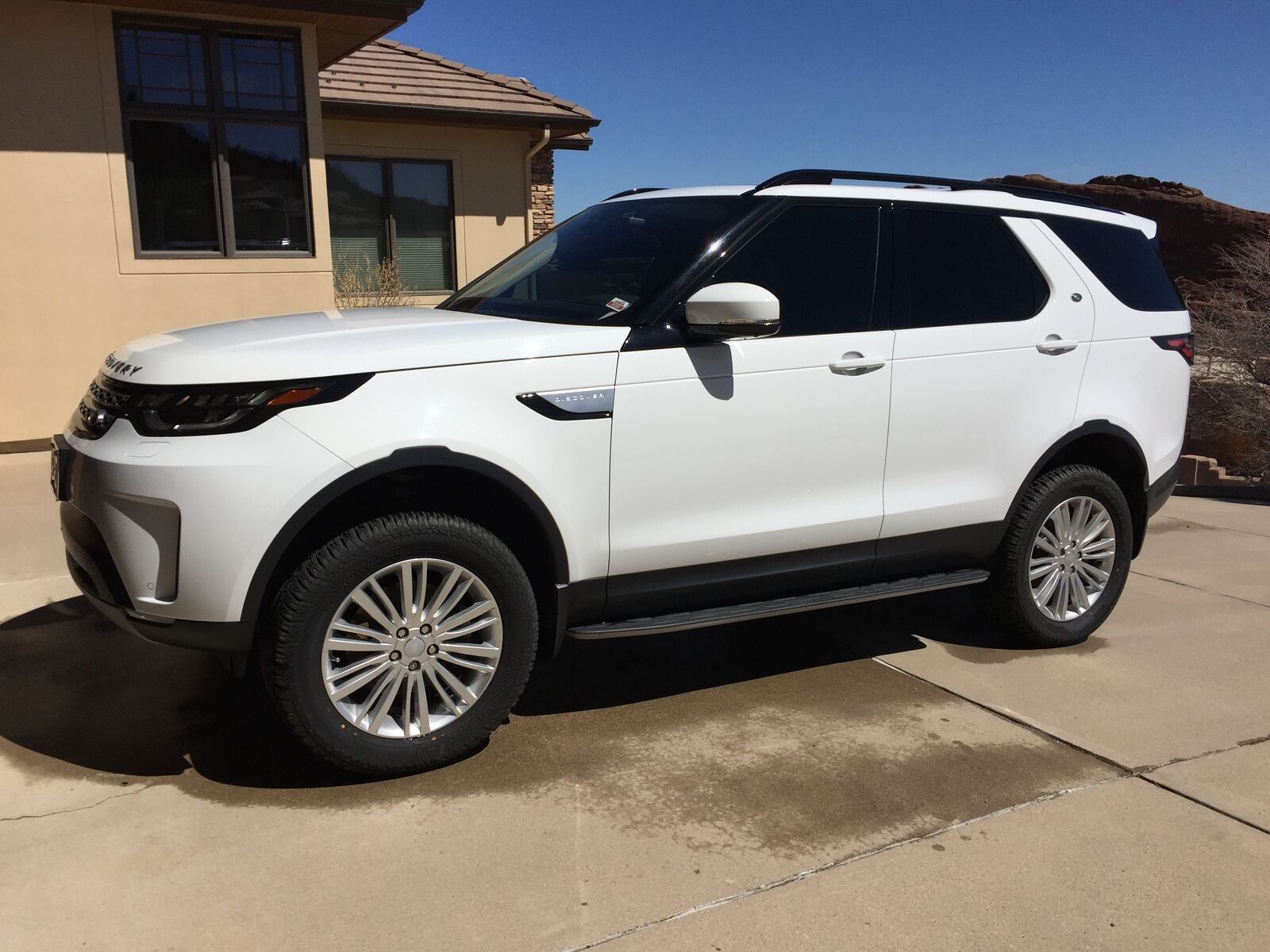

I got my new 275/55 R20 Yokokama Geolandar A/T G015 tires installed and then I installed the 1.5 inch Johnson Rod Lift Kit. It took longer to jack up and remove the wheel than it did to swap out the rod at each corner. Took about a minute each. I used a golf divot tool to pry the old rods off their posts after spraying with lubricant. I'll post some pictures after I get it washed. We keep getting snow here in Colorado.

Ponderosajack:
I think this is the picture of your Discovery 5 with the 1.5 inch Johnson Rod lift and the Yokahama Geolander AT 275-55-20 tires.
Looks great!
Johnson Rod 1.5 inch lift kit Yokahama Geolander AT GO15 tires 275-55-20
