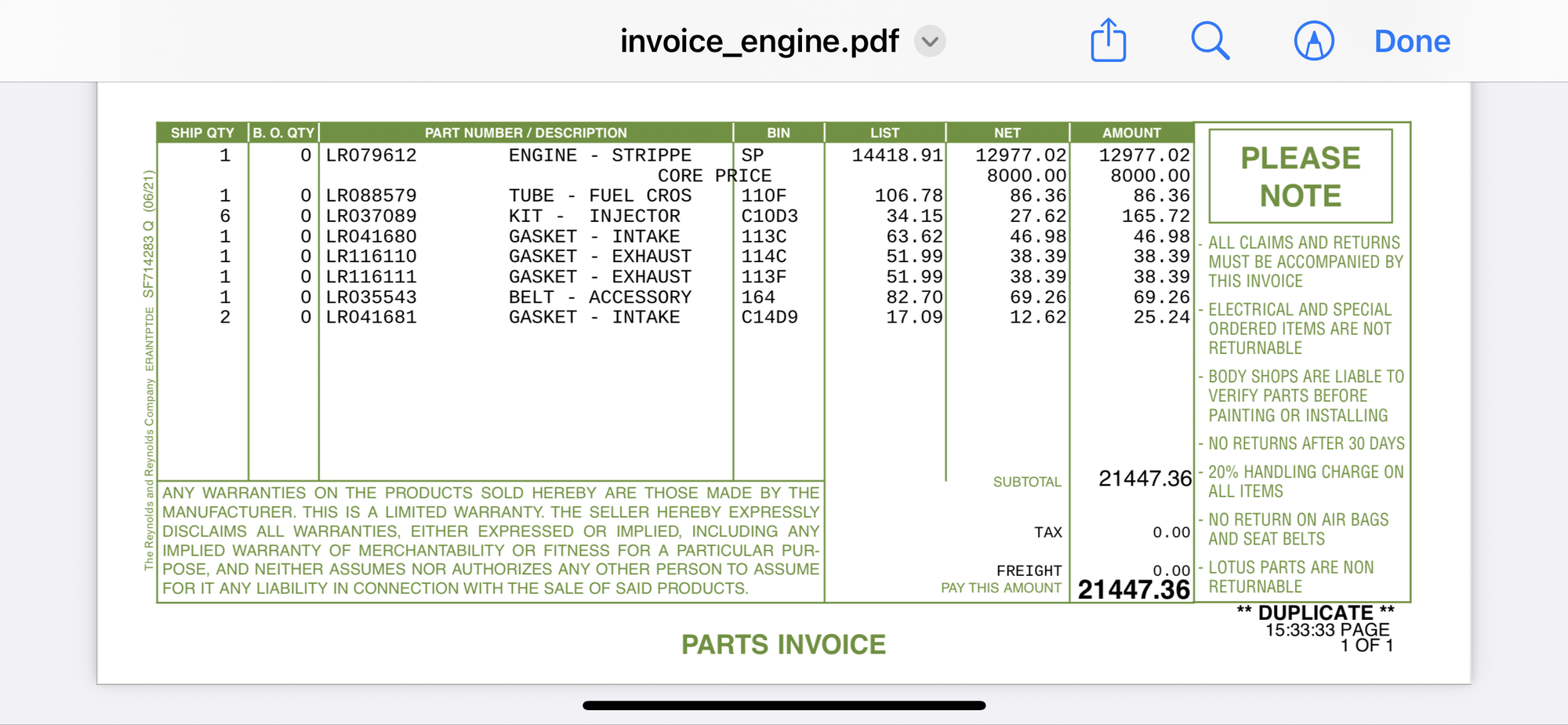

Old Jul 1, 2025 | 12:46 PM
OrdinaryDad1975's Avatar
4th Gear
Joined: Jun 2025
Posts: 4
Originally Posted by abran
Double confirmed. That part number comes up as new.
does the invoice look legit and make sense?
Old Jul 1, 2025 | 04:19 PM
abran's Avatar
Posts: 6,914
Likes: 792
From: Huntington Beach CA
Besides no JLR logos, yes. But they didn’t change anything while in there like coolant parts, pulleys, injectors, etc.
Better than an OG miles motor though.
get a PPI.
