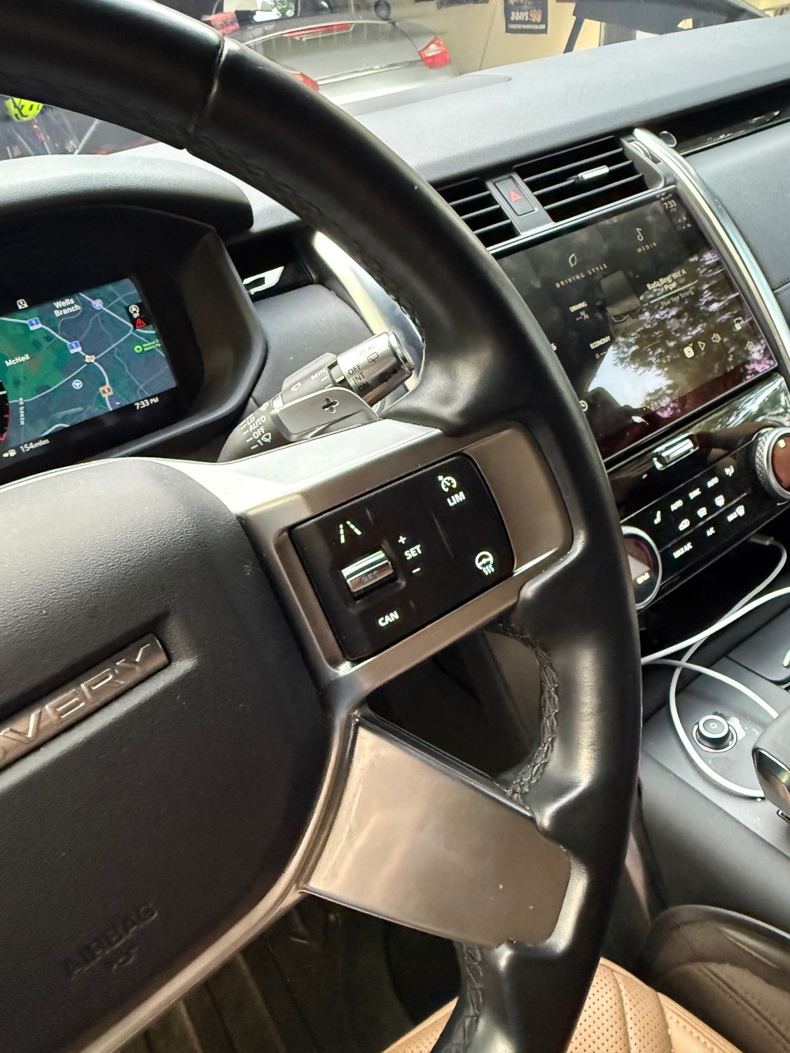

I’m seeing videos online of using the GAP diagnostic tool to add ACC to new Defenders with just the tool - is this possible on non ACC equipped face lifted Disco 5’s?

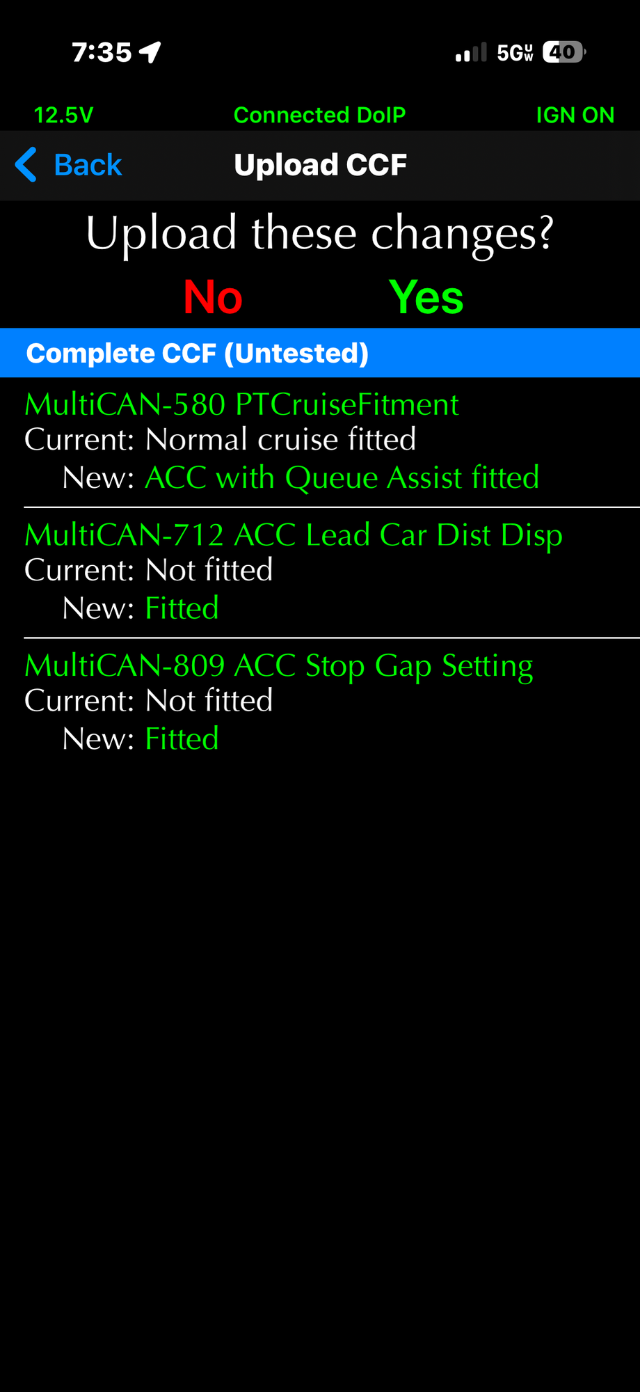

Reached out to GAP and they confirmed the tool would activate ACC without any additional hardware

yes confirmed the gap tool unlocked ACC with the following files:
