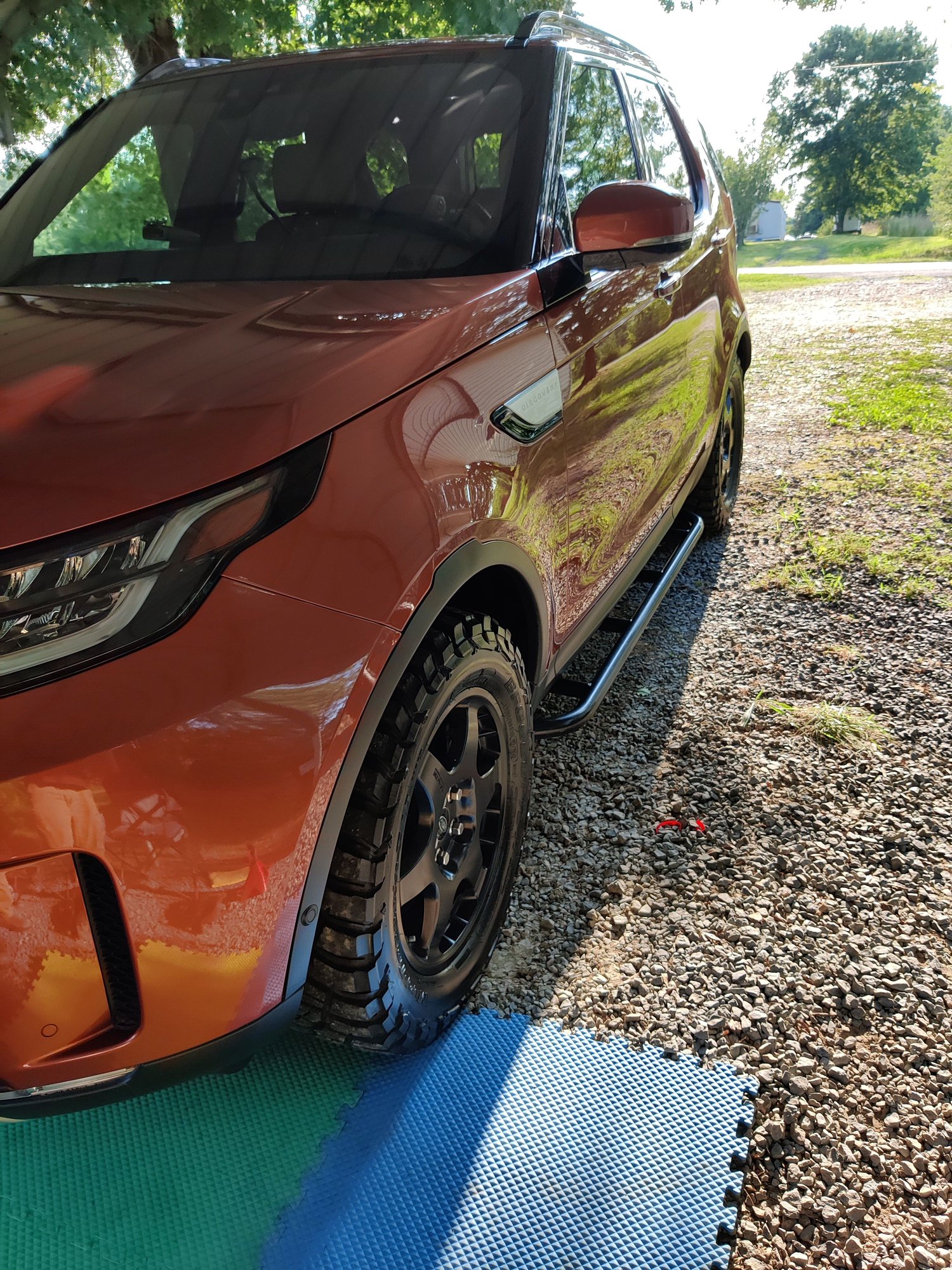

I am running the COMP wheels from Lucky8. I bought new TPMS sensors that work fine. I have 2017 TD6, has the smaller brakes. But I still have to grind 1/16" off the rear caliper to fit. Easy fix. I'm on 265/60R18 KM3,s Mine came with 1.5" rods. but not needed for 265/60R18....... I'm leaving the rods, because I like the look a little better.
my build thread: https://landroverforums.com/forum/ne...se-lux-100045/

Looks AWESOME! I really want the comps but for the price I'm ehhh a bit more hesitant. I can get a set of 5 steel wheels 18'' for pretty much $900 Shipped and $200 of that is shipping. I like the COMPS though because they would be lighter but for 5 of them is $2000 for just the wheels from Lucky8 shipped. I was going to plan on reusing the factory TPMS sensors since my current tires are almost shot anyways or will be by winter.
Did you purchase new Factory Sensors? or Aftermarket that work with LR? If so where did you get them?

Titan TPMS sensors I saw in another thread. Here is the link to what I purchased.
LR GX631A159AA 433 Mhz TPMS tire pressure sensors for Land Rover$112.00 US I ended up calling to get the correct part number.
Have your tire store, activate or wake them up. 5 minute down the road they registered and are working fine.
