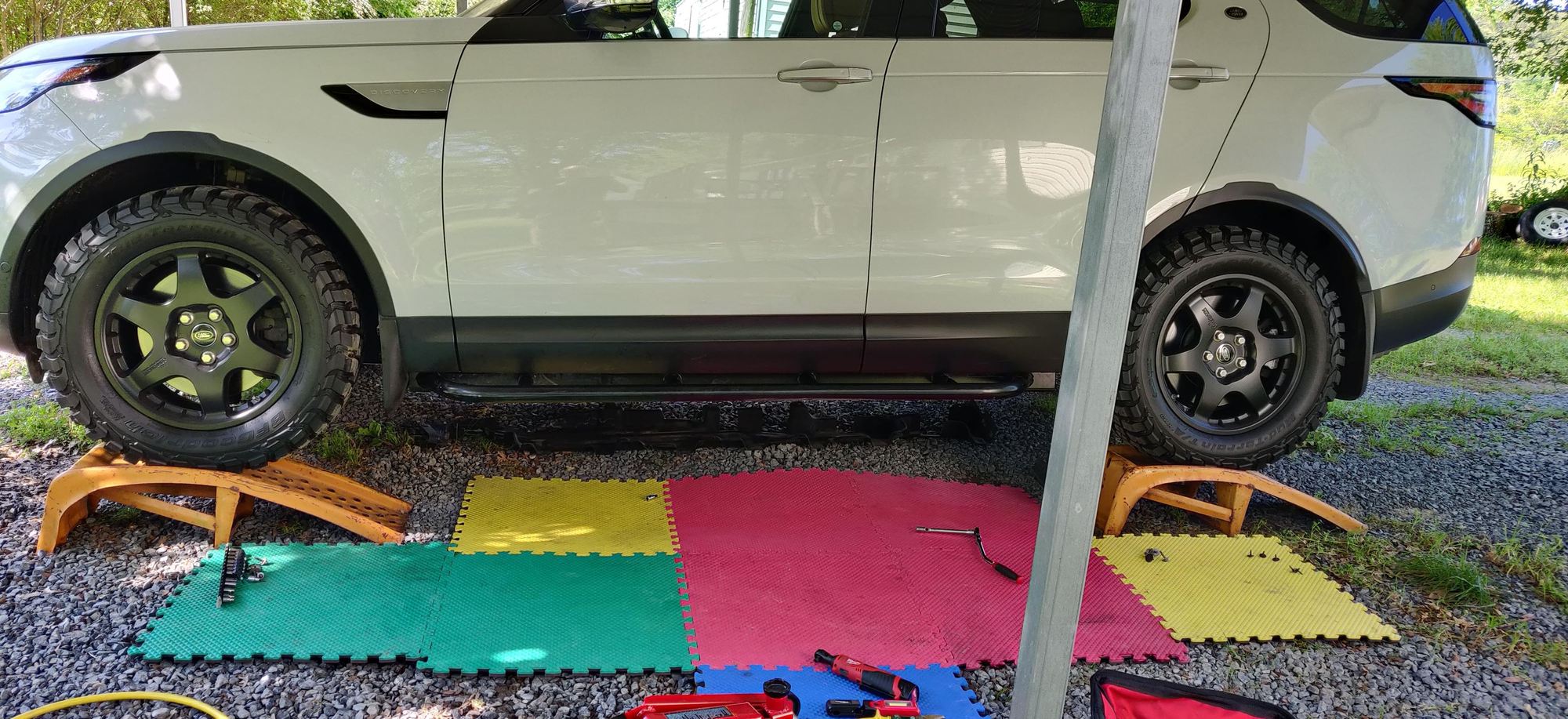

Going to try and document my D5 upgrades.

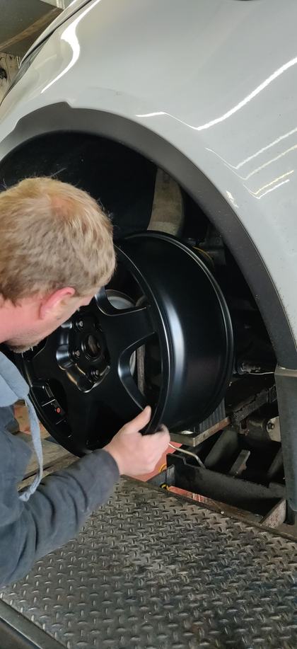

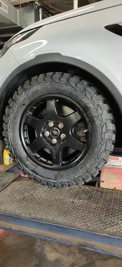

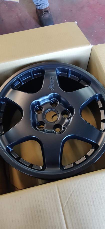

First Up is the 18" PD1881 Compomotive wheels From Lucky8.
I paired them with the BFG's KM3 Mud Terrain Size 265/60 R18---- 30.5 Tall 10.4 Wide, no rods, no tire rub.

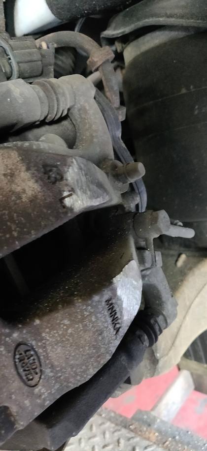

I will say make sure you have the smaller brake calipers, and even then there is a chance you will have to grind a 1/16" off the peak area of the rear caliper. I had to.
Thanks to Lucky8 .... Great folks!....https://lucky8llc.com/

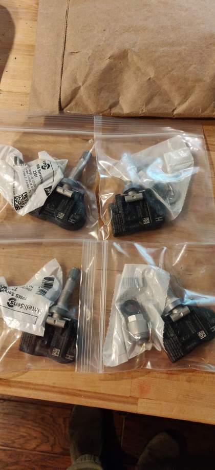

I will also add this about the Compomotive wheels. I opted to purchase the Titan TPMS sensors I saw in another thread. Here is the link to what I purchased.
LR GX631A159AA 433 Mhz TPMS tire pressure sensors for Land Rover $112.00 US
Have your tire store, activate or wake them up. 5 minute down the road they registered and are working fine.

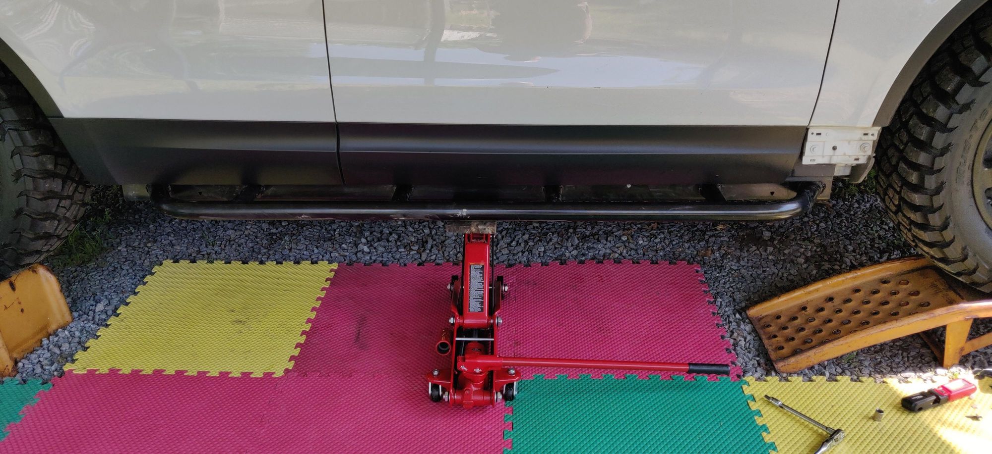

Sliders going on tomorrow.
Had some shipping issues, but Lucky8 came through!
WWW.Lucky8LLc.com
Old May 15, 2020 | 10:37 AM
They are not light bring a floor jack to the install party

Install went well. I opted to eliminate the debris shields. For a mud buggy like this, they are not needed. Its 96% covered with 3/16 inch thick steel.

The sensors are fine. They sent me the ones to order, I also was confused with their website. Have your tire store "wake the sensors up", or your Disco won't find them.

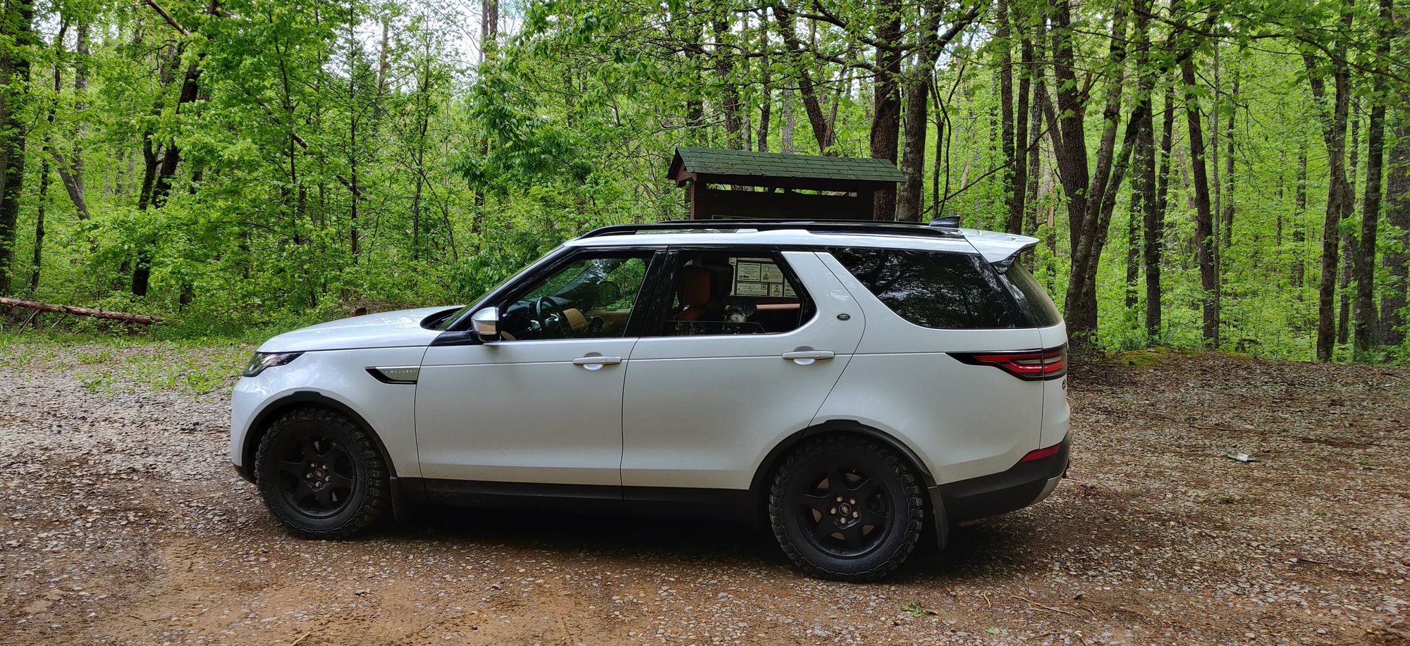

In the mean time here are some shots from the trail.

Looking great! I'm wanting to add the winch tray, too. But I'm really concerned with how involved it seems to be. I would absolutely appreciate as many pics as you can take along the way!
