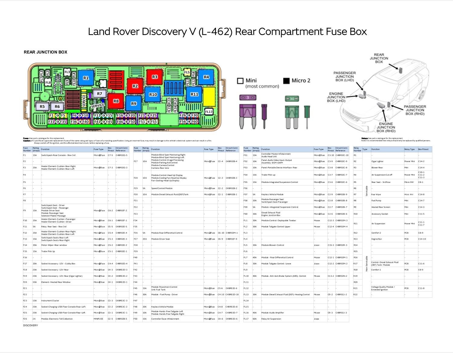

The original version of this basically was giving the wrong description. There are so many types now they actually are calling these “micro2” fuses. (Some people are calling mini fuses, micro fuses, which is why I got the wrong order initially.) So I edited that and I gave examples as well as a title. (I had to physically verify what kind of fuses they were because the iGUIDE is worthless.)
{I do not own this art, nor the rights. If it’s owner, needs it removed; please let me know.}
PDF version available for the asking.
