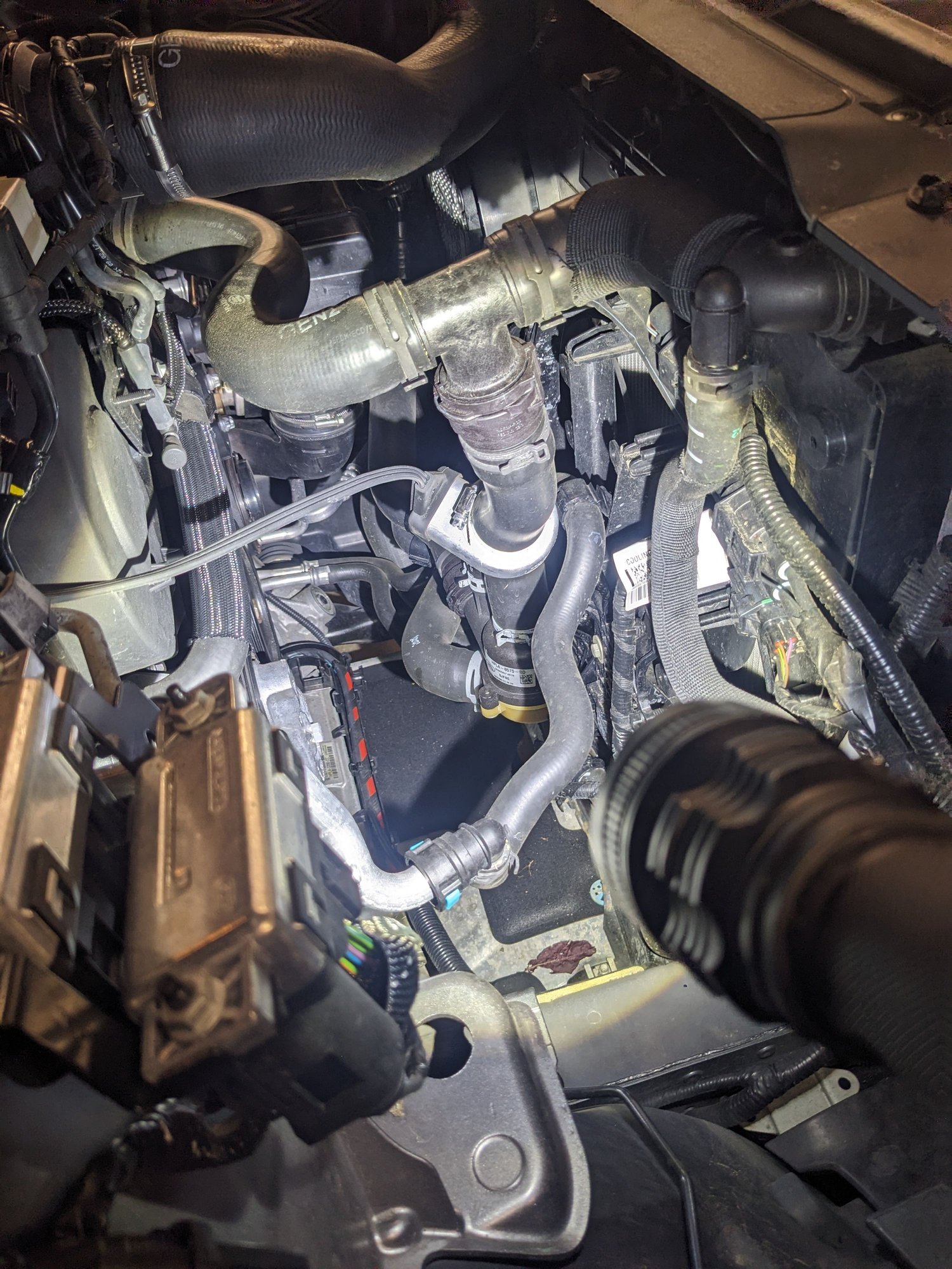

[QUOTE=freeman09;882353]Thanks for the replies and help! It is much appreciated. I ordered the Zerostart, given that the OEM parts looked like a great setup but weren't worth the premium.
Regarding refilling on coolant, is there a particular procedure for the TD6 regarding bleeding the reservoir afterward? I'm coming from a decade of BMWs with a built-in auto bleed process you could access.
Thanks again for the help, and have a great weekend![
[img]https://cimg9.ibsrv.net/gimg/landroverforums.com-vbulletin/1500x2000/pxl_20231118_204915865_8eaee6d1631d55071c069824327 b4d36f5a3f4de.jpg
I don't recall losing much at all. I opened up that bleeder let it run and kept adding coolant until it was full.

Thanks for the pictures and additional info! It is very helpful and I’ll follow-up once my install is complete!

Thanks again for the help, especially from RyanLR3, for the pictures. I completed the installation of the Zerostart last week. I bought an extra hose as backup and some OEM coolant. The installation was straightforward. The hose was a tight fit, but I ran it under hot water, which helped me fit it over the heater ends. I have the cord under the hood, like RyanLR3's picture, but I aim to route it through the lower bumper like the OEM kit. I'll work on that when I have more time and it is warmer.

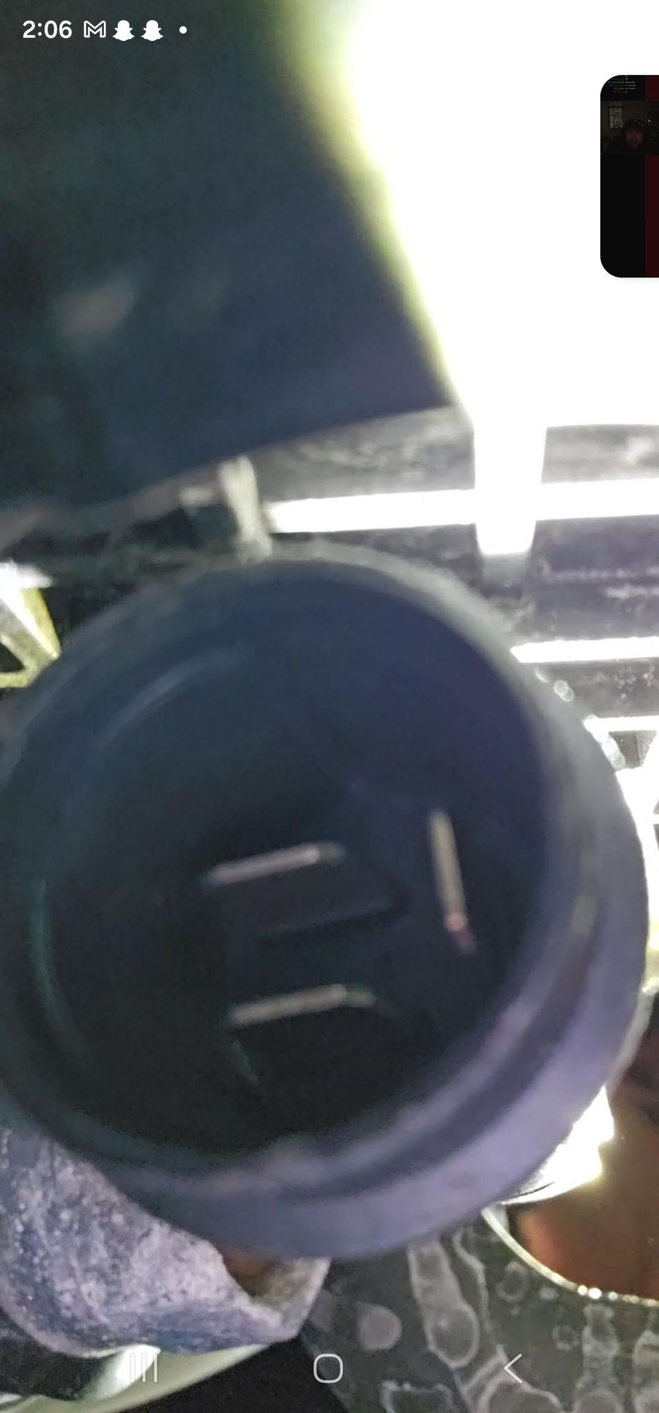

I know this is an old post, but which 3 blade receptacle did you get for the OEM block heater extension cord? Do you mind sending a photo of one that looks like it because i am not spending $800 bucks for 2 wiring harness's.
But no problems with it drawing too much power etc?
I never routed mine to the bumper. The heater cord on mine is long enough to run up to the front windshield cowling. I just run my extension cord up there.
Which extension cord do you have to plug into it? this is my outlet from the "heater" itself (photo below). I don't want to spend $800 bucks on the harness's lol.
Sorry, mine has the zerostart block heater (above). I thought you did as well. I don't know what you have pictured

tss118's Avatar
Joined: Apr 2025
Posts: 10
From: Alberta
The OEM is Calix branded from FInland.
https://calix.se/experts-in-vehicle-...ngine-heaters/
You can find places in Europe to get a cord sent over.
I actually used a DEFA miniplug kit I had laying (you can get them at pretty much any dealer in NA) and then picked up Callix-Defa adapter plug.
