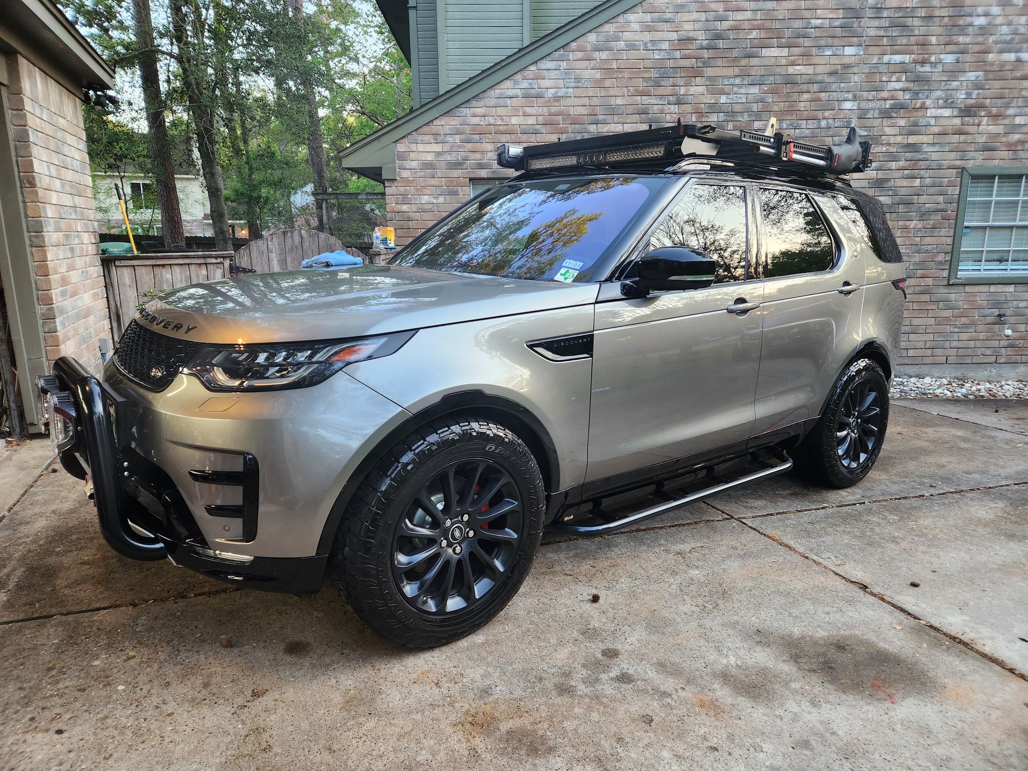

I am a little over a year now with the windshield sealing tape on mine with no further issues. My screen was redone by the dealership before I purchased it in 2021 but I still noticed some slight leaks during heavy rain. Nothing since I put this on and we have had some heavy rain over the past year here in the Houston area. I would still get the windshield replaced/repaired if possible, but I put this on just for a piece of mind. The tape blends in really well and does not stick out.
Same tape that DVD linked to..
