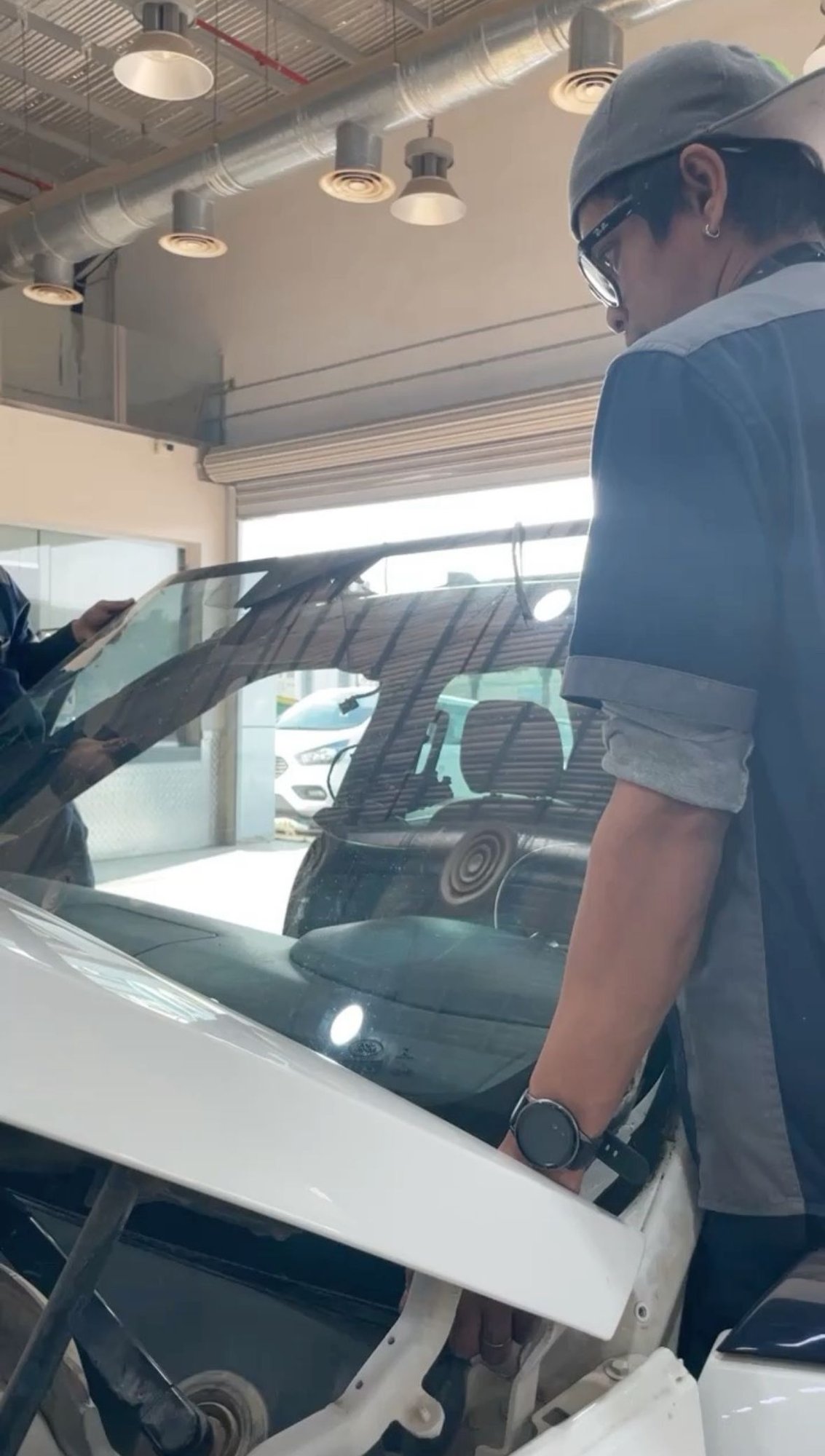

I had this and the dealer said to change new windshield. I went to a shop and just changed the seal and for 3 years there’re no leaks.
the issue is in the upper side seal, check the video.

What is unacceptable is the windshield is almost certainly placed at the factory by a robotic arm that dispenses the glue. Seems like an easy fix. So why does the problem persist?
exactly, and i don’t understand why they were saying the windshield needs to be changed, a waste of time to the client and money for them.
mine was repaired by an independent shop by the dealer. The indy shop told me they would first try to remove, repair and replace but sometimes they need to put in a new windshield. In my case, the repair worked. I suspect the dealer just doesn't want to waste time on trying to reseal it and see if that works. So they just go to replace. After all, you have an LR. You can just throw money away, right?
