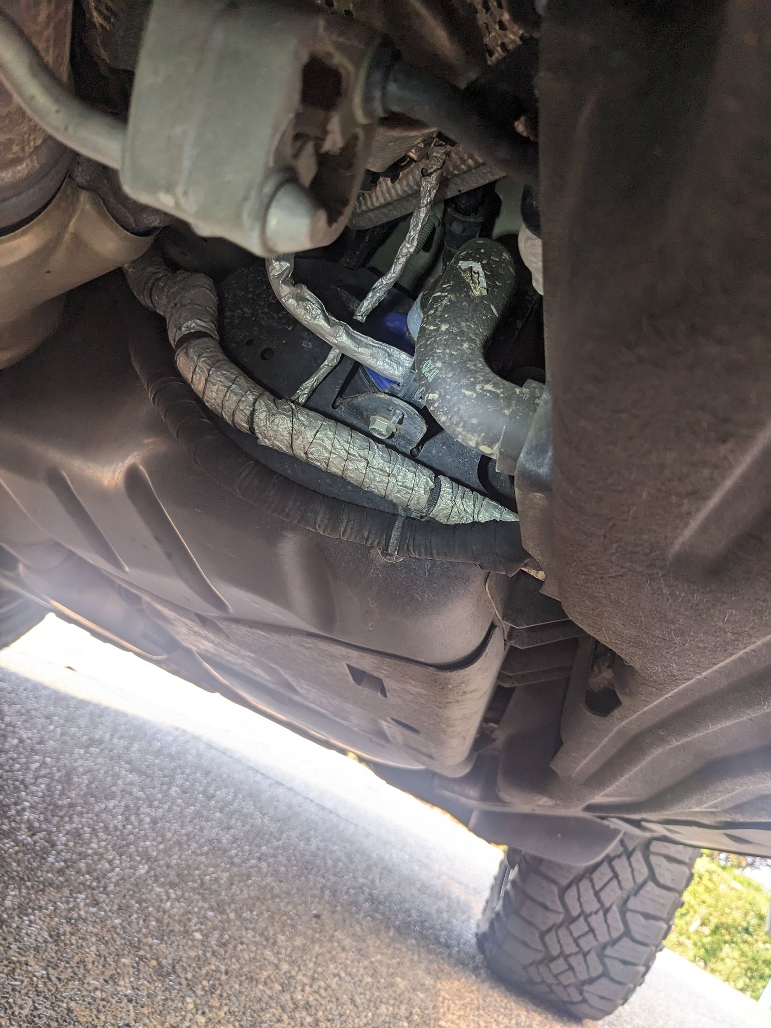

It's not under the front fender. It's underneath, LH side just rear of the DEF doser. It has a steel shield covering it. The picture shows the filler pipe entering the tank.

Default Drain DEF
My DEF tank is located in the same place as in this picture. Midway back above the injector. To drain the tank, is there a drain plug and where do you access. Or, do I have to unclamp the intake hose and pump the DEF fluid out?
