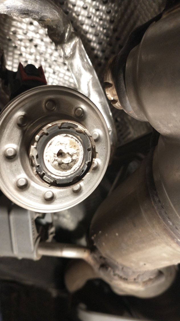

Hello,
Yes, my issue resolved exactly as everyone on the forum described. If you’re having the same issue described in this thread, then the DEF fluid is not bad. The injector is clogged. It’s easy to detach the injector and clean it. You will need an onboard diagnostic machine(OBD, II). Once the injector is cleaned, you can clear that message with the OBD. Then, messages will switch to several NOX sensor error messages. However, with enough driving, you will eventually be able to clear those messages with your OBD. A local foreign automobile mechanic told me, which was exactly the case, that it takes 20 miles of driving at over 60 mph. You can easily find videos on YouTube for locating and removing the DEF injector.

Thank you for that!! The injector was the first thing I looked at and cleaned the first time I tried to fix all this. Here's what it looked like. It's a whole lot prettier now.
Something curious though.... While I had the injector out I tried to test it but starting the engine to check spray pattern and all but I never saw a spray. I sorta think that it's not going to activate until the nox sensor calls for def but I just don't know that for sure.
About clearing the codes after driving 20miles. Were those the permeant codes or intermittent codes?
