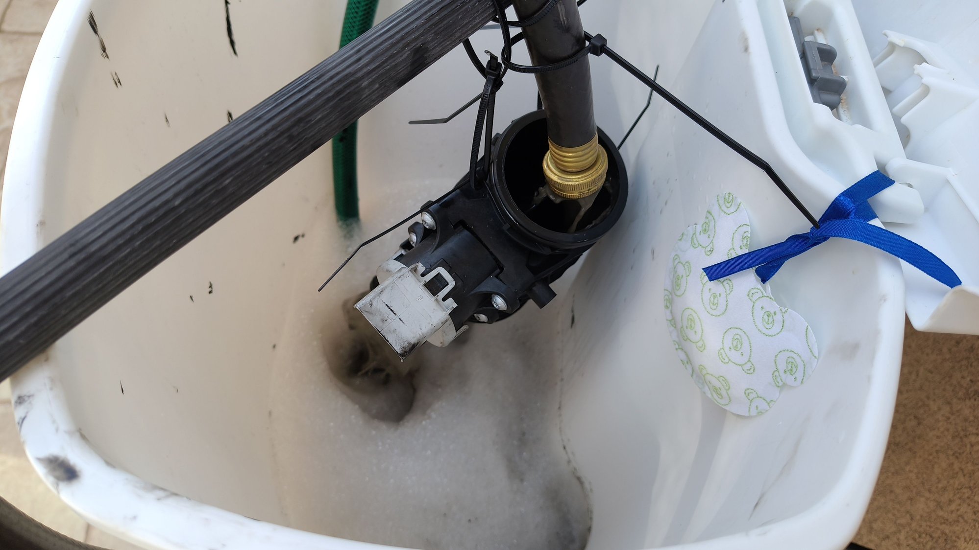

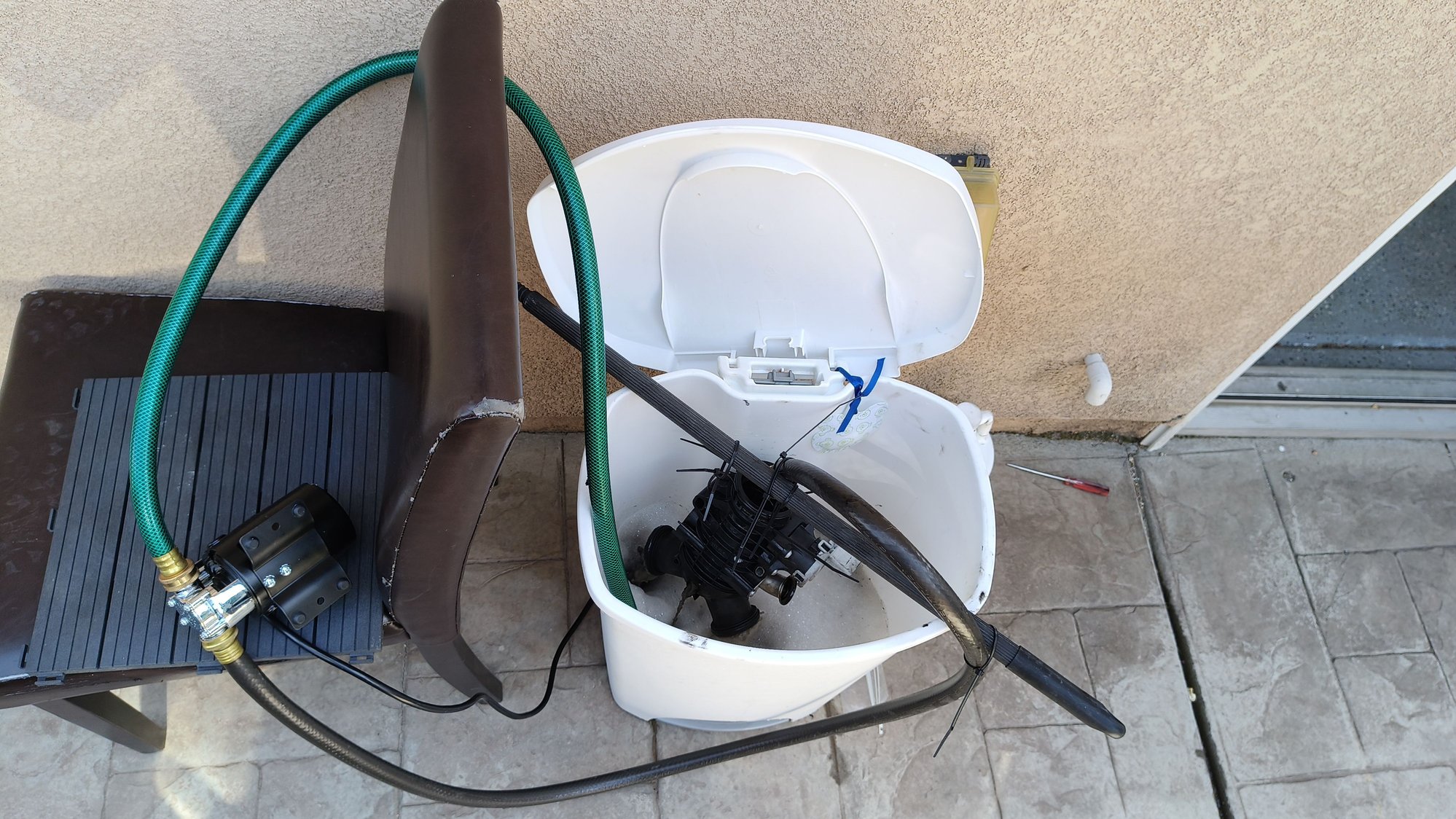

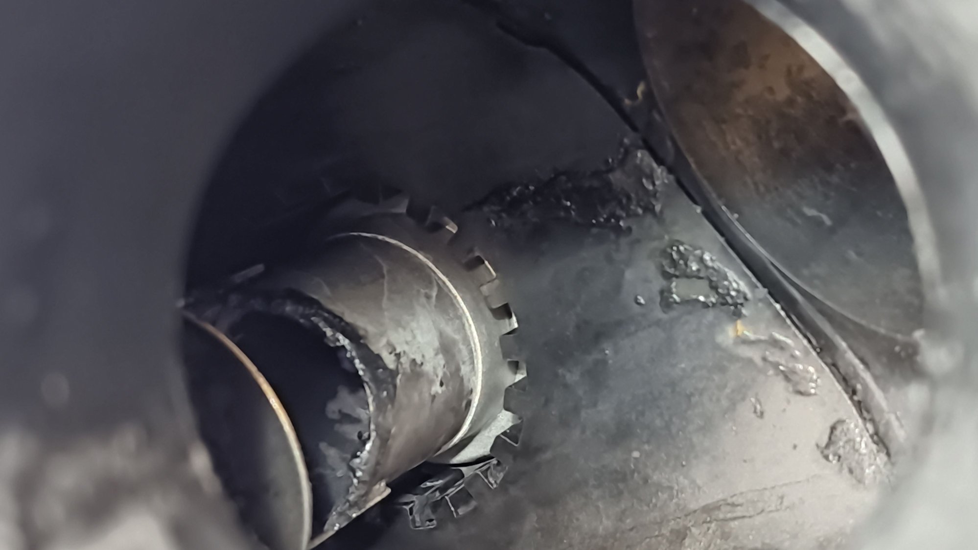

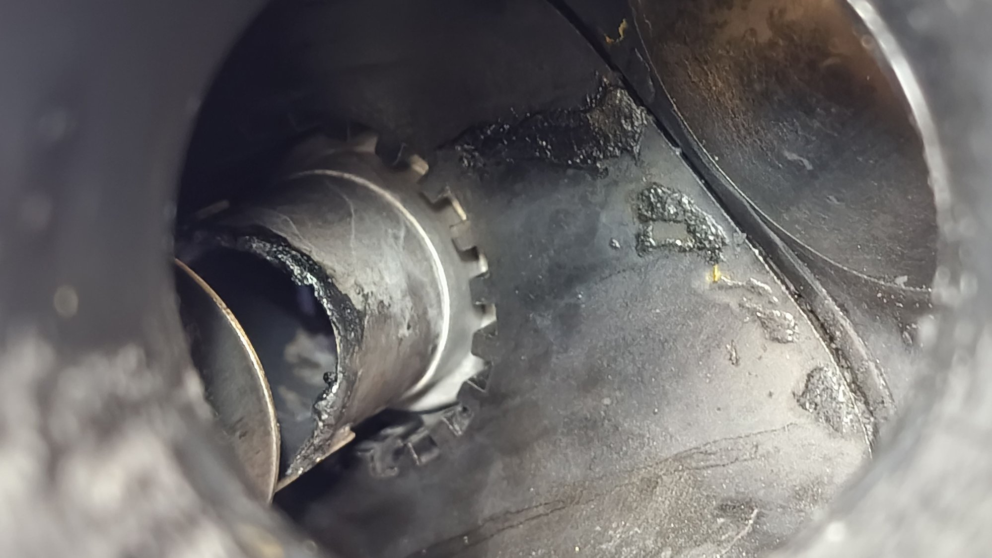

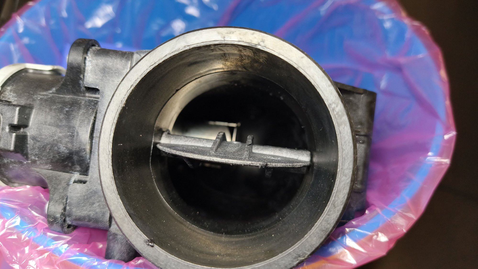

Resurrecting this thread to post an update:
My first throttle body cleanup was at 30k, nearing 60k so I figured it would be good repeat it.
I didn't take the pre-clean-up pictures so posting the 30k ones, for reference (60k soot build-up looked very similar).
Took my inspiration from LRTime channel, for cleaning up soot. Images below:
I ran the chemical circuit twice, and rinsed with water on the third. I'd say the cleaner took out 90% of the soot, and whatever was left behind was very easy to scrape out (it was dried soot instead of the oily gunk material)
