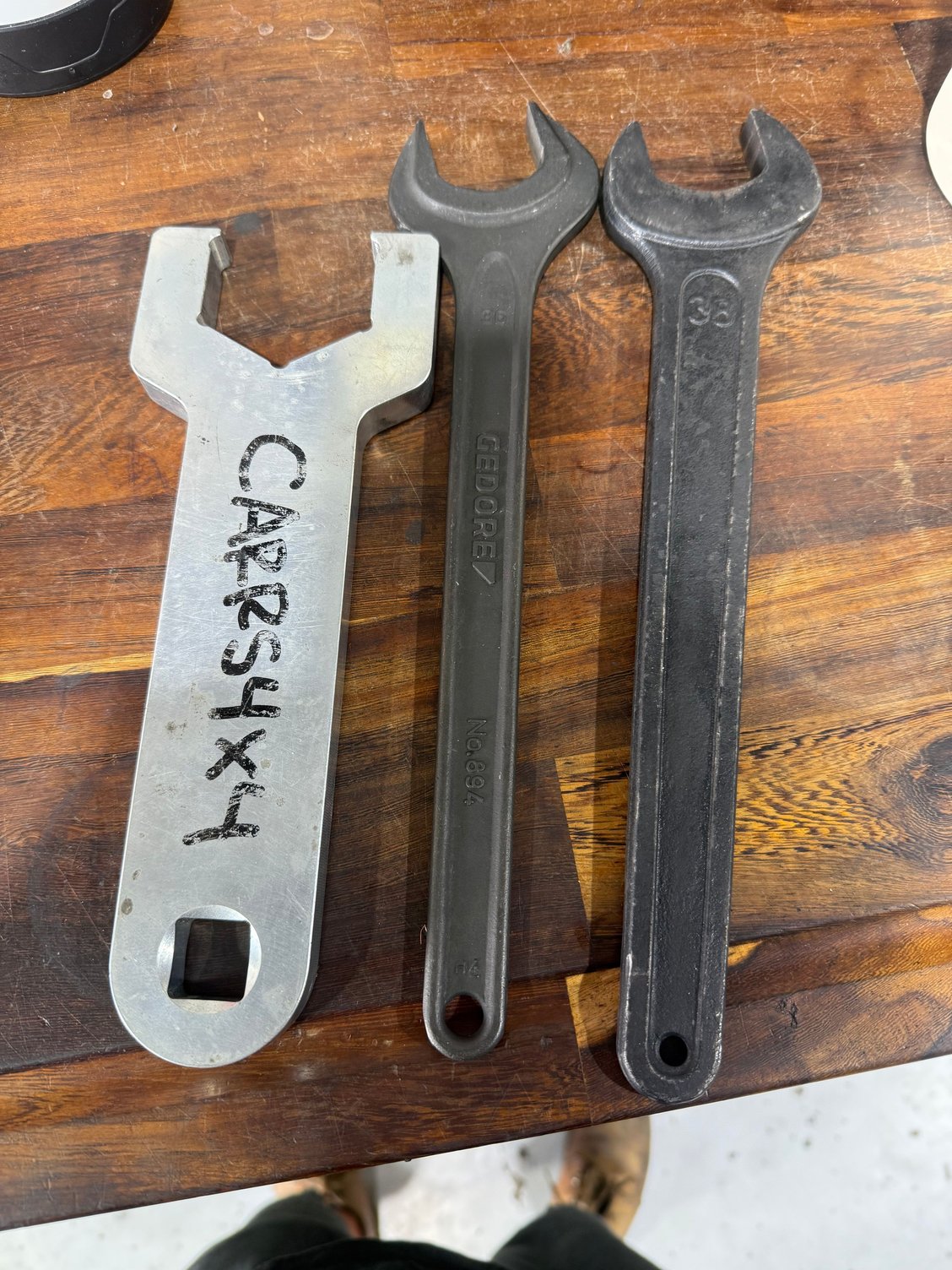

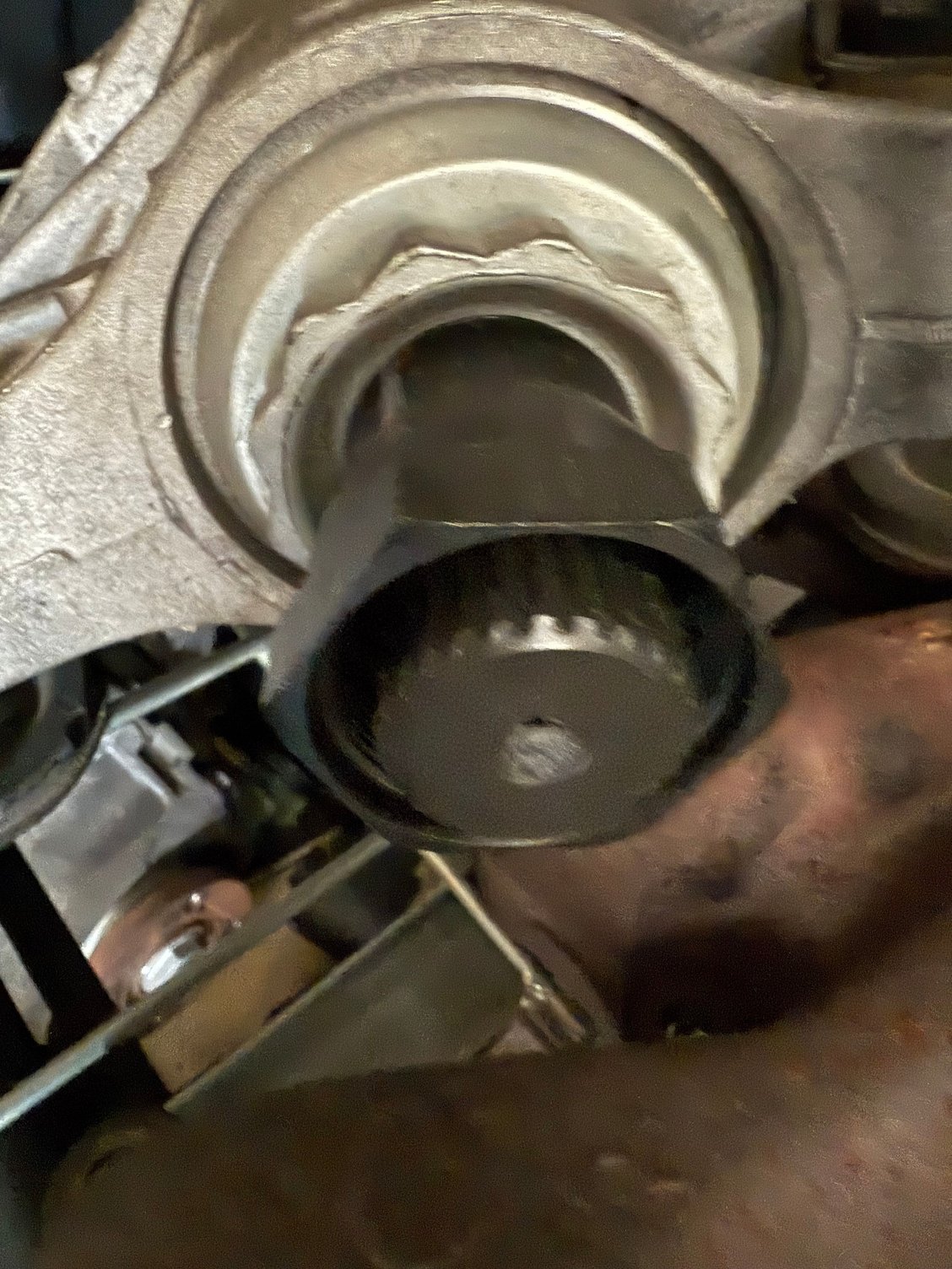

Old Aug 12, 2025 | 08:01 PM
abran's Avatar
Posts: 6,919
Likes: 794
From: Huntington Beach CA
@Chucktastic
but I'm not sure what to make of the front end where it attaches to the diff”
These are the tools needed for the front, I feel like I’ve seen 36mm and 38mm fittings on the driveshafts, that’s why I included both. Also picture of diff coupling.
