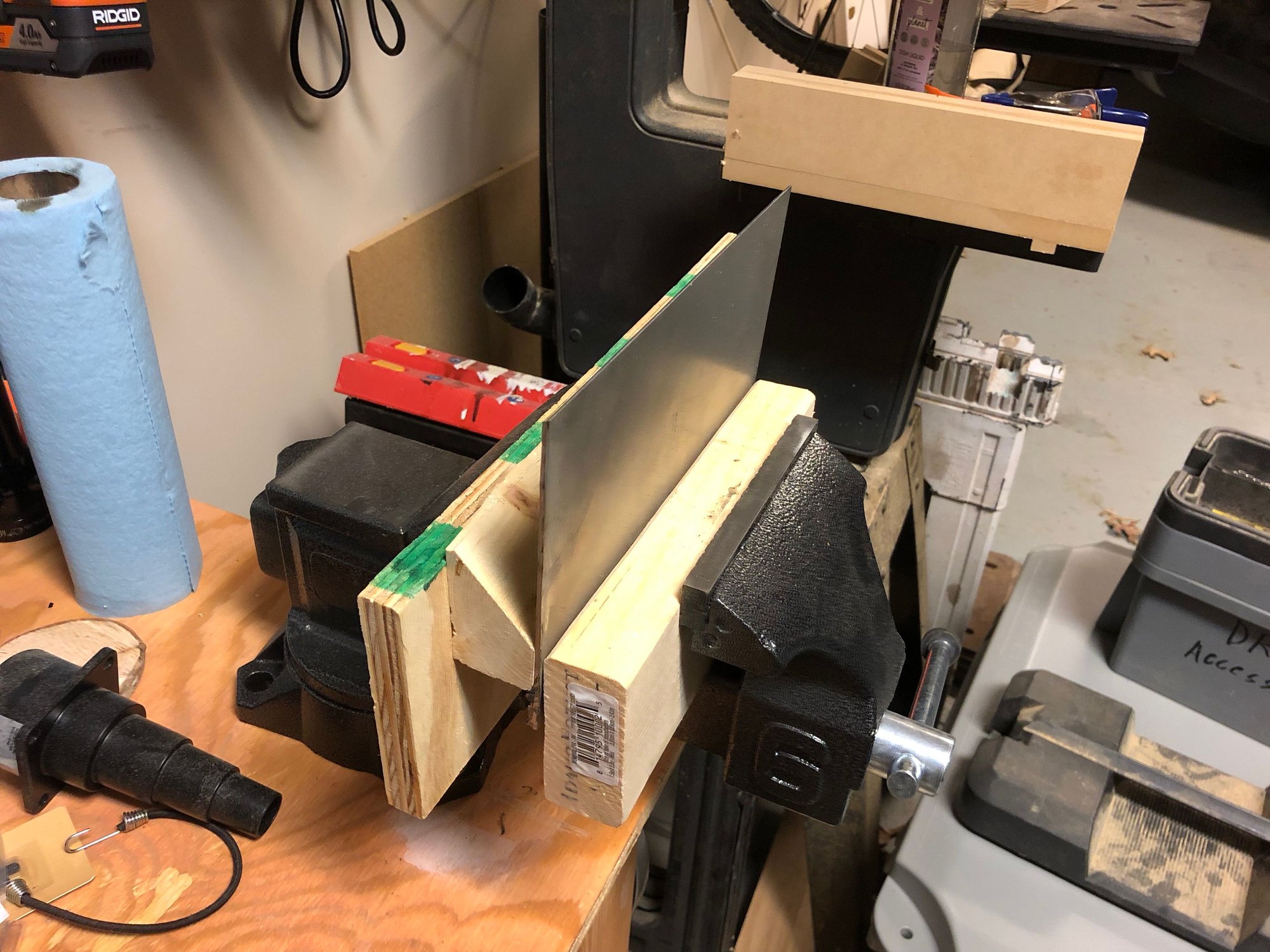

After measuring the angle underneath the seat, I bent the metal until I was happy with the bend.
