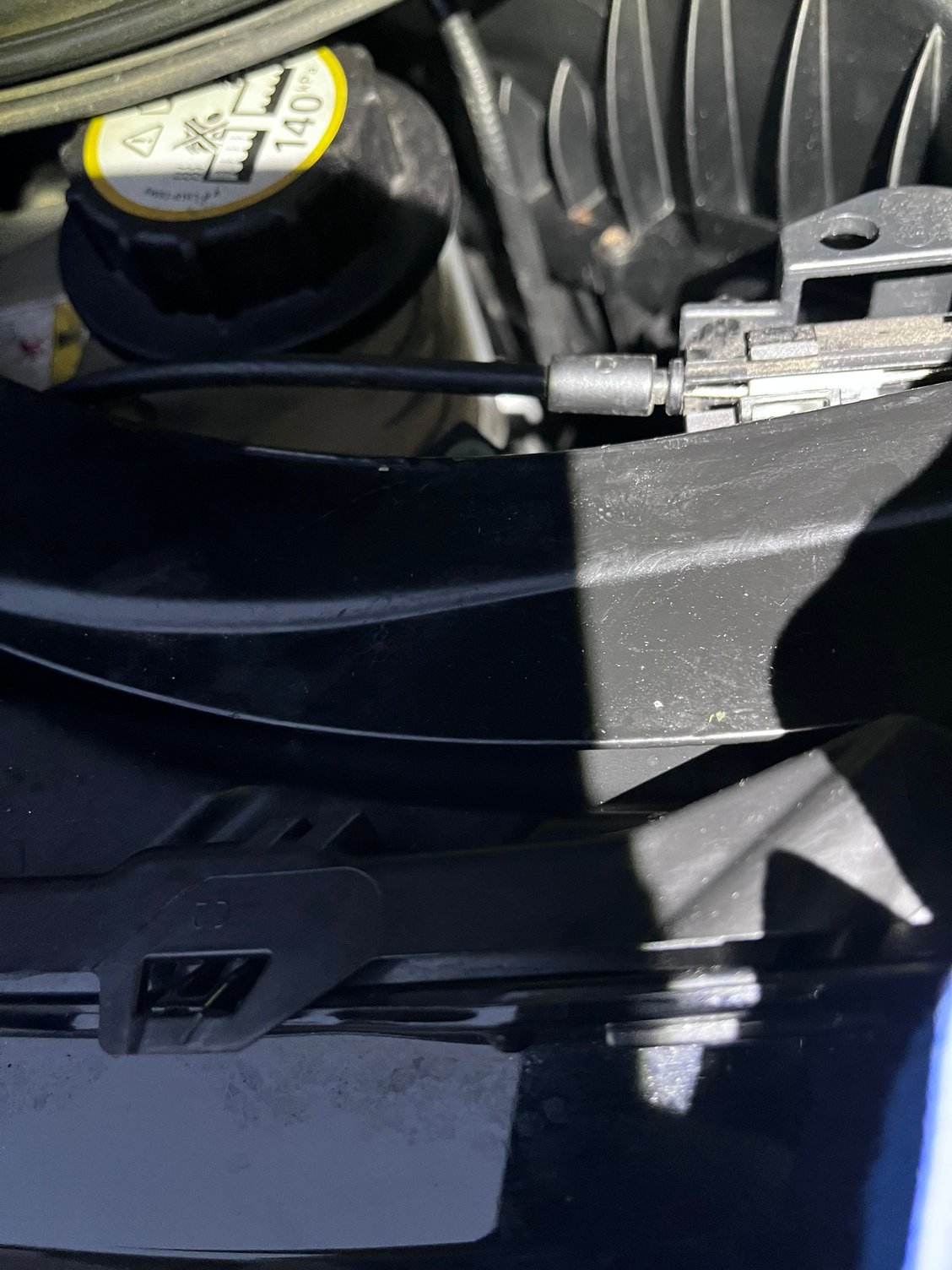

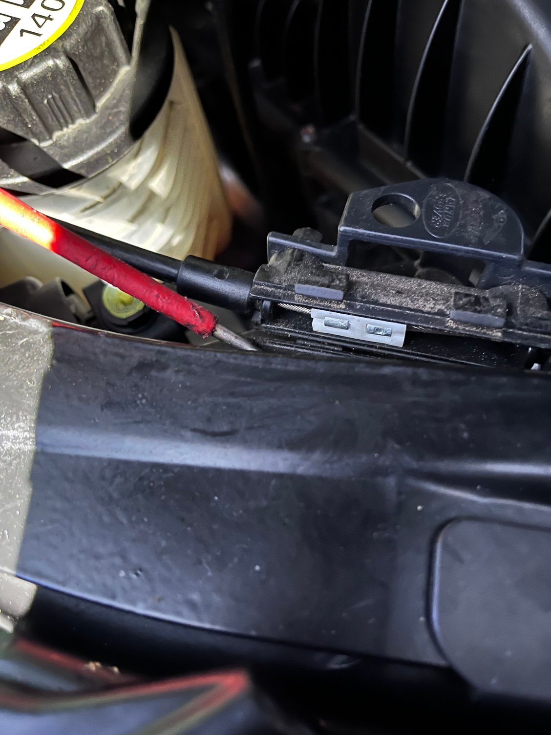

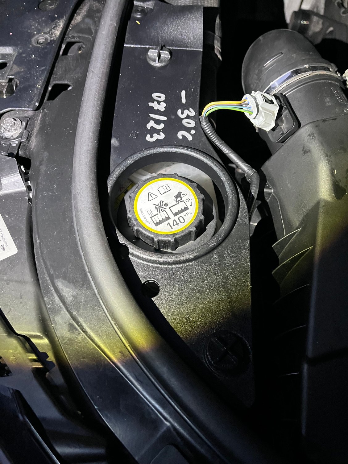

Hi,
i have already the replacement (improved) cable at home. It's not as expensive as I thought-40€. Seems to be tricky to replace it through the firewall and routing behind the Engine-ECU into the engine bay.
what I did instead was the following:
-in the neighborhood of the coolant reservoir, there's a connector between cable to the latches and interior latch
-open this connector
-latch bowdencable ending now outside of the connector (to compensate the lengthening of the inner cable)
-make sure, you close this connector housing

well done.
