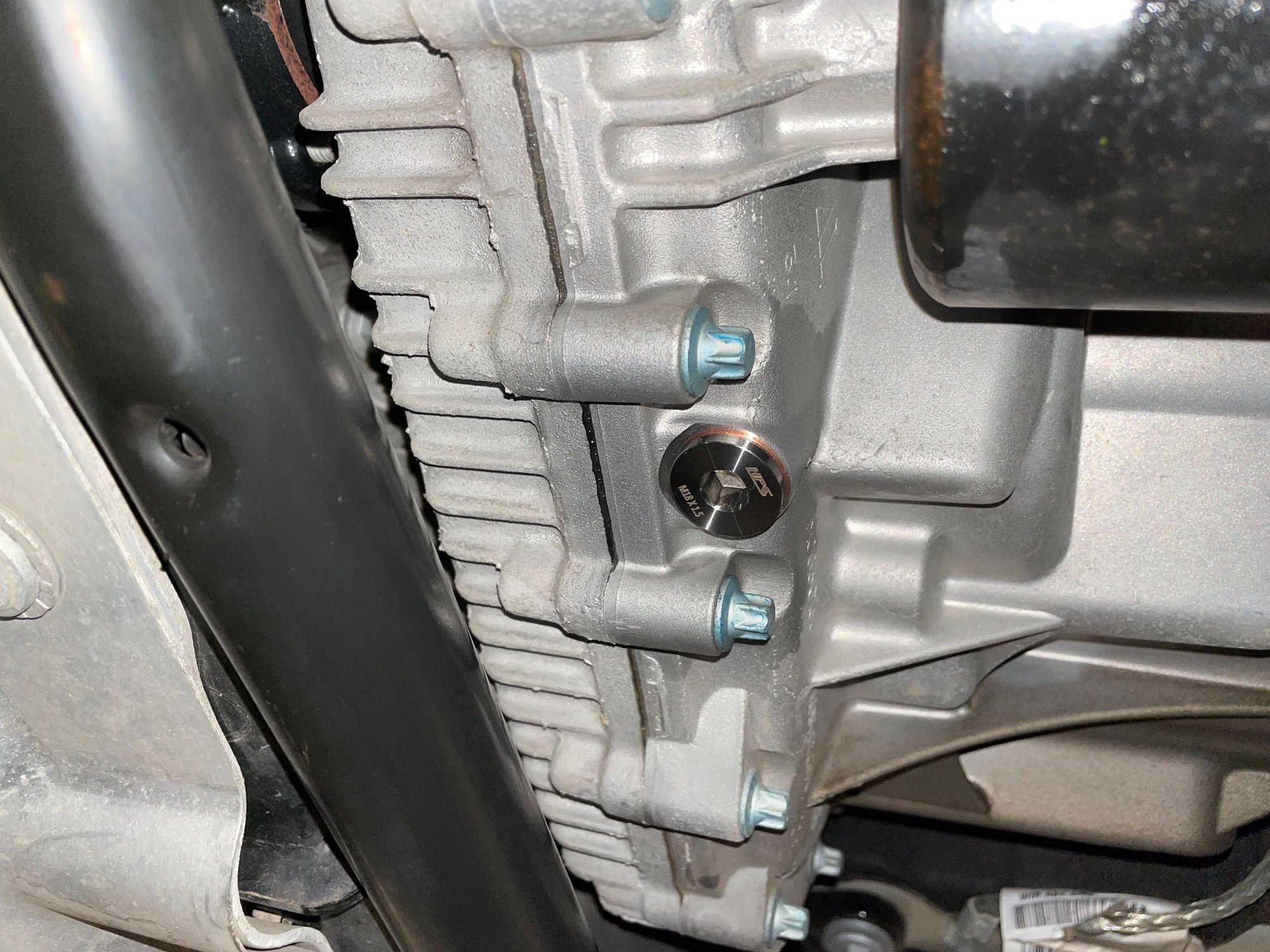

Old Jul 6, 2023 | 05:22 PM
462disco's Avatar
Joined: Jun 2022
Posts: 85
Likes: 77
I just changed my t-case fluid @ 49k miles and it was very dark. Had some clunking as well, hopefully this fixes that.
The 16mm washers I ordered did not fit, I believe the correct washer is the 18mm LR048842, but this is not confirmed.
Does anyone have a source for a magnetic transfer case drain plug? My old fluid had some metal shavings in them. Odd LR would make the diff plugs magnetic but not the transfer case...

Old Jul 31, 2023 | 05:05 PM
462disco's Avatar
Joined: Jun 2022
Posts: 85
Likes: 77
Figured out the transfer case copper washer. Fischer Plath makes one that's exactly the same - 18X22X15CU. Price is $0.29! New one on top of the OE one for comparison.
Also, ordered and fitted a magnetic drain plug to my transfer case. Thread size is M18 x 1.5
The one below is the one I purchased - well machined, and magnet is very strong.
Amazon Amazon

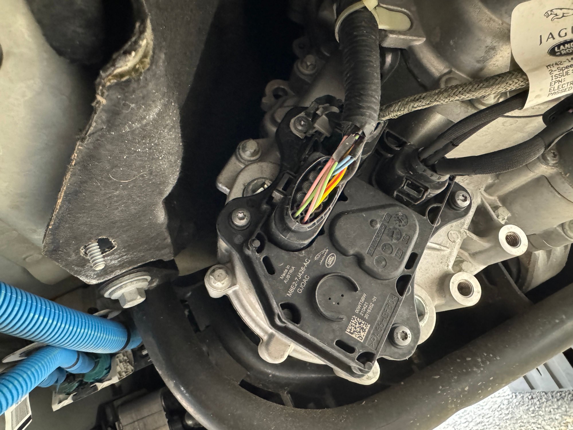

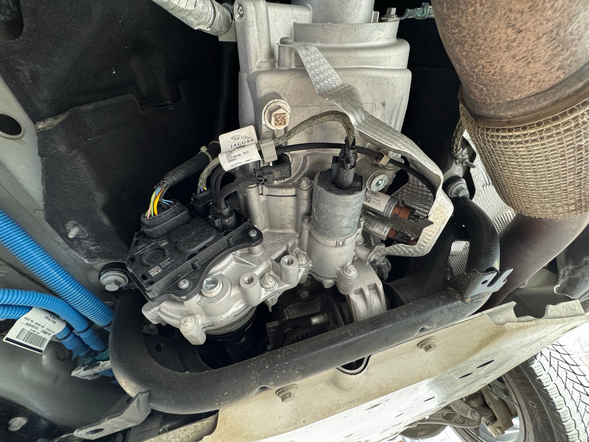

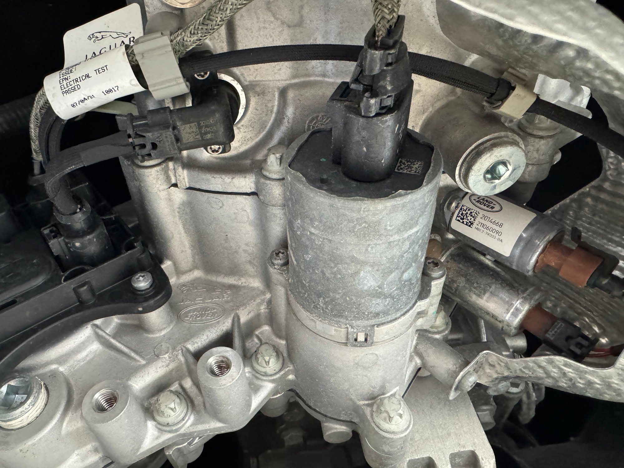

Old Nov 23, 2024 | 10:01 AM
quirozson's Avatar
Joined: Apr 2019
Posts: 33
Likes: 11
Default 2022 R Dynamic
My transfer case is different. Can anyone confirm the drain and fill points and the correct oil and amount. I purchased 2 quarts of Halbot 311 oil which I believe is correct.
