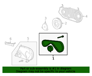

I have a 2017 HSE TDV6 with 112,000 miles. Based on the LR maintenance sheet the fuel pump belt is due for replacing (part #LR069054). Has anyone ever completed that job? Based on the videos I've seen it looks to be a difficult install with it being on the back side of the engine under the windshield cowling. Are these known to fail?

FYI, the genuine fuel pump drive belt is part #LR069054 and is ~$175 + tax and shipping from Land Rover Lake Bluff.
