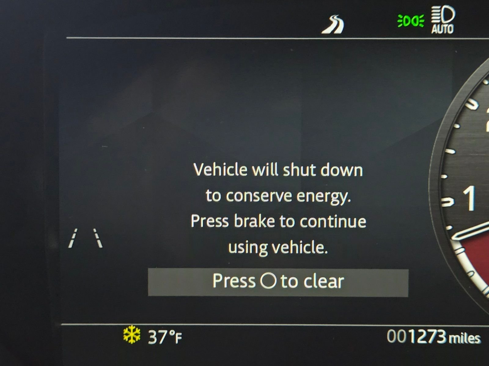

Can anyone help me out, i am trying to change two important settings in my Defender...
First: i need to be able to lock the doors when the eng is running, currently its impossible if your not in the car and that is CRAZY To me.
Second: i need the Eng to stay Idling and not auto shutdown after 30 min to save fuel..
I need both of these because i use this car for work, my dog comes with me to work so in the summer hes often in the car while i grab lumch so these its needs to be changed or i cant keep him in the car anymore.
