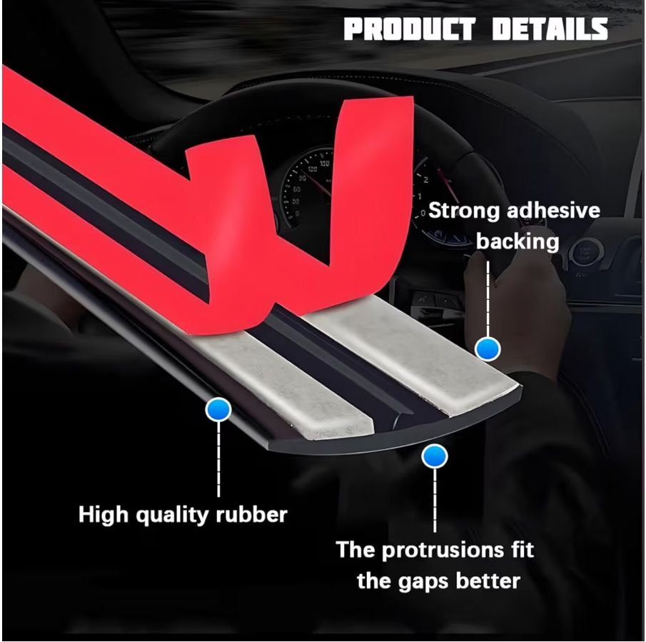

Has anyone tried the rubber seal tapes? There’s some that have a tongue in the middle that goes in the crack between the body and the windshield with a large rubber strip on the outside and adhesive of course on the bottom to stick to the body and the windshield I’m wondering if anyone has tried that and how they worked. They seem to come in two different sizes (14mm & 19mm) and of course we have to have enough length because our vehicle is over 7 feet wide. It’s not generally covered by insurance because it’s not damaged. It’s a defect. And I’m not gonna pay some kid to break my windshield because who knows what else could be damaged and if they realize that they would cancel my policy and everything and possibly seek legal ramifications.
Upside Down Cross Section
