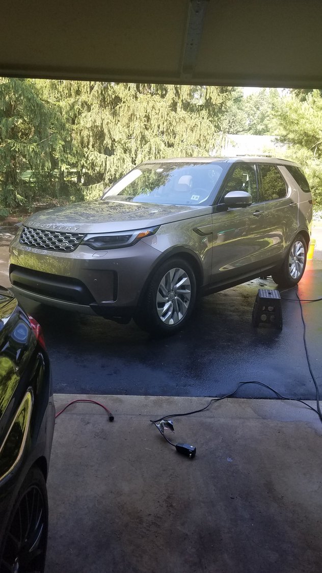

pictures below of the first wash and watching/attending a local horse show. -Matt
